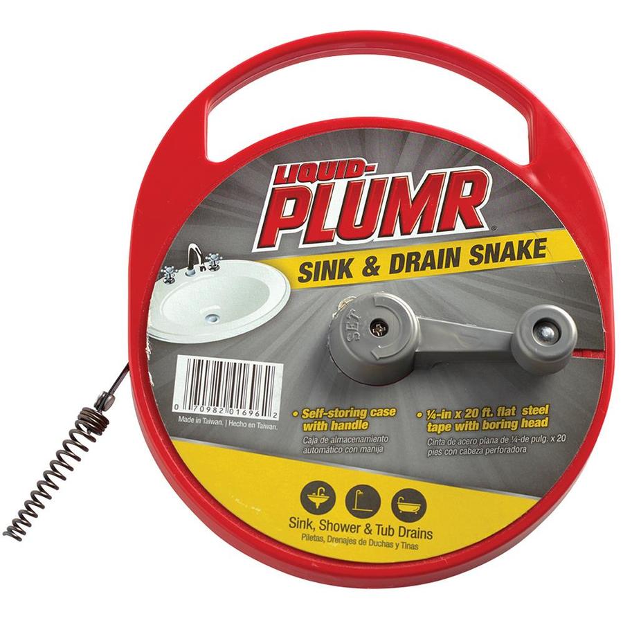

I have a very cheap fish tape on the boat that I have used for running wire. I bought a $4, 20ft, flat drain auger from the dollar store that works really well for fishing wires, I have not tried it as a drain auger. It would be great for running lines through a boom.

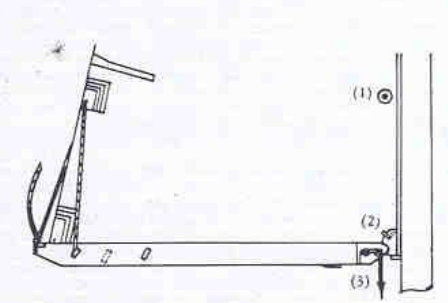

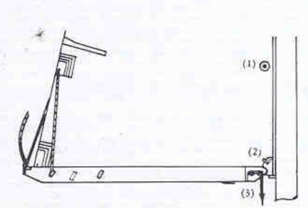

From the Hunter 28.5 manual below, hopefully the reefing line goes through the boom over sheaves at both ends WITHOUT going through a block.
