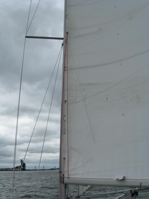

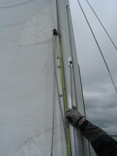

When out sailing this weekend and measured the reef points. The factory first reef is 5' deep, and the second is 6' deep. Based on 0.5*P*E full main area is 242 sq. ft. The first reef is about 80%, the second about 60% (assumes reduction of 1' along the foot for each reef).
