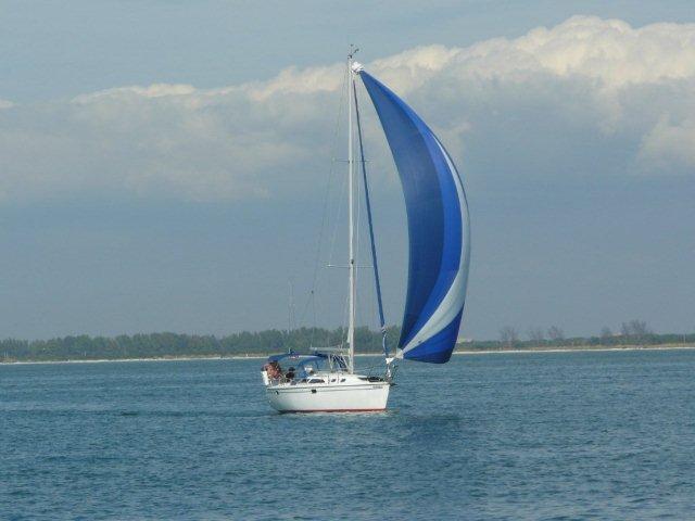

With the loose foot you can adjust the shape of the sail for optimal performance. Yesterday we were in about 16 to 20 kts of wind with a furled main about 60% sail and the 125 jib and were cruising at between 6.7 and 7.2 kts with the wind between 50 and 60 degrees on the port side. Had a great time. The day before we were on a beam reach in 6 to 10 kts of wind with the cruising chute
