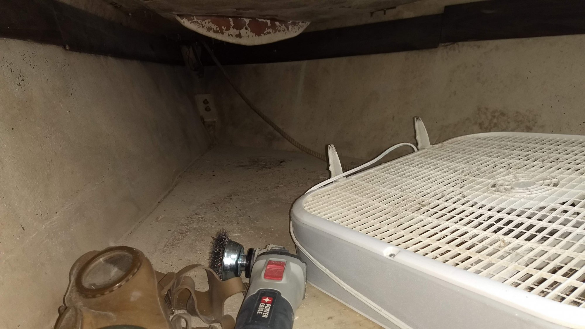

I have a mac22 that I'm redoing, someone already started wire brushing the ceiling inside, I did it again with a wire brush angle grinder attachment and got a lot of lose paint or whatever off, I did plan on just painting it a simple bright white, all of the cabin. Then I found a typical boat "ceiling carpet" that is like a very light cotton batting that should be very easy to put up, and cheap too. Something like this should hide a multitude of sins...IMG_20200619_174827198.jpg

Wow,thanks for the pics.,looks like you got your hands full ! would you send me a pic of it when you're finished ? I am in Puerto Vallarta,mx & am not sure that i'd be able to find the material,what size are the tile squares that you plan on using ? Good luck with your project

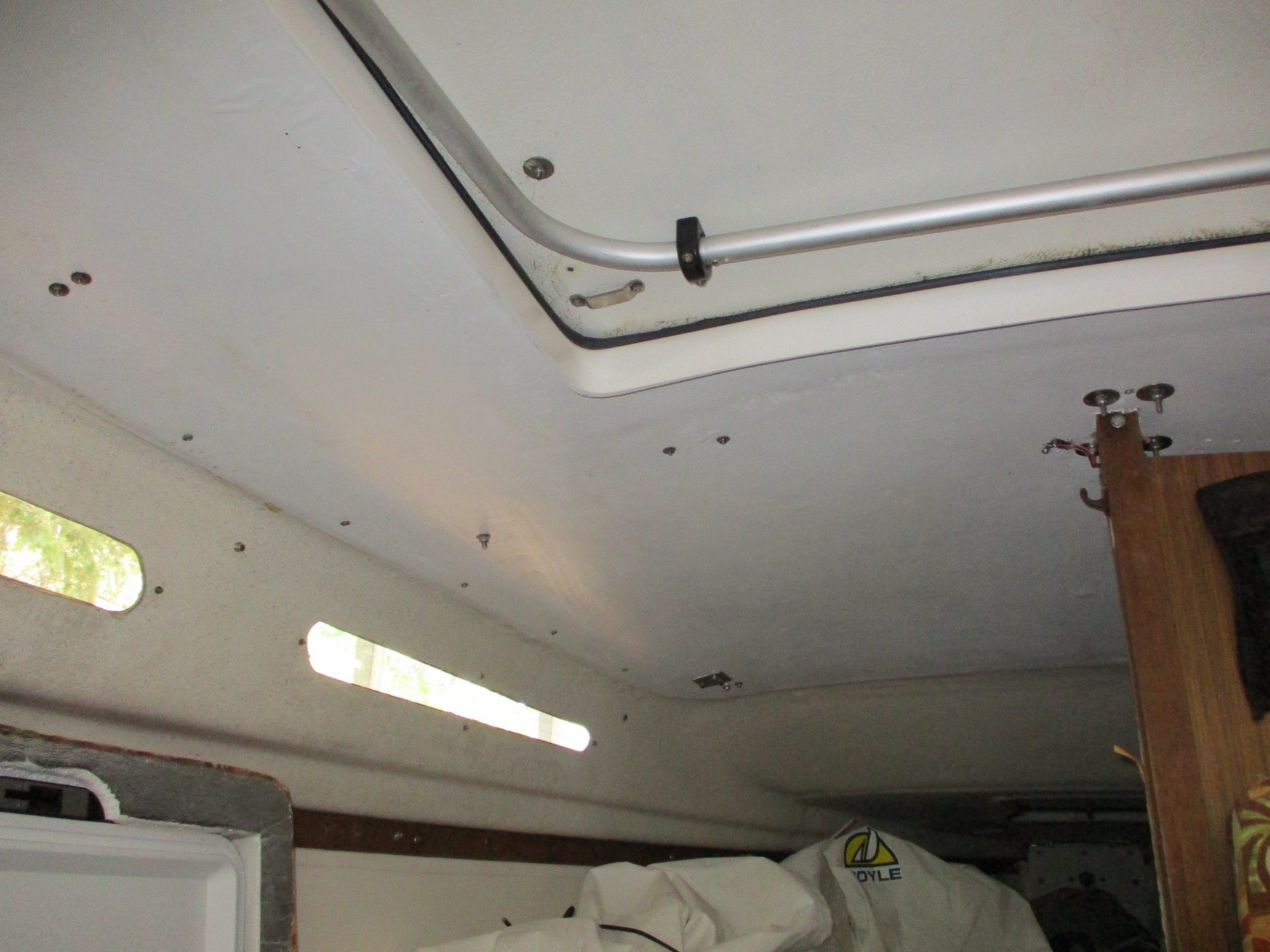

Just did the same thing to our M25 a couple months ago. I did some course sanding to remove the carpet debris, but it came off relatively easily. I think key to painting it is to remove ALL hardware/nuts and bolts etc. a few had to be masked, but whatever you do, don't paint over them :yikes:. also recommend using a semi-gloss or satin paint, as that helps hide irregularities.

Thanks for for the reply & the pic, your roof looks about a thousand times better than mine & painting it is probably an easier & less expensive route to take but i was worried about mould forming on the paint because my boat is kept on a mooring in a really humid climate in Mexico & is unattended sometimes for a week or two at a time. I tried one of the rv solar/battery powered vent fans but it only lasted about 2 months & i'm reading bad reviews on them now. Do you think that you'll have mould problems on yours ? Thanks again !
