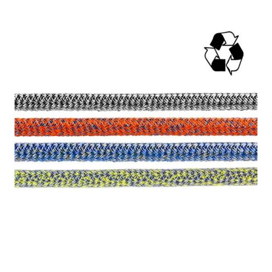

I need a new jib halyard. What do you all think of these recycled from plastic lines at Mauripro? I'm no tree-hugger but I try to be responsible when it makes sense.
The Eco Cruiser is the shining result of our continuous development efforts combined with our sustainability goals. This rope is completely made from recycled plastics. An all-round braided rope from rPet yarns. It is a complete and balanced rope and can, therefore, be used for various applications. For example, halyards and sheets, but in the thinner diameters also extremely suitable as a trim line.

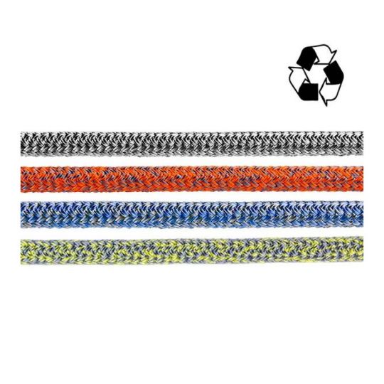

They spelled "Strech " wrong :biggrin: but it says low. Shows it's for halyards. I agree with 3/8".
And they have colors:
