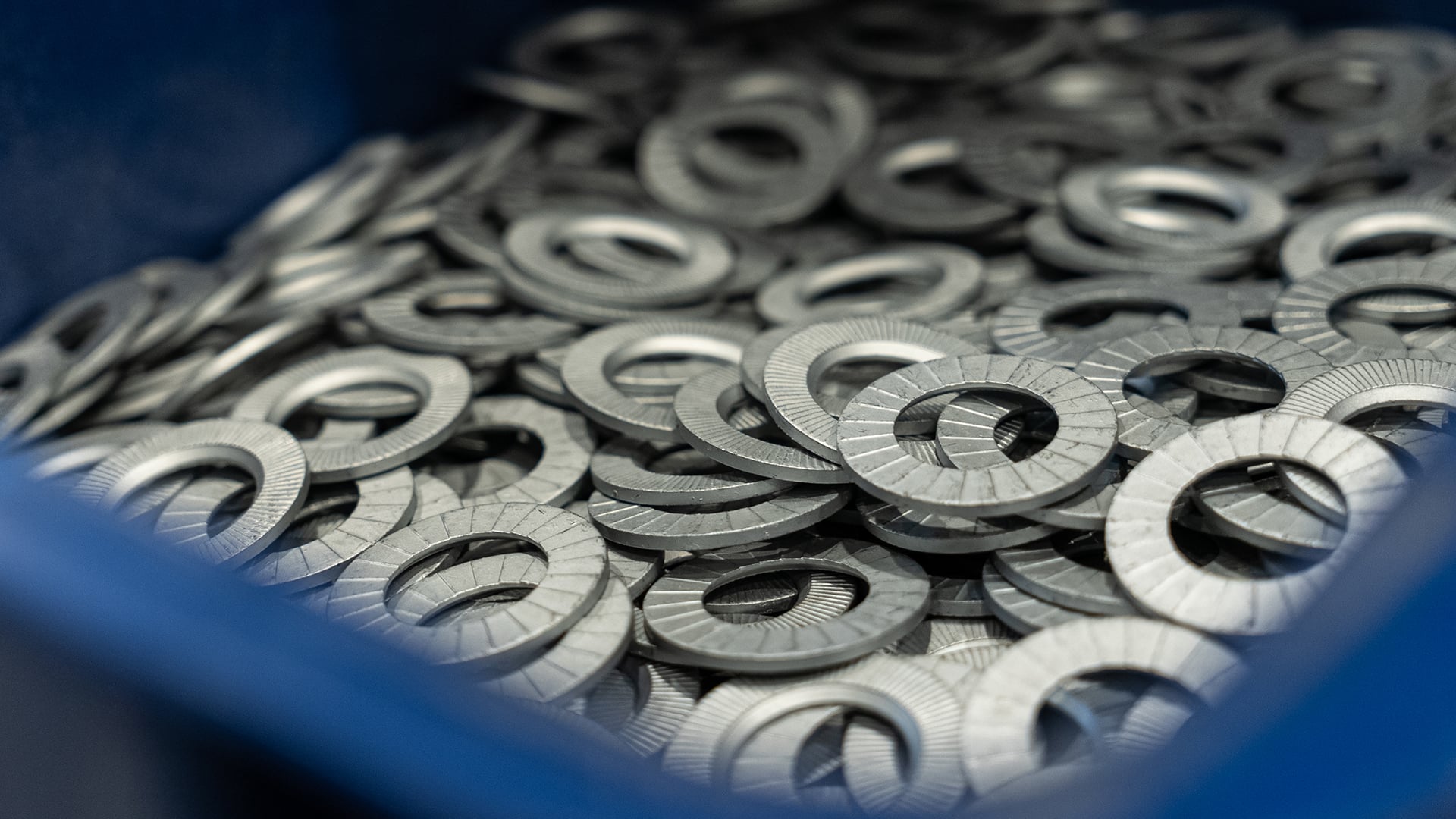

I was exploring methods today and came across the “Nord-Lock” washer. This was a new discovery for me. It appears to be an idea that meets the functional requirements of bolt on keels.
What are your thoughts?

I can't seem to get into any section where they give specifics on the materials they are made from. I've used these in the past, but in high vibration applications. I don't think I'd want them on my keel bolts. It would just be an added complexity in a location that doesn't need it.
Is this it?
Five different materials - steel, stainless steel, 254 SMO, alloy 718 and alloy C-276

Yeah I saw that. Obviously steel would probably not be a good choice, however, I don't know what steel they are using - couldn't find that. Then they list stainless steel - well there are hundreds of those, which one or ones do they offer? Couldn't find that info.
The other three are excellent alloys to be used but I bet they are at a price level that would cause a rather significant pucker factor... Any of those would certainly work but why would you need them? The 254 is a super austenitic, nice but really? Then the other two are nickel based alloys. I quite like them but again - for a washer on a keel bolt?
These washers are designed for very severe service, way beyond what a keel bolt needs...

Wouldn't a second nut be simpler? No reason to back the existing nut off, and very secure even if the load cycles outside the acceptable range for a lock washer (they only function within a limited range of pre-load).
