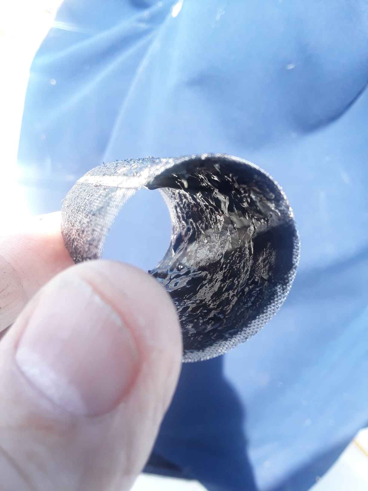

Thanks Peggy! If you don't believe it, this is what the prefilter for my freshwater pump looked like when I bought Bella:

When I first bought Papillon a quarter of a century ago, all of the water lines were black with crud. I looked at the process of replacing them but they went into dark places which I could not find a way to enter. I removed the hoses from their connections at each end and used a vacuum to pull a length of construction string through that was 2.5x the length of the hose. I then tied a tampon string to the center of the pull string, soaked it in full strength bleach (5%) and pulled it back and forth through the hose. When the tampon got too gross, I would replace with a new one. After 3-4 tampons they stayed clean, and the hoses were clear again.
After that, the system has been recommissioned as described by Peggy every year and the problem has never returned.

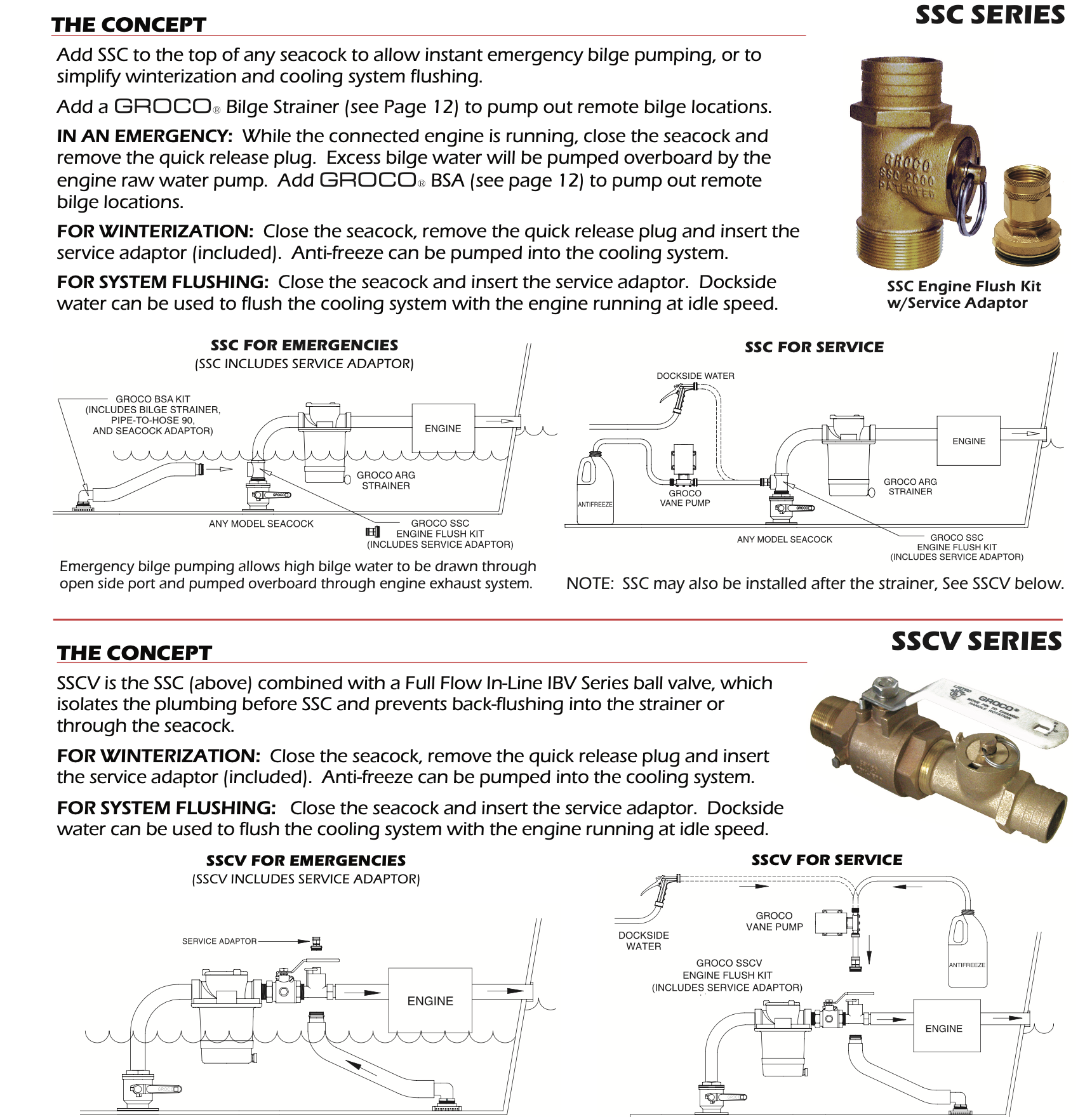

If you have space to install one of these parts from Groco...
Good for many things
Jim...
