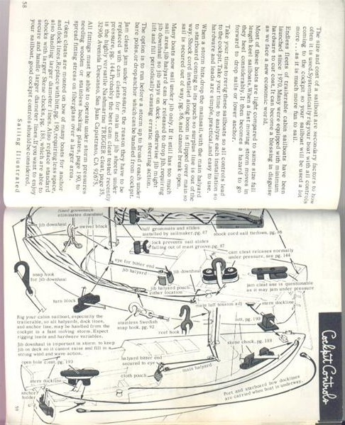

While this is for a C22, the safety ideas are useful for all trailerable small boats.

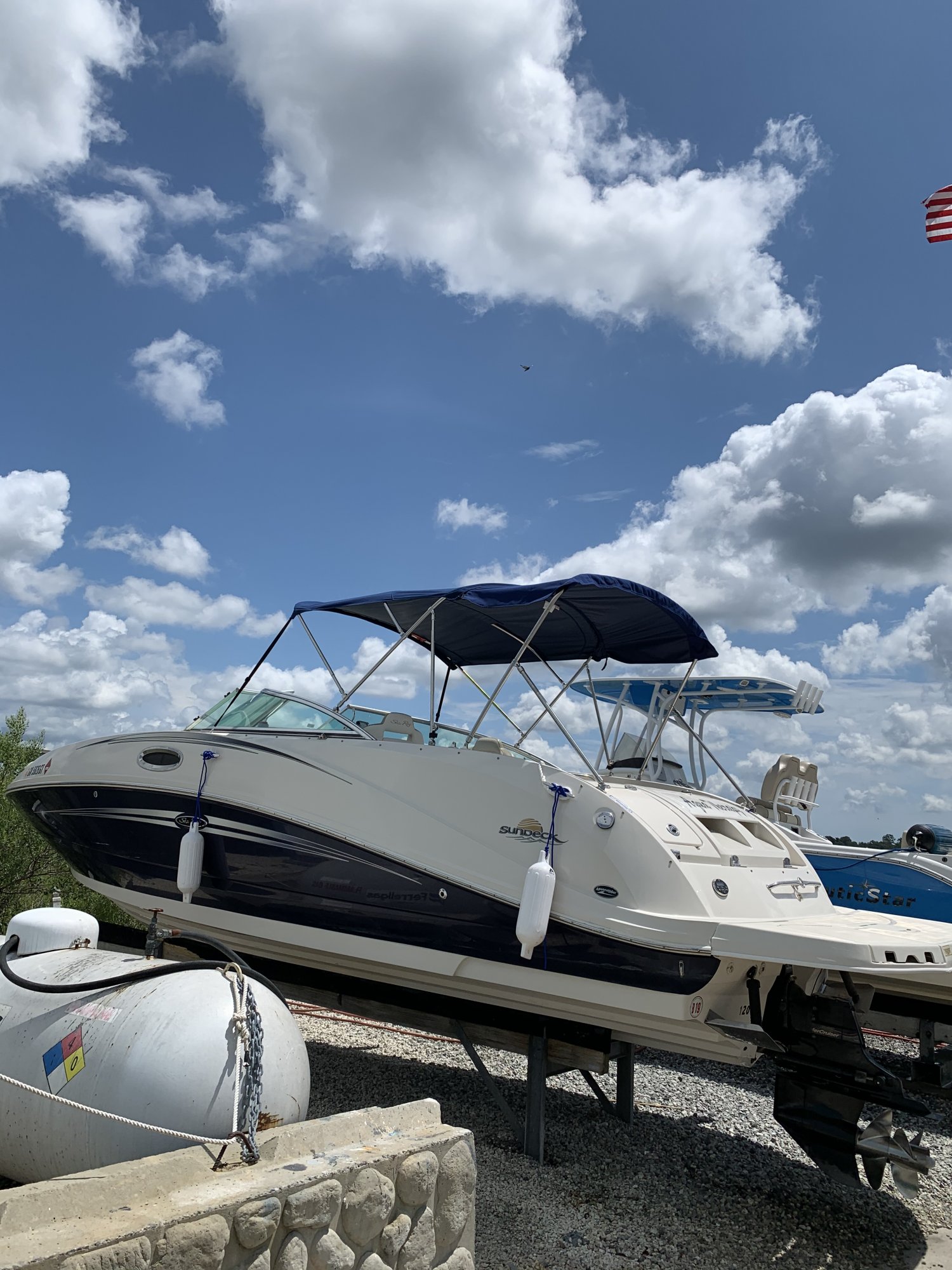

If you are up for making your own, Sailrite.com has instructions and the material for a Bimini.
A simple boom tent will also work at anchor but not while sailing. Shading the boat will make it much cooler and more comfortable. Also provides protection in light rain.

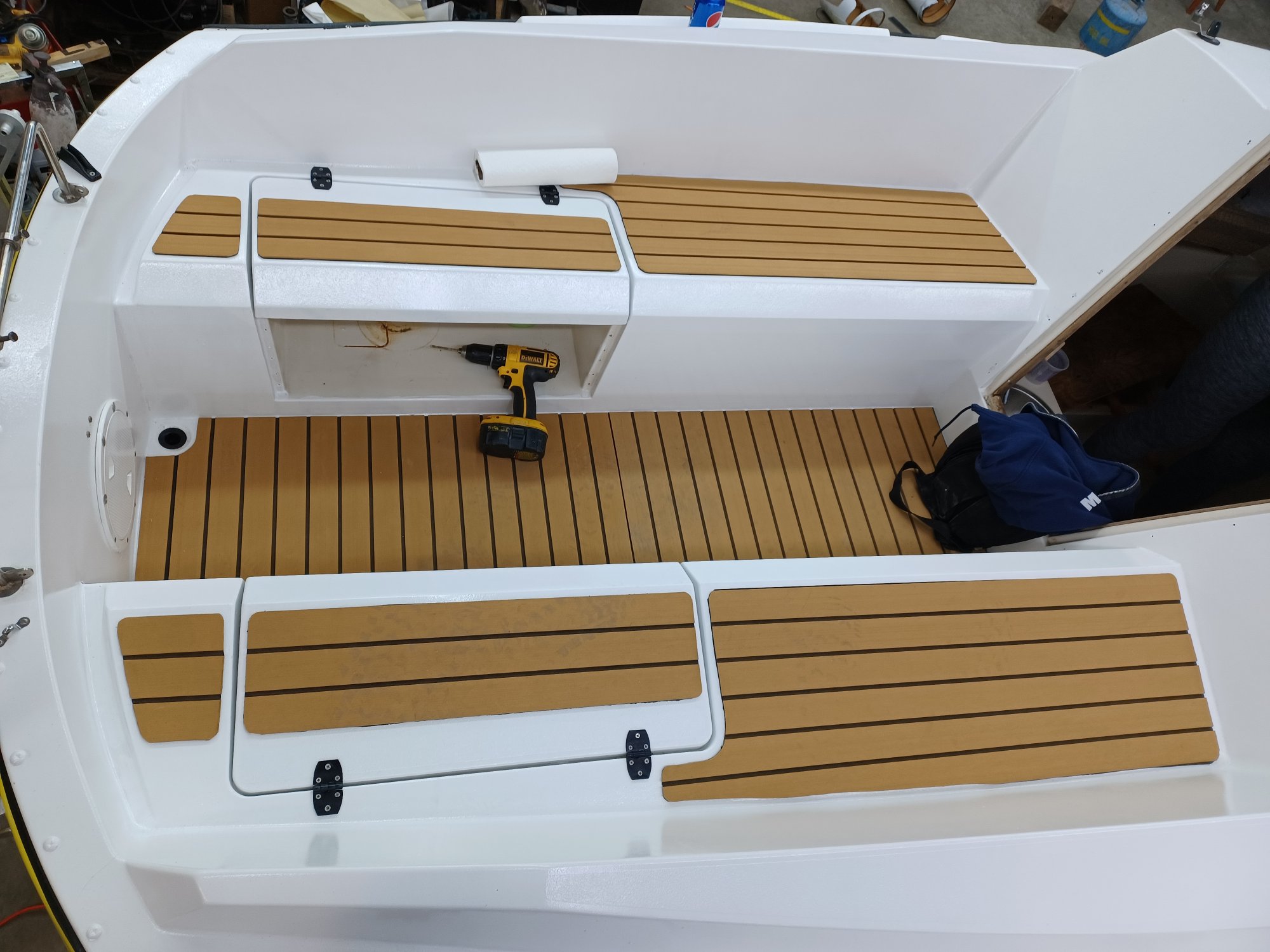

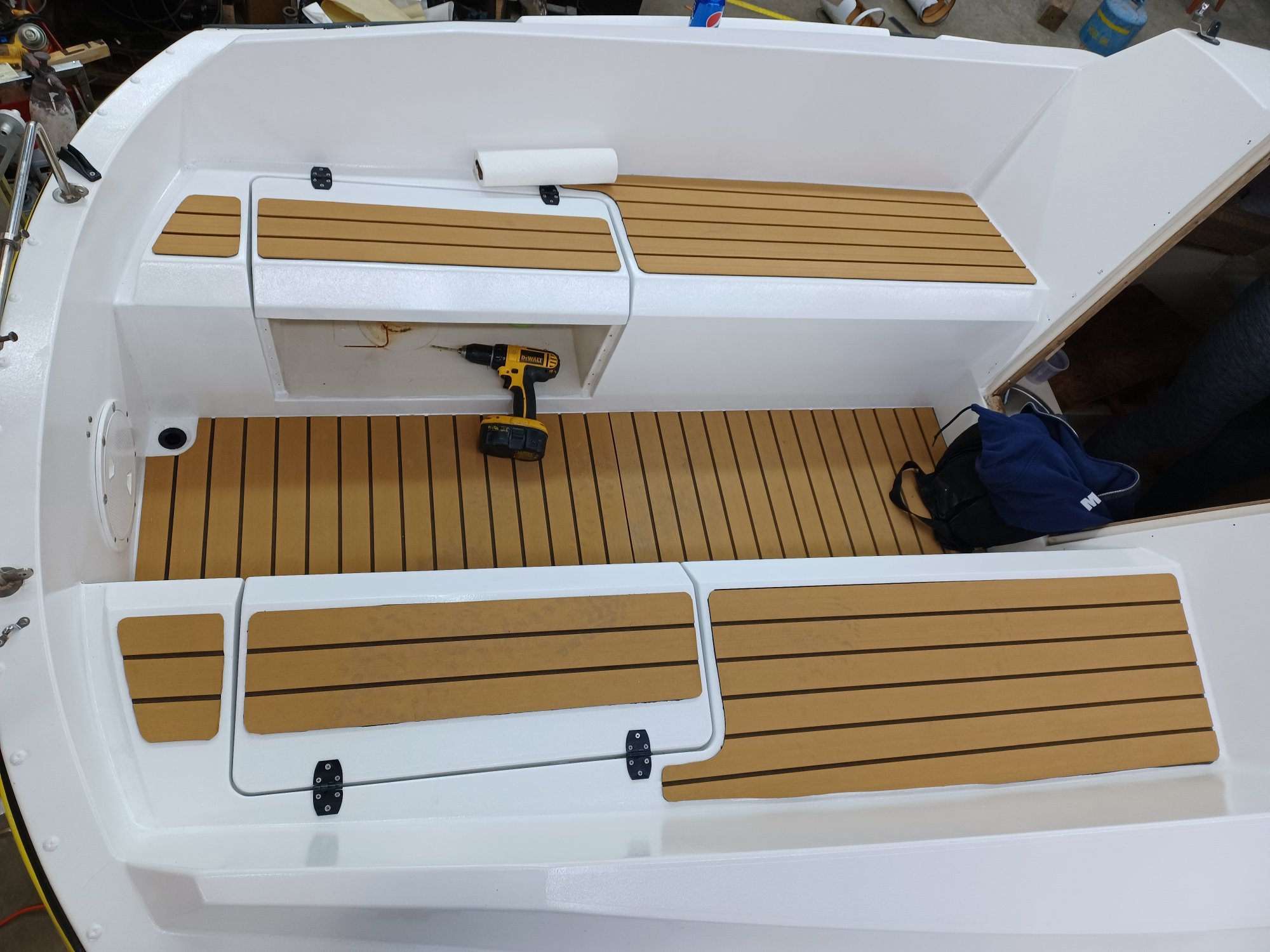

It's all about how you spend your money. I only spent about $500-600 start to finish on this project. It took about 2 weeks of evenings. Started out with the side busted below the rubrail for 3 feet, rotten everything in the interior. Gutted it. Cut new plywood. Cleaned everything. Glassed up the damage. Relocated the cockpit drains. Obviously I painted the whole boat. Replaced the rubrail. Replaced the running rigging. Redid the brightwork. Bottom job. Fun little boat. I have more pics and details if you have questions.

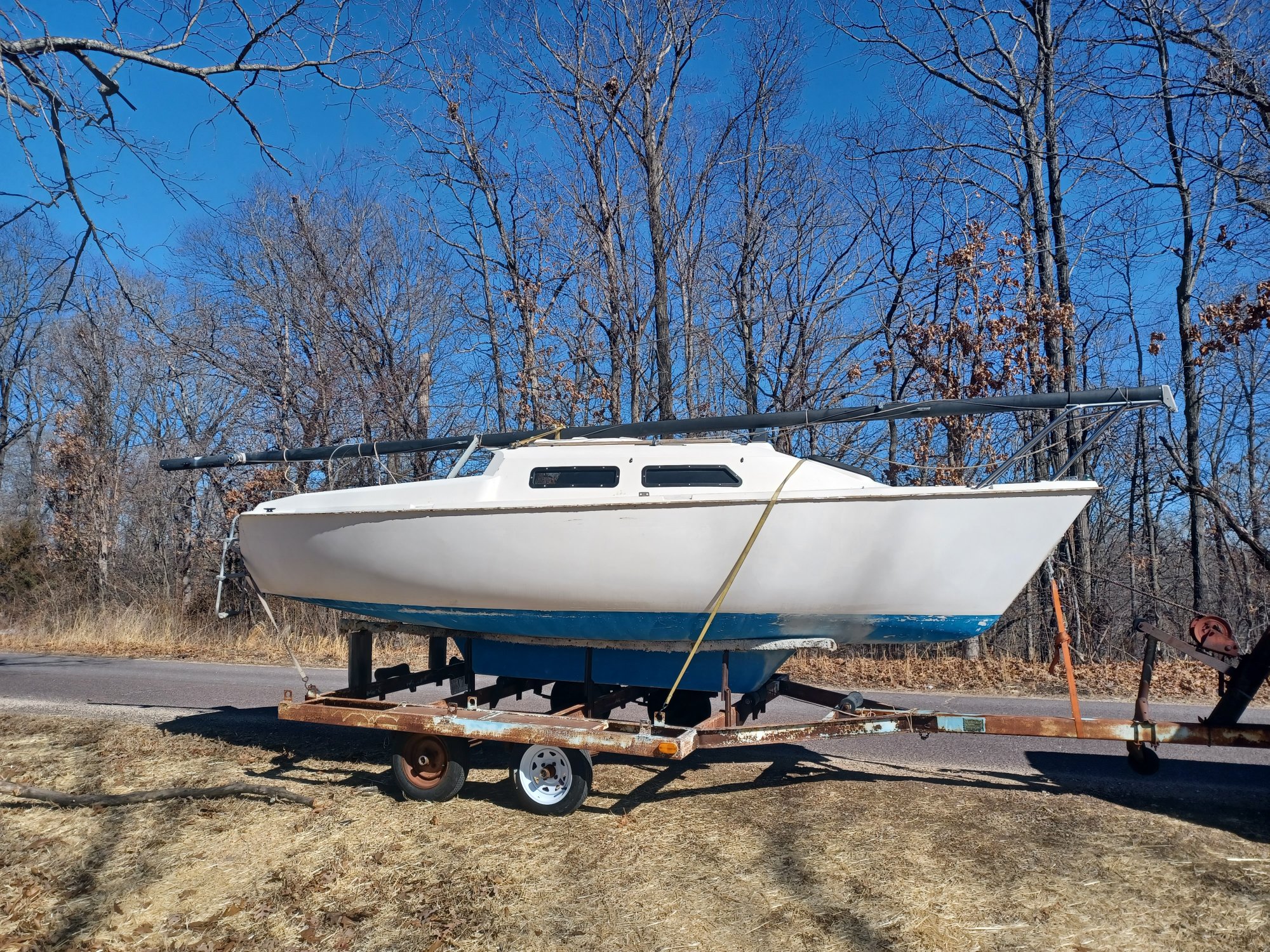

Starwind 190 Minnetonka
This is an old thread but it's a great starting place for me......I picked up an 1986 Starwind last fall for next to nothing and I've been busy fixing what sounds like are the usual issues: cockpit drains, windows, gelcoat cracks/de-lamination, etc. Looking forward to making some of these same upgrades! Great info!!
