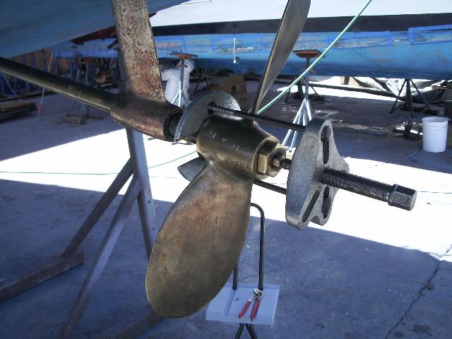

If you scroll down this thread, you will find my homemade tool including dimensions that I have used multiple times to change my cutless bearing. Once made, you have it forever.

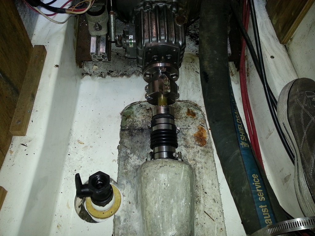

$900 would be just the incentive I need to try it myself first. After all, it isn't going to damage anything by trying. I installed my own dripless packing and a split coupling as well. The new packing materials that are available may eliminate the need for the dripless system, which would save you the need to realign (and more difficult, removing that half of the coupling from the shaft).

Allen thanks for sharing your great design. ( no wonder you made the cover on Yachting, that one tool design alone rates it :clap: . ) What did you use to remove the prop? Not sure what collet and flange arrangement is used to install the new bearing. It looks like the non split collet would slide through the over sized hole on the puller flange?
All it took was $10.00 and a trip to Universal Studios to get on the cover of Yachting Magazine. They supplied the wheel to hold and the hat.:biggrin:
I used a steering wheel puller with my slotted pusher and some longer bolts. Your results may vary. One of my friend's prop was on too tight to get it free. Luckily the guy in the yard next to us had a proper prop puller that he loaned us to break it loose. But, mine has always come off after tightening it up a bit then just a light tap on the side of the prop with a piece of wood. You are right about the collet (either the split one or the whole one) slipping through the pull through flange. That's why I ended up with a spare flange with the smaller hole in it. It doesn't even have to have the slot because it just needs to go over the end of the prop shaft to drive the new cutless back in. My original trial piece works for that purpose, but I should make a new one based on a heavy duty pipe flange, like the others.
