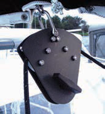

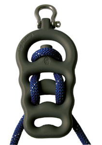

As far as breaks, Wichard makes one. These require additional lines around the boom and to the deck. An added complexity.
The DutchBoomBrake is more complex...
but uses the same basic principle, to tie the boom to one side or the other, with a line that uses friction should the boom suddenly swing.
Both require an extra step by crew to release the boom break should the boat want to tack/gybe.
When I intentionally gybe, I prevent the wild boom swing by pulling in the boom to the center of the boat then adjusting the helm to cause the gybe.
