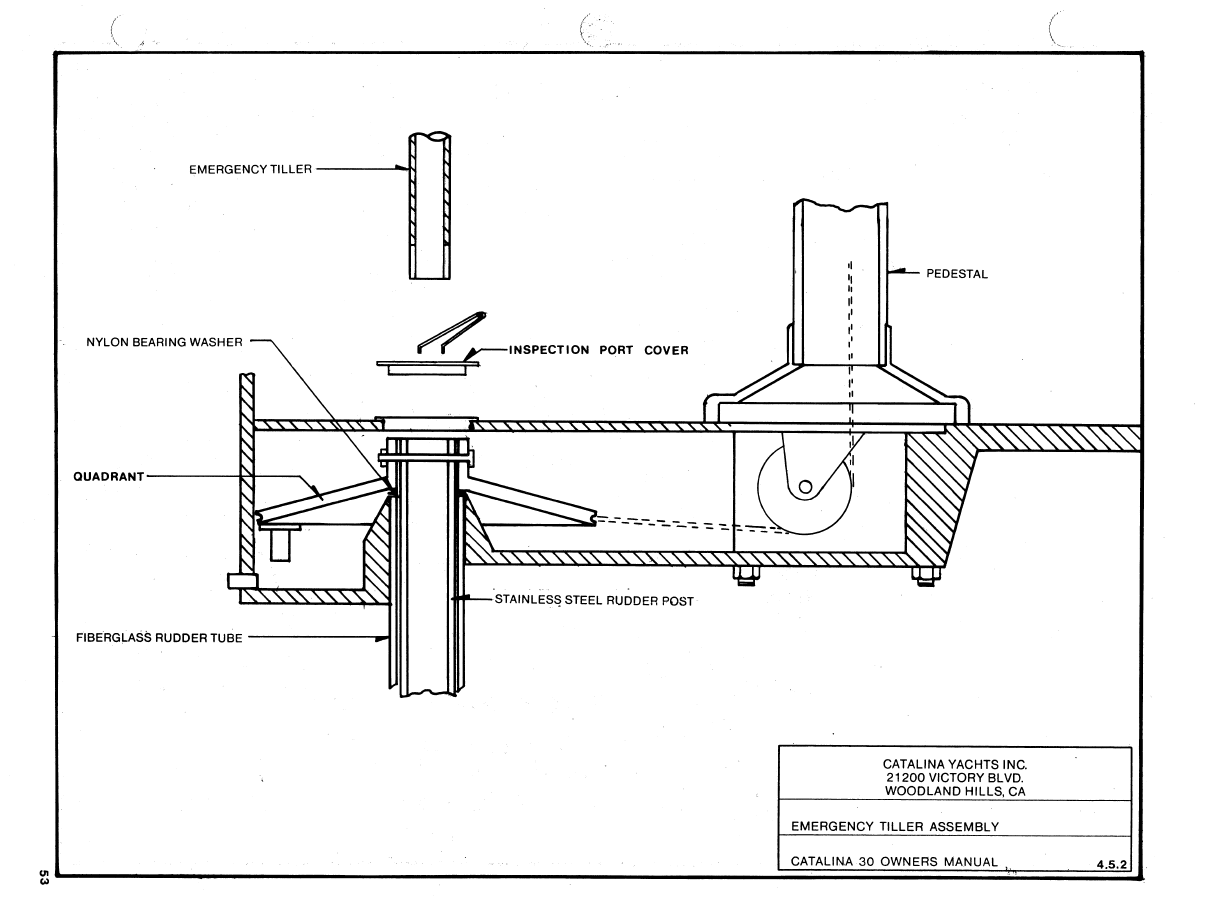

The OP asked about an auto pilot for a Catalina 30 mk2 which is listed as 10,600 lbs displacement but most are closer to the 15,000 limit. On this boat, there is no possibility of installing a below deck pilot becasue the steering is in a tiny well in the cockpit sole that is just big enough for the steering radial and nothing else.

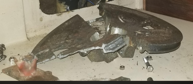

I have seen this article before and the key component is not Simrad, it is the Octopus Marine RS cable drive unit which can be connected to any control head. It looks interesting but their statement that the cable has an expected life of 200 hours is rather off-putting. It would also require drilling into and mounting to the cast aluminum radial and I have heard of other C30's having radial failure just under cable loads in a storm and the mounting post would add a lot of additional forces to it. Edson says that you should never mount an AP to the radial and there is no shaft exposed on a C30 to mount a tiller arm. Makes me nervous.
(Note: photo not mine and ripped from different site. Thanks to TJL)

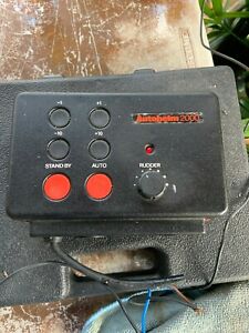

Might have you beat. My Autohelm 2000 (not ST) works like a champ in calm, light winds or well balanced sails. I need something for the difficult times not for the easy times.
