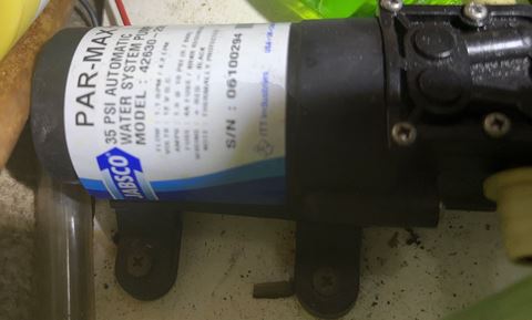

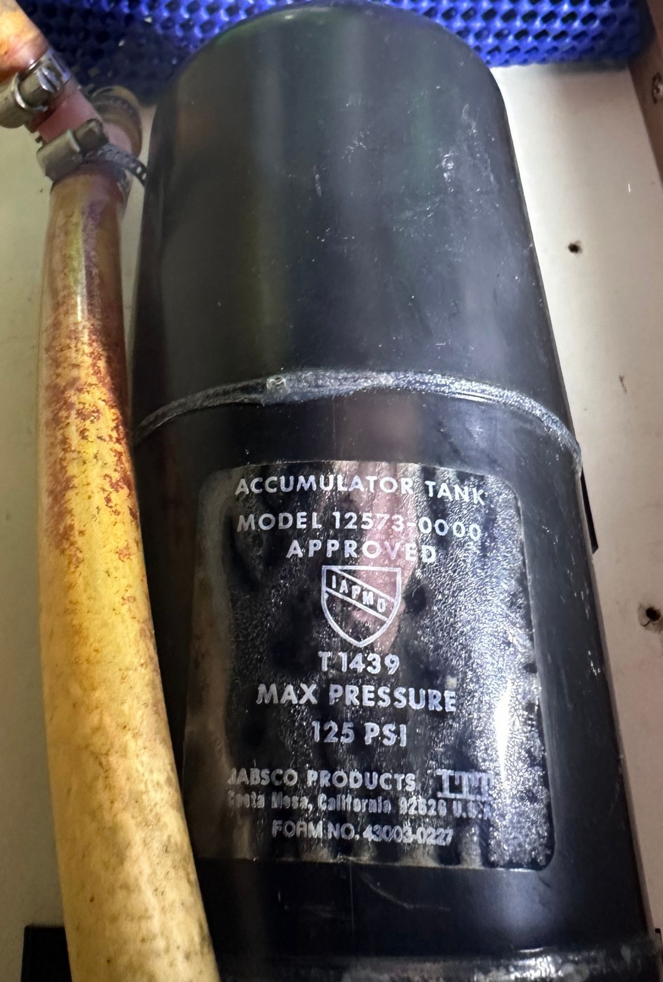

Here's what I found. One ancient looking accumulator tank and one Jabsco automatic pump. Both are disconnected. I'm guessing that I did that when I replaced a bulkhead so it was winterized for two years at most. Zero chance of saving the line next to the tank, that's for sure. I'm hoping I can use the pump. I assume the accumulator tank eliminates water hammer and low pressure when the faucet is first turned on?

If the accumulator works, it stores some pressure so the pump cycles less.
I have one on my O’Day 322, it does flow a little water before the pump kicks on… maybe improves pressure at the very start.
There is a bladder in the tank, and you can normally adjust the pressure (should be an air valve somewhere).
Greg
14,024
At the top of the tank there should be a Schrader Valve like the one on a bicycle tire. The allows pressure to be adjusted in the bladder.
An accumulator tank is not necessary if the pump has a pressure valve. I got rid of the tank on my boat, it wasn't necessary and took up space in a cabinet.

It it has a switch to automatically turn the pump on and off at the specified outlet pressure but does not look like it has a pressure relief valve. What's the likely hood of being able to use these components after sitting for so long?
14,024
The pump pressure is relatively low and the hose diameter small, so over pressure is not much of an issue. These pumps are basically fancy diaphragm pumps, if it gets over pressure I suspect the diaphragm will split and while the pump will run it won't push and water. The water in the hoses would drain out the pump and that would be it.
A long term layup with AF may have affected the rubber in the diaphragm. The only way to check is to put some water in the tank and turn on the pump. If it leaks then it's time for a new pump. Some pump models can be rebuilt, some not. However, the cost difference between the rebuild kit and a new pump is not that much. I'd be inclined to just replace the pump and ditch the accumulator.
Thanks Dave! Hopefully the pump is still in good working order. I'm afraid of what might be growing on the inside of that vintage accumulator. Yes, I know a shock treatment should get rid of everything
14,024
Well, you could shock it more than once to be certain. Shock, rinse, repeat.
