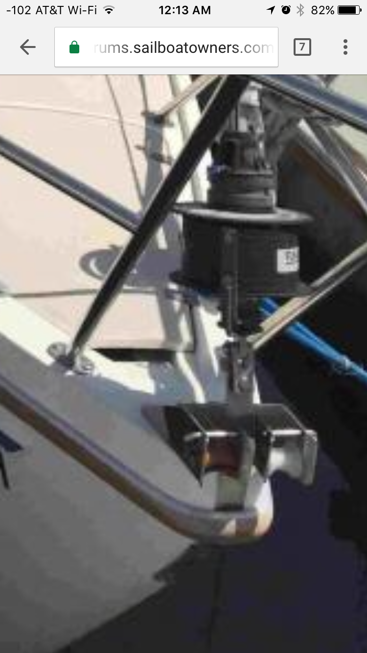

My only issue with the Delta is where to put it. I have no way to mount it to the bow when not in use. It does just barely fit inside the anchor locker, but then you have to feed it over and throutgh the furler and rails every time, or you could feed the chain permanently through and around the rails then attach/unattach the anchor every time you want to use it which I don't really want to do either.
Jun 2, 2014
594
Catalina 30 mkII - 1987 Alamitos Bay Marina, LB, CA
There is a small roller but isn't able to hold the delta in a good place.
