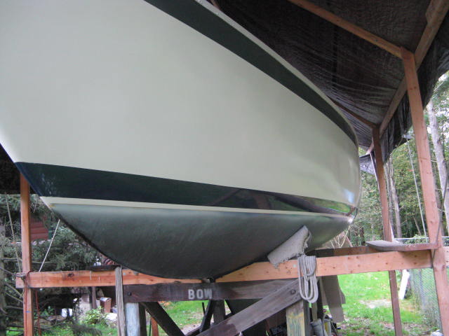

There is much to be said both pro and con for either method. Gelcoat thinned with Duratec High Gloss Additive yields a sprayable mix that air cures to a hard glossy surface. It must be catalyzed at 2% to achieve proper cure so using MEKP-9 is a must. MEK is used to clean your equipment. The biggest problem with gelcoat is the post cure finishing. Don't even think about using power sanders to cut down the inevitable orange peel. Even open coat sandpapers will wear out quickly as most sanders are just too fast. Maine Sail's sponge and paper setup is the ticket. I have affixed a sponge to my sanding board and just finished the starboard side. 4 evenings work. This is the downside to gelcoat, it is labor intensive. If a thinner mix is desired Duratec thinner is the preferred thinner. I have just completed my Oday 27 sprayup and have experienced no problems. This mix can be thin coated but yields a translucent finish that will not hide repairs and other previous colors. The solution I used was to spray thinned gelcoat only, to hide, then apply the mixed gelcoat/Duratec to finish and cure. It is up to the individual as to how much work they are willing to perform as to the selection of finish. Good luck either way you go.

Those are excellent points Rich. I am basically someone who should never be allowed to touch spray equipment. The only reason I could spray an entire boat was have it moved to my yard. The overspray can carry quite a distance as my truck was parked 75 feet away and has a lovely speckled finish. Glad it's a rolling wreck. Someone with a high dollar yacht or even their pride and joy might be a bit upset. Were I more adept at spraying the work of sanding would have been considerably less. Notice the orange peel in photo one and the after sanding in photo two. This took approximately 15 hours to achieve. I also had the benefit of considerable coaching by two expert bodyshop technicians and numerous discussions with the product manufacturers and distributors. The total cost will well exceed 1500.00 in materials only. Some overlooked items are a compressor with enough volume to operate an HVLP sprayer as well as the gun(s) along with the sandpaper both before and after. Tape alone and masking paper will run up to 100.00 for a boat this size. Gelcoating is a huge, expensive, labor and time consuming job. The end result is incomparable but, and here's the rub, know your limitations before you start. Also thanks Maine Sail your step by step is turning out pretty good although I am using the Aqua Buff.
