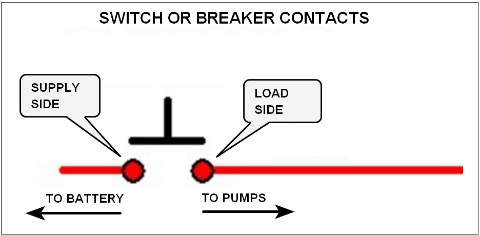

Above is a map to switches.

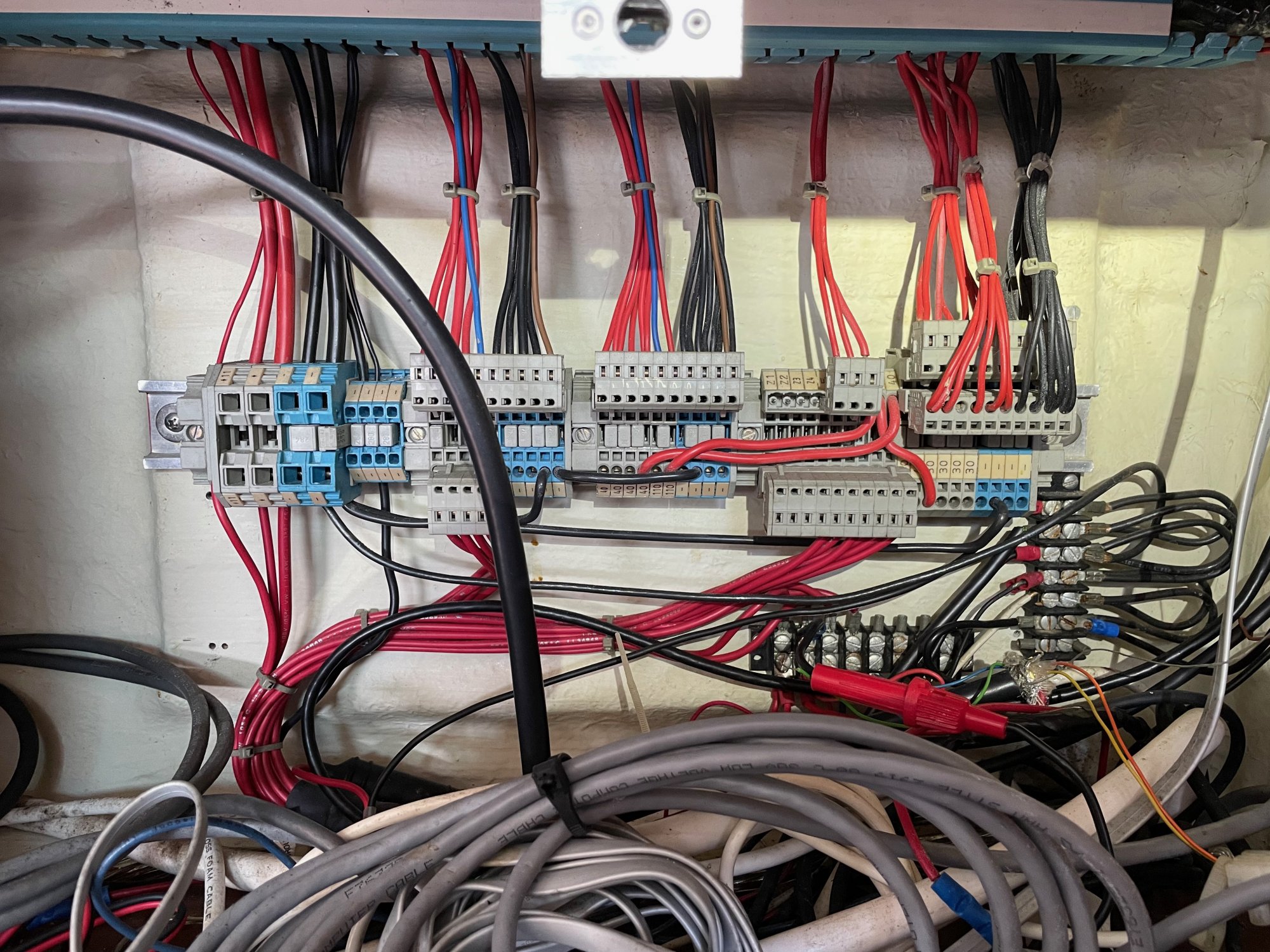

I'll get some photos next time I'm at the boat, it's about 1 hour drive from where I live. I do have a multi-meter, which I have used to troubleshoot. As for the "panel" and switch layout: There is a single toggle switch for both shower sumps. The load wire from that switch connects to the "panel" which is basically a bus bar directly behind the switch panel at the nav station. The bus bar/panel has plug-in jumpers which allow a single input wire on the supply side to connect to more than one connector on the load side. Picture of panel attached. In this photo, the jumper for the shower sump circuit is in the wrong position, which I did intentionally to isolate the separate pump circuits on the load side. There are no fuses or breakers except for a few odd in-line fuses which appear to be aftermarket for other circuits. Photo of the bus bar below, this is directly behind the switch panel. It just occurred to me that the pump wires may run through the starboard lazarette, so I'll be checking that on my next visit.

On my 1992 First 310, the panel (on off switches) are breakers. From there the hot wire runs to the Wago connectors (shown in the OP's photo). from the wago buss bar, the hot runs to a push button momentary switch mounted on the sink in the head which has a black plastic cap (cover) on it that looks like a cap nut (hides the momentary push button switch). From there, the hot runs to the pump located in the aft cabin under the berth (similar to the OP's description). The ground side should be running from the wago buss directly to the pump. So to run the shower sump pump, you switch on the appropriate breaker on the panel and press and hold the momentary switch to run the pump, release the momentary switch to shut it off. I suspect the OP's setup is similar.

JRacer, that makes perfect sense, thank you. And I just found another thread discussing the shower sump timed relay switch located in the head, so I just need to find it.
Jul 8, 2026
8
Beneteau First 38s5 Whitehall
Thanks to all who replied, Jracer nailed it. The shower sump pumps each have a push button switch located on the sink cabinet. One project down, 999 to go...
