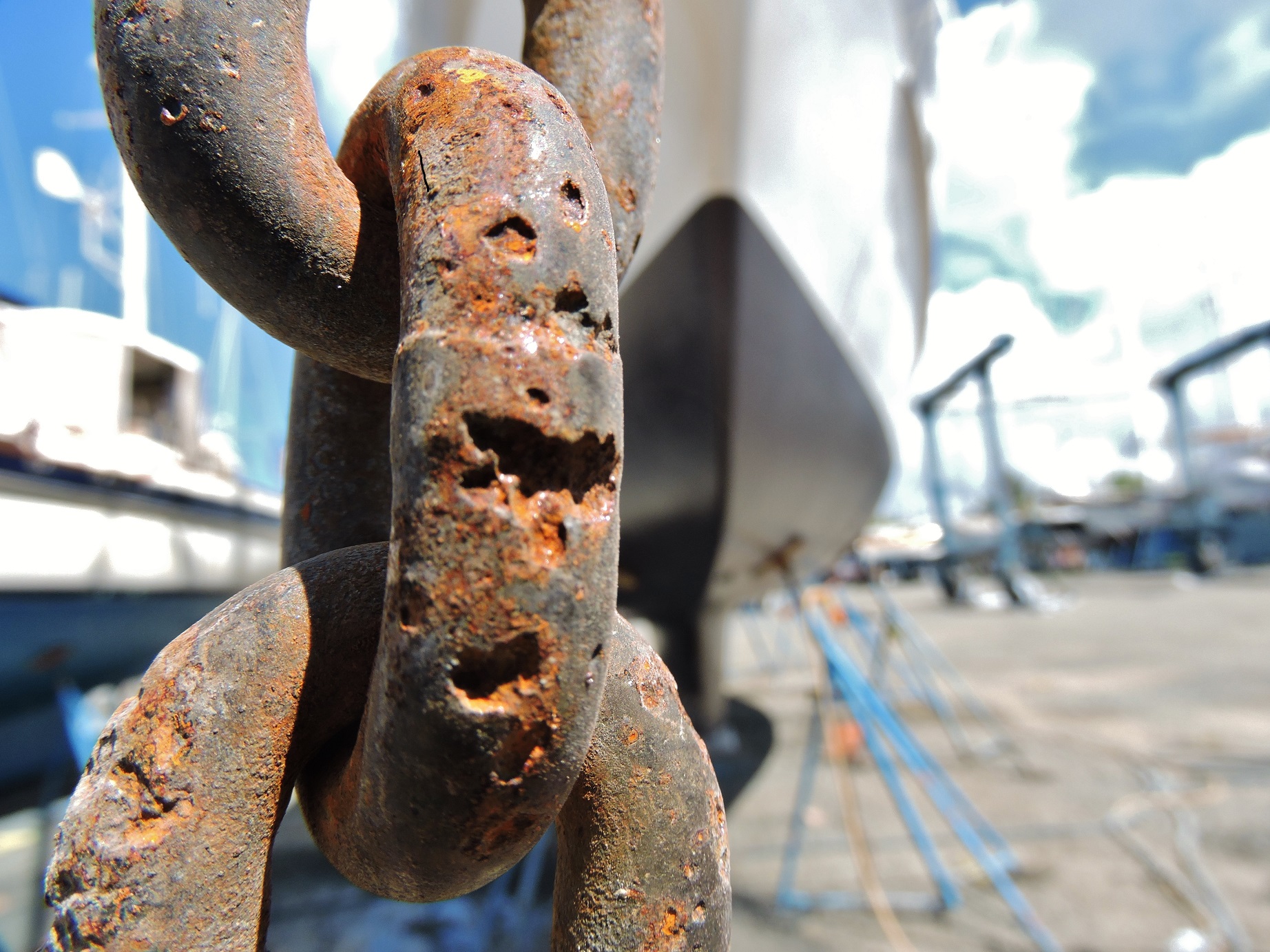

I'm on my second length of ACCO BBB anchor chain in 4 years and will need to replace it soon. Though we got our money back for the first length, it was a frustrating, lengthy and unpleasant experience. I questioned the factory both times regarding their "hot dipped galvanized" anchor chain because it looks, feels and wears much more like electroplate to me. Either they don't know the difference or they don't care. Our previous 3/8" and present 1/2" chain had the holes shown in the picture below in less than 2 years of continuous service.
I will not buy their chain again, period.
I believe Titan is the Canadian company that had the huge foul up with the Chinese manufacturing of the Rocna anchors, so if anybody does, they should know how to spec stuff out for the Chinese manufacturers to get the right quality, if they care enough. Yacht chain is a pretty small market in the scheme of things, so I doubt quality control anywhere outside the super pricey German chain industry is very important to the companies.

The consensus of opinions as to the fault in this chain seems to be that it is metallurgical. It is definitely NOT electrolysis. Neither the anchors or shackles have any of this corrosion (or lost galvanizing) and nor does the inside of the links. Either this steel is softer than the sandstone coral of the Caribbean anchorages or the metal production is faulty.

I lean on Metal - FAULTY

Never seen a chain link like the one in the image above. The area we sail/anchor in is sea water. To help insure that I obtain a long chain life I steer clear of either BBB or proof coil. Neither are as strong or as corrosion resistant as G4 or G7. We have G4 anchor rode and whenever I need any our local industrial supply house inventories hot dipped galvanized G4 that fits our windlass. They tell me it is USA made and I trust them. The 30' section that came with our 1991 boat had no signs of corrosion when I replaced it for a 50' section about 15 years ago. Still no signs of corrosion on the new section after spending a considerable amount of time in sea water at anchor.
Interesting. These chains are made from "wire" that is then bent and welded into the link. Even if the chain is "made" (ie bent, welded and galvanized) in the US, I wonder where the steel is made? I know that when a project I was on had to get a large amount of titanium pipe we had to get most of it from Russia even though we were under a government contract that specified "Buy American." Go figure! Of course we did extensive metallurgical testing before we used it.
From the pictures Capta posted it doesn't look like erosion but more like pitting or loss of metal. It looks like there were defects or inclusions in the wire that then corroded quickly, leaving holes. I lean on the side of a metallurgical failure in the base wire too. The disturbing part is that it has happened twice to Capta so its hard to call it a "isolated" event. Too bad we don't have a recall system like with cars. It is a significant safety issue if you can't rely on your anchor chain and its due to a manufacturing defect.

The image of Capta's chain does lead one to inspect the chain rode at least once a year. Pull it out of the locker, run it down the dock, give it a wash and take a look at the metal.

Looking at Capta's chain the troubling part is not the general corrosion but the deep pitting near the welding heat affected zone. I don't know if the welding had anything to do with it but I imagine they use an automatic welding machine so you wouldn't expect inclusions or slag. If it was general corrosion then once the zinc wears off you'd expect the damage to be more "even", not what appears to be very deep pitting. Something is really wrong there and I'm leaning to a material defect in the wire itself. Maybe I can come up with some "older" ACCO BBB or G4 chain from one of the many salvaged boats here in the east coast between Jacksonville and Beaufort. I have a contact with one of the guys hauling away the boats to scrap them and maybe he can hook me up. Based on what I see in Capta's chain and the discussions from sailors like you with chain 10 years or older it may be that the general quality has declined over the past few years.
