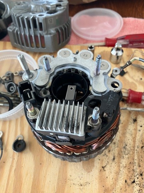

I carelessly shorted my alternator & now attempting to rebuild. The continuity of the stator & rotor windings check out normal. No evidence of overheating or burnout visible. Have traced the problem to diodes & perhaps the internal voltage regulator. Fortunately, I have sourced a compatible module that has new diodes, brushes, & regulator that is pre-assembled for a very reasonable price, especially when compared to a new Yanmar alternator at $800! Presently awaiting delivery of parts. The module assembly is shown in the photo sitting atop the stator.
Any insights would be welcomed, just don't ask how I damaged the alternator!

Looks good. To protect the alternator from future damage from loss of ground, install #8 cable from the ground lug of the alternator to the shunt on the opposite side of the shunt's battery connection.

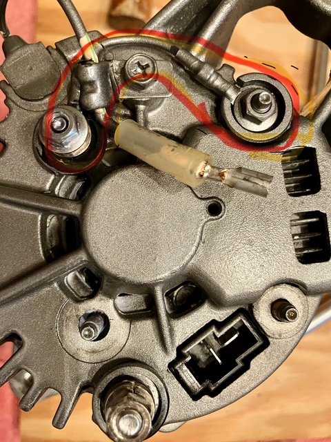

Joe, I think that the cable that you mentioned is highlighted in RED on the rear alternator case. Is that correct?IMG_3086.jpg

BigEasy, I do not think that is the ground lug. If i had to guess i would say that it is the lug just below the one marked at 4 o'clock pisition. This lug has no nut on it.To locate the ground or negative side, make a resistance measurment from the outer case to the ground lug. It should be zero ohms. Reverse the voltmeters leads and repeat the measurement and it should be zero aswell.
In most installations ground is provided through the installation hinge bolts that are bolted to the engine block. But these are not a reliable way to provide ground to alternator, as only a microsecond of loss of ground will damage the diodes. The lug i picked has no nut on it, confirming that it was installed without a grounding wire.

To locate the ground or negative side, make a resistance measurement from the outer case to the ground lug. It should be zero ohms. Reverse the voltmeters leads and repeat the measurement and it should be zero as well.
Thanks Joe, I will test it per your advice when I get it reassembled. Much appreciated.

Quick update on my 60 amp Hitachi alternator rebuild project. Appears that it is working normally now. I was able to purchase a replacement diode/regulator/rectifier/brush module that greatly simplified repairs. Problem that I encountered was that the cable lugs that are part of the module were too short, so I knocked out the lugs from the OEM Hitachi module & installed them on the new module. That cost me another module purchase, so total cost was approximately $100. Not very difficult; had to grind off the stator wires from the old module & crimp & solder same wires to new module. Windings, bearings, & slip rings were good so didn’t have to replace those components. Parts were available from Maniac Electric in Dallas & Regitar USA in Montgomery.
