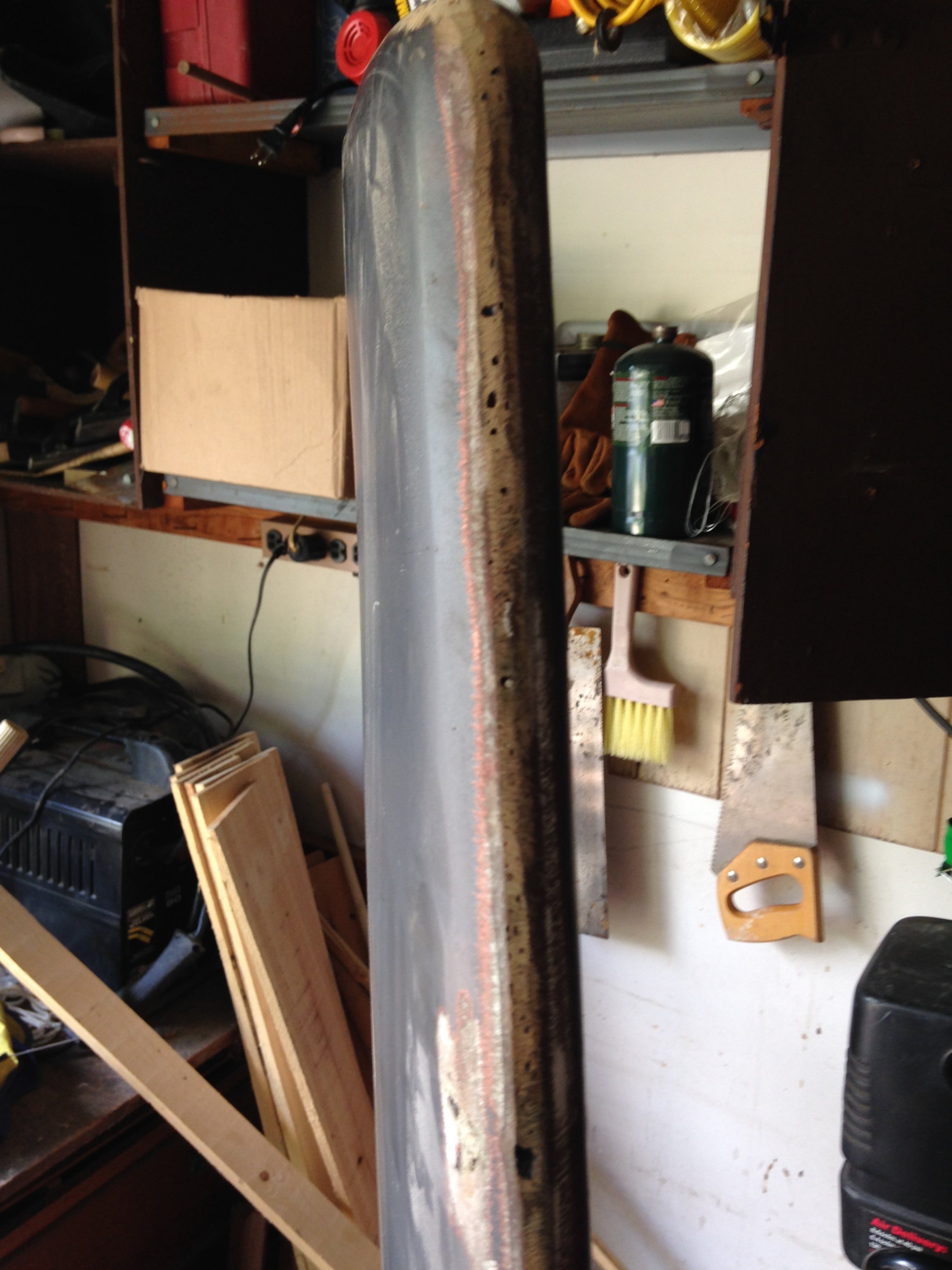

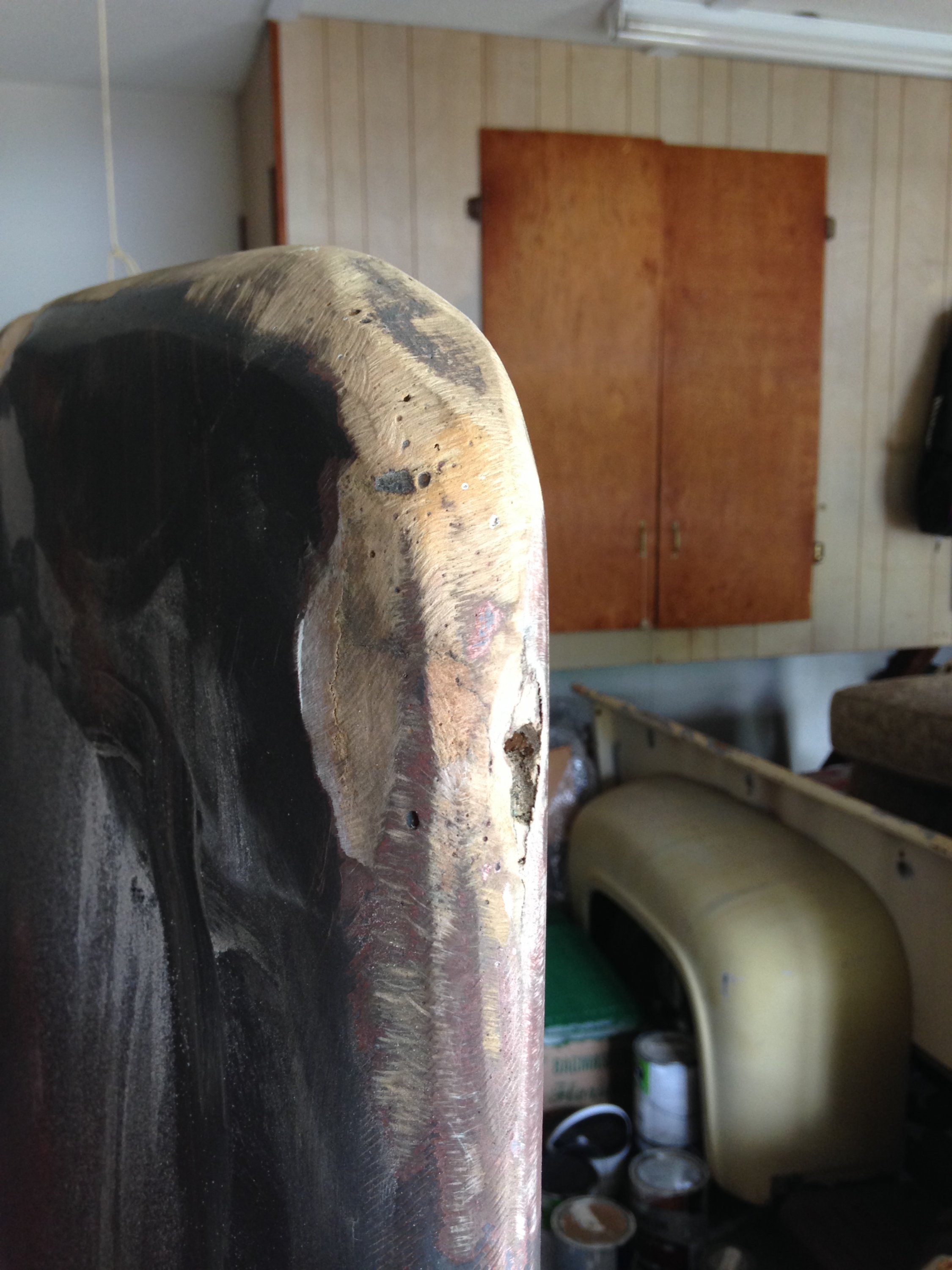

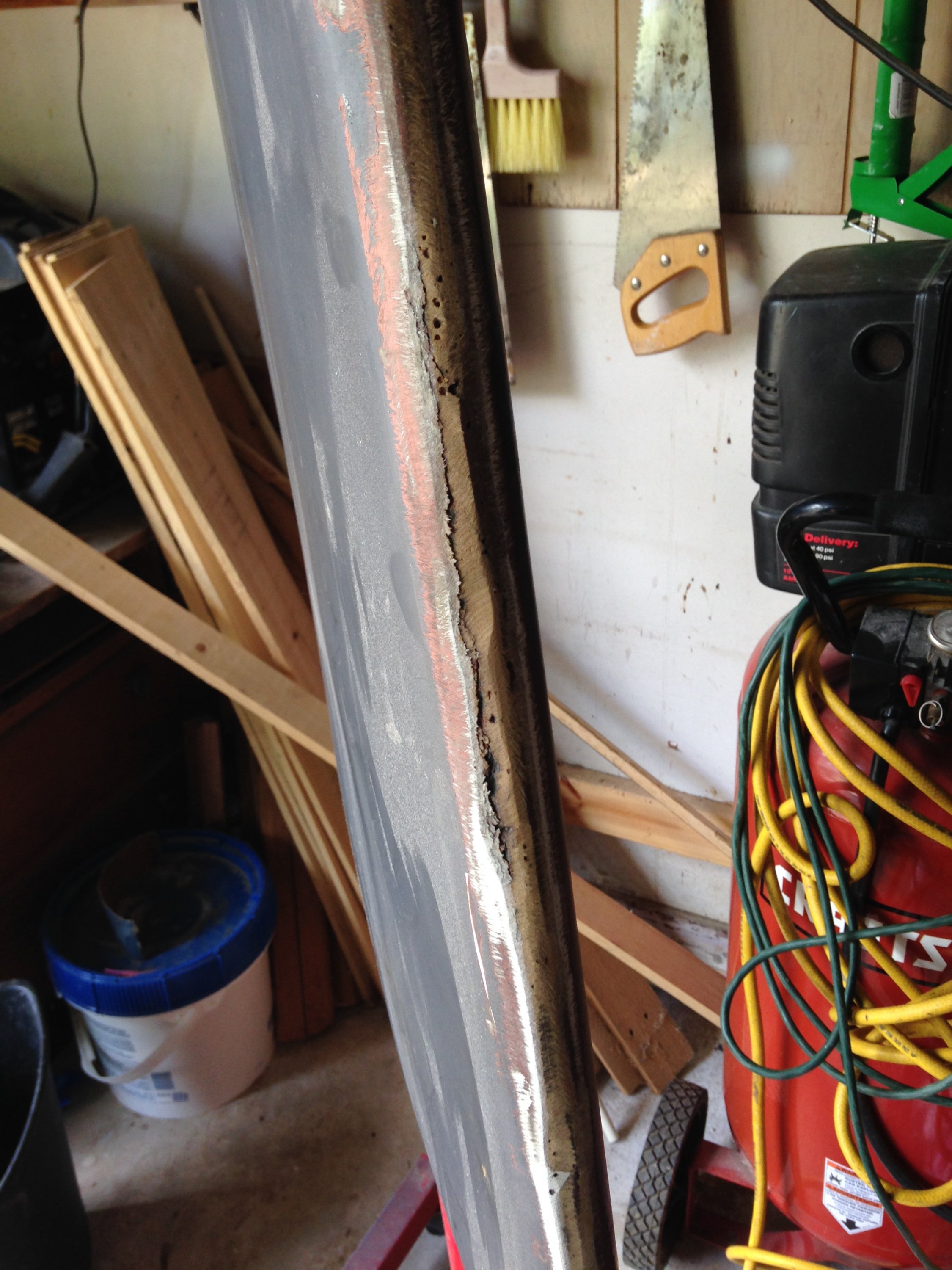

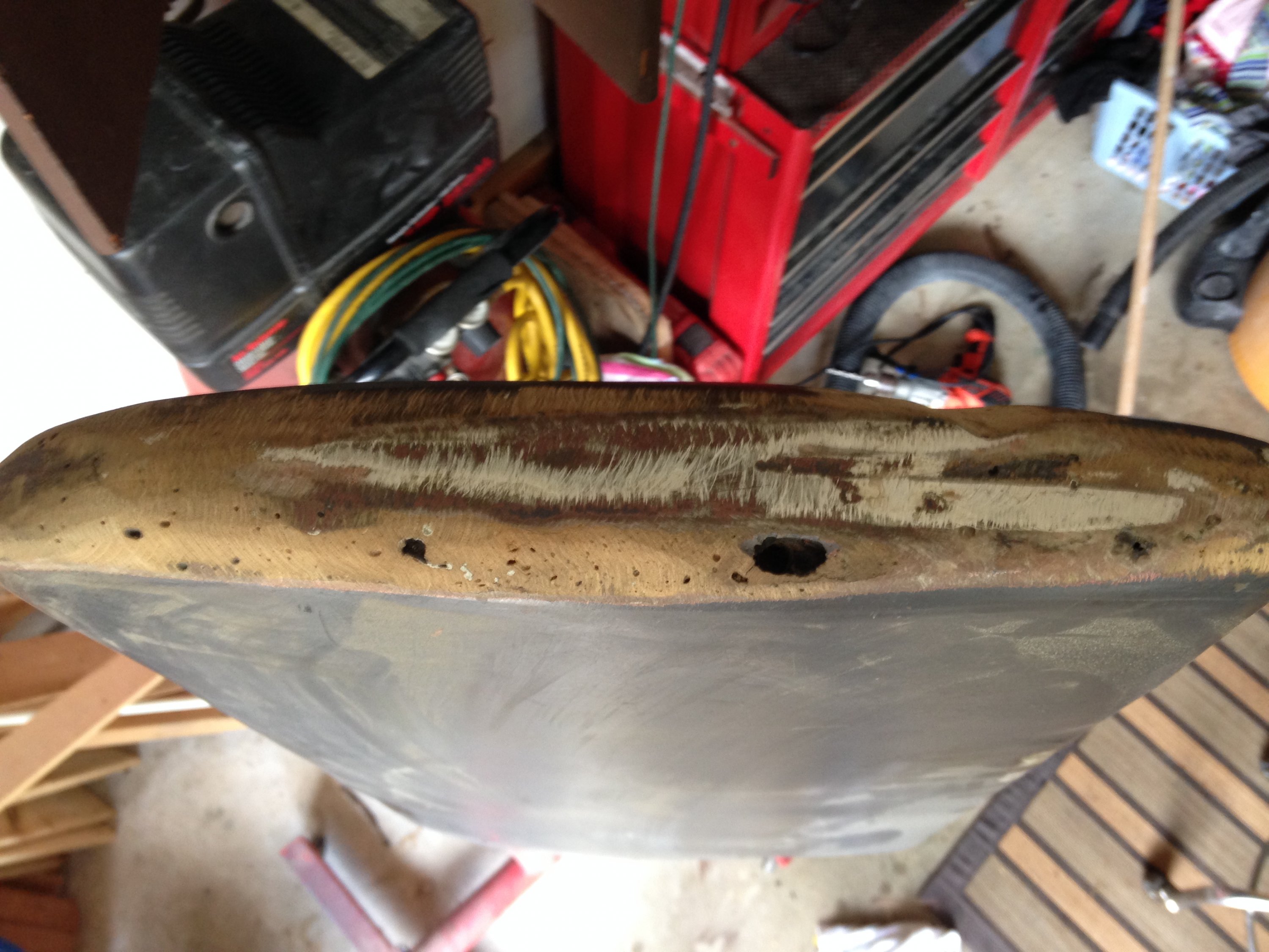

my rudder on my 21 foot boat had water in it when I took it out. It has set all winter to dry and I am finally getting to repair it. The previous owner had painted it with a copper paint and it looked nice when I bought it but after months in the water it was crap. When I started roughing up the areas to fix I noticed that the sides are fiberglass and most of the end is bare wood that was painted with no fiberglass. Should I fiberglass over the ends to protect, seems like a stupid question but maybe it is supposed to be wood.

What are those holes? Looks like foam core, not wood.

It is definitely wood. Those holes are voids that have opened up. There was only paint on the leading and trailing edges over the wood. I drilled into one of the voids and dry wood came out. It is a very heavy rudder, I was wondering why foam was so heavy and now I know why, because it's wood. Is it that important to get the new fiberglass that smooth. You obviously won't see it but I don't want it to affect performance
