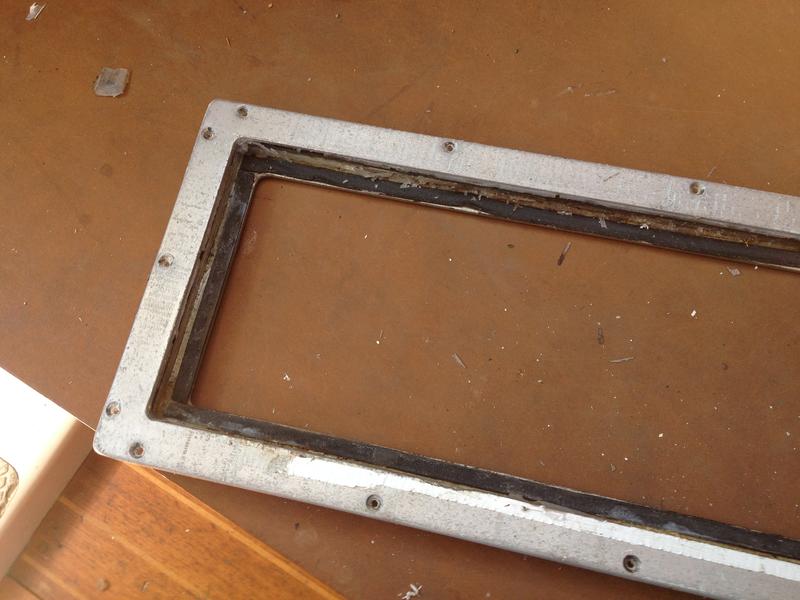

However, to set the acrylic in the frame I am wondering if I should use butyl tape. The factory used neoprene glazing tape (see photo) but seems like I read somewhere butyl tape the best approach. Any thoughts?

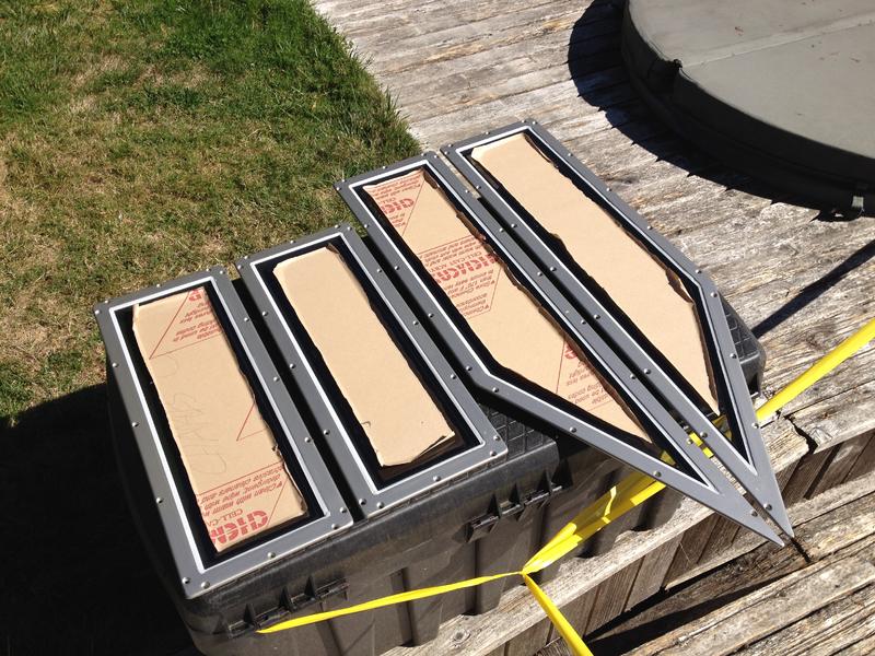

After nearly a month of working on it when I had time I am finally about ready to put rebuilt portlights back in the boat. It took longer that I had hoped but that's usually how projects go and I feel good about doing it right.
I pretty much just followed Richard's example from the Owner Modifications section except I used a 3/16" perimeter gap to give a slightly larger joint for the 795. I will repeat his comment on the importance of removing all old silicone. I spent much more time digging and scraping the old silicone than Richard admitted to and I thought I had it but I can see a couple spots in the paint where there was still a bit of residue.
I got the acrylic pieces cut to size from a paper patterns by the local supply house for just a "few dollars more" but pretty sure it was worth not having to cut it up myself.

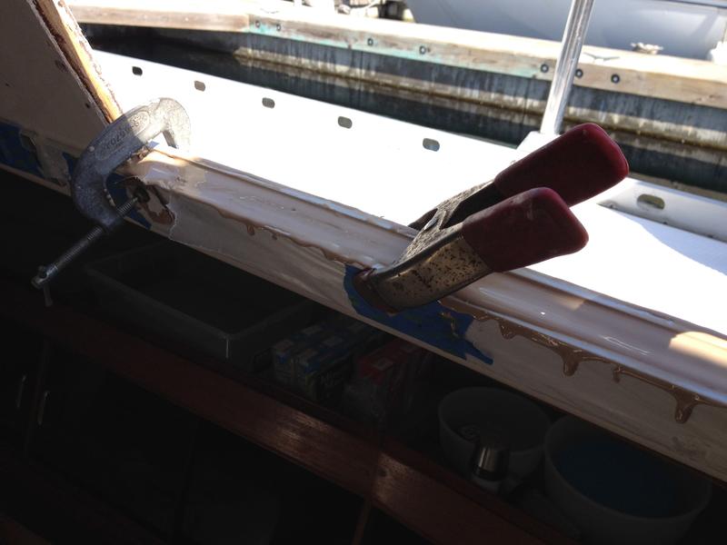

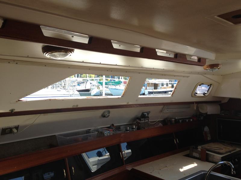

Fixing the cutouts in the cabin was another case of things taking more time than I had hoped. My boat had suffered some core delamination around the openings and the PO filled the delamination voids with silicone and put it back together. I removed all the old silicone and started over.
After digging out a couple small areas that were soft I first filled all the voids with epoxy and clamped it to relaminate it and create a uniform wall thickness. The frame and trim want a uniform 3/4" so that was the goal.
After that dried I came back with a epoxy filler and filled the hollowed out soft spots and leveled out the opening. One of the sloping sides was cut too large by the factory and the screws didn't really grab anything so I built it out too. Did a test fit last night and everything looked great.
Today I set the glazing and filled it up with 795. The forecast for tomorrow says rain so it might have to wait a few days to set the frames on the boat but I'm getting close. I am anxious to stop working on the boat and start sailing her again!

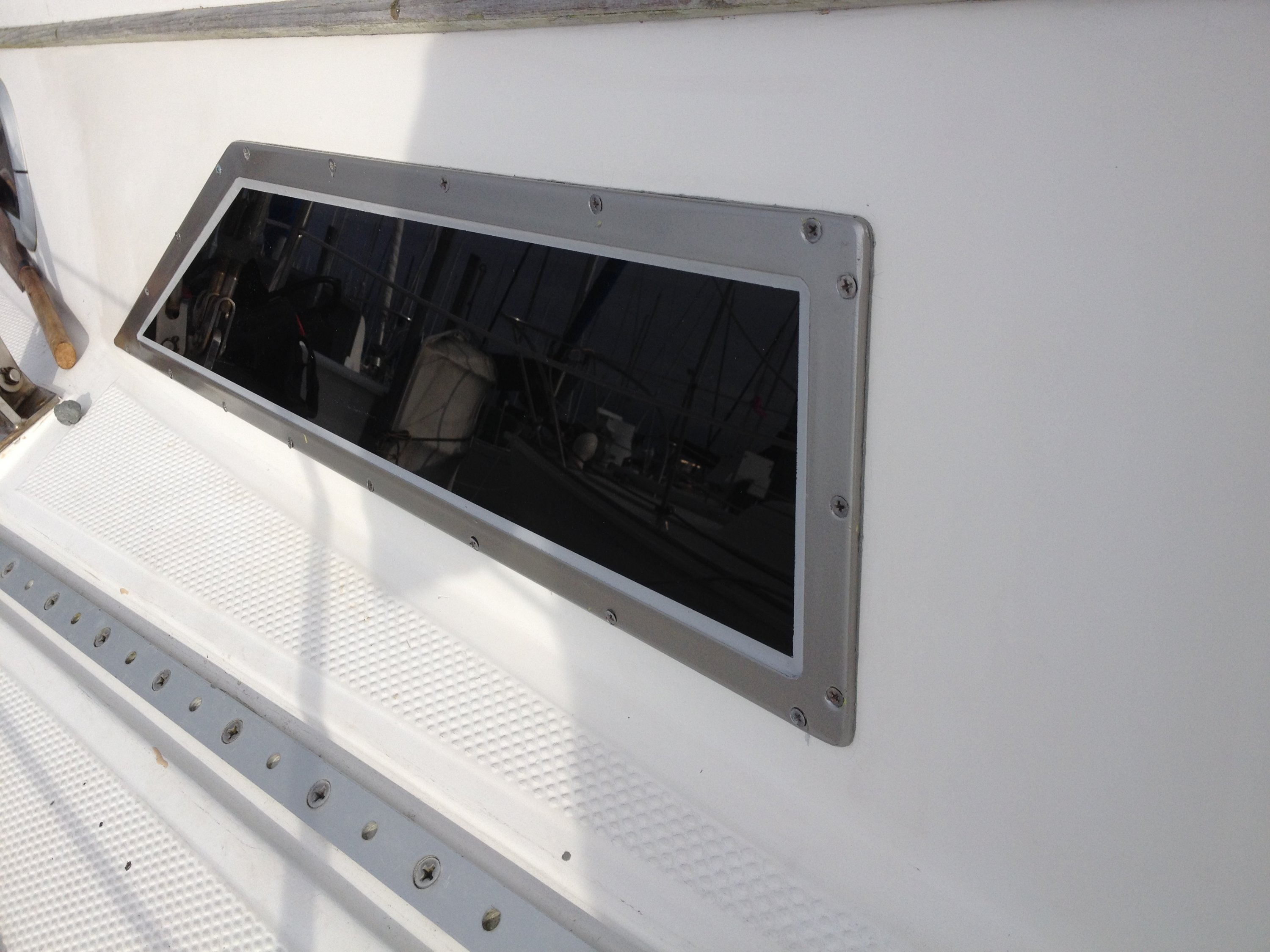

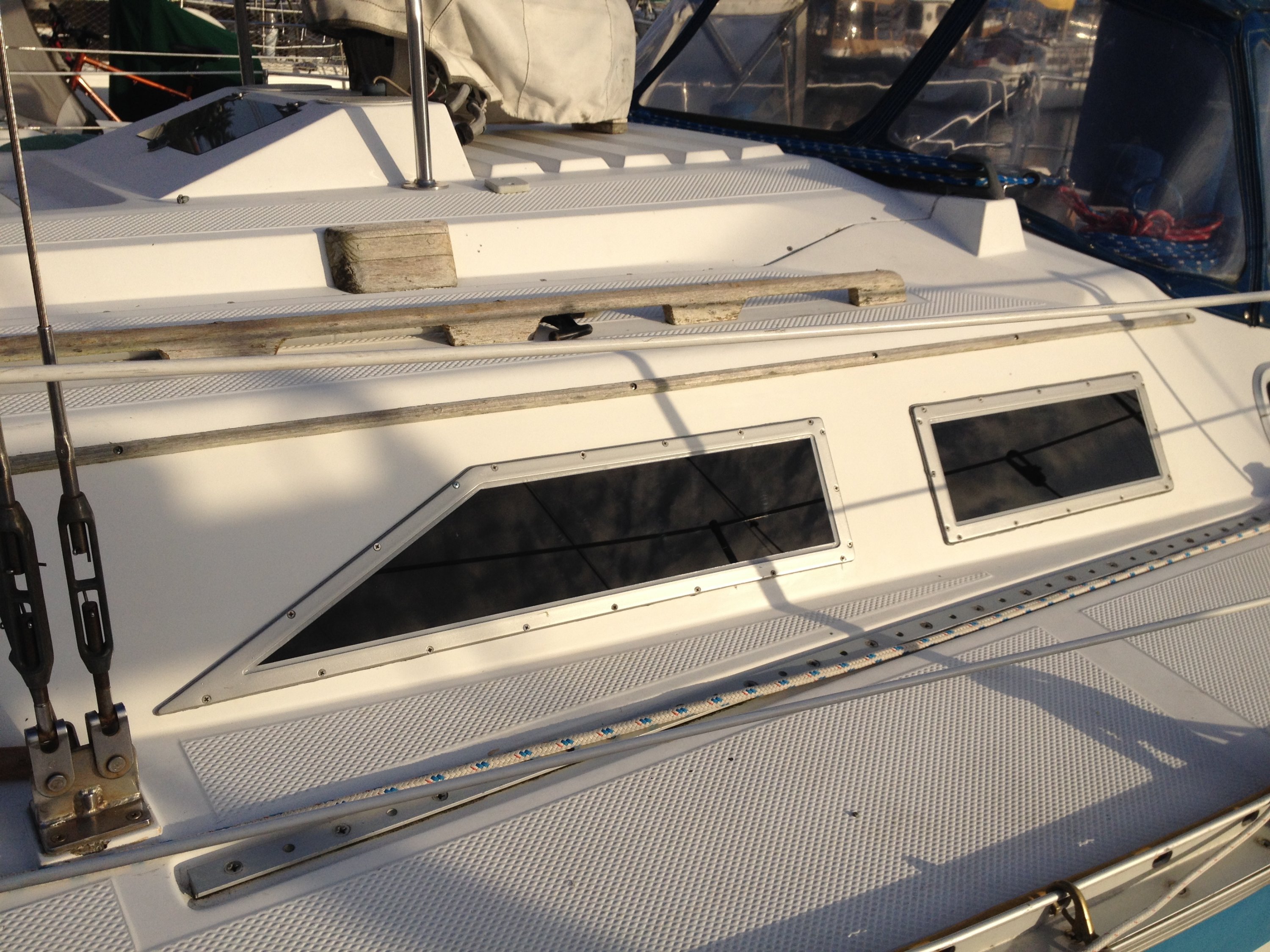

I see you used the Gray 795. How do you think it turned out. I am trying to decide between Gray or Black 795 for the outside. I will use white 795 for the frame to hull joint.
I decided on grey because I thought it would be better to match the frame. As it turns out the 795 grey is a much lighter shade than the frame. My gut reaction after I finished was should have used black but I've gotten used to it and even sort of like the pinstripe effect. Also, I used butyl tape from MaineSail (http://www.pbase.com/mainecruising/buy_bedit_butyl_tape) for seating the acrylic glazing into the frame and for the frame to fiberglass joint. I think that is a better choice than silicone for this and just about anything else on a boat. Filling the joint between the acrylic and frame is about the only place I would ever use silly cone. Just finishing up a northwest winter with no tarp and no leaks.
