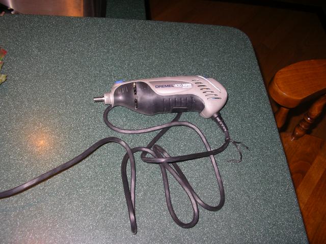

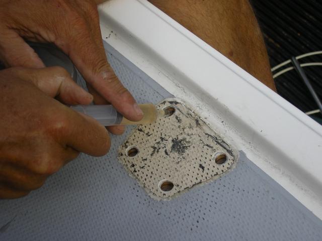

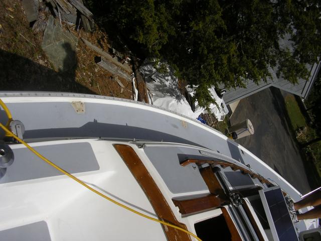

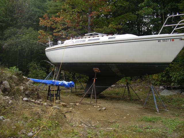

After ending our season early we brought our boat to the backyard for the winter and needed work. After removing cushions, kitchen stuff, and sailware, I debated some options and decided removing the stanchions for the winter would be number 1. I followed Maine's advice and epoxied (potted) all the drilled holes at the base of each stanchion. The first mutiny was the new Dremmel 400 XPR, burned up on the third hole. I bought a Dremmel 4000 to replace it and finished the job. Here are some pictures.

Like the work but I am more impressed that you got your boat into your backyard! And I am envious. Not only that you have the boat at home but that you were able to get the stanchions off. Mine are the type that overlap the metal toerail, have a spacer under the non-overlap that has mostly disintegrated, leak, and are nearly impossible to reach inside. That will be a good feeling having those solid and leakproof.

Yep, I am very jealous that you have her int he backyard. One thing I am considering when I remove my stanchions is making a mold area around the plate footing and pouring a little base so water can never pool up there again. I saw it done in a book, looked like a pretty good idea.

Are you going to pour the epoxy into the holes and mold at the same time? How about the slant of the deck? Good thought if it doesn't run to the side.
So far the boat is out of the way but come snow plowing time and I'm sure I'll be kicking myself. :bang: We were pretty depressed when it was delivered however it is convenient for tools. Now I just complain about climbing the ladder. Next job is to strip the bottom paint with Soy Gel.

Having the boat close to home is terrific. I did a total rebuild on my boat while it sat in the side yard. You can consider some aspect of the work and run out for a fresh look and be back in the house in five minutes.
