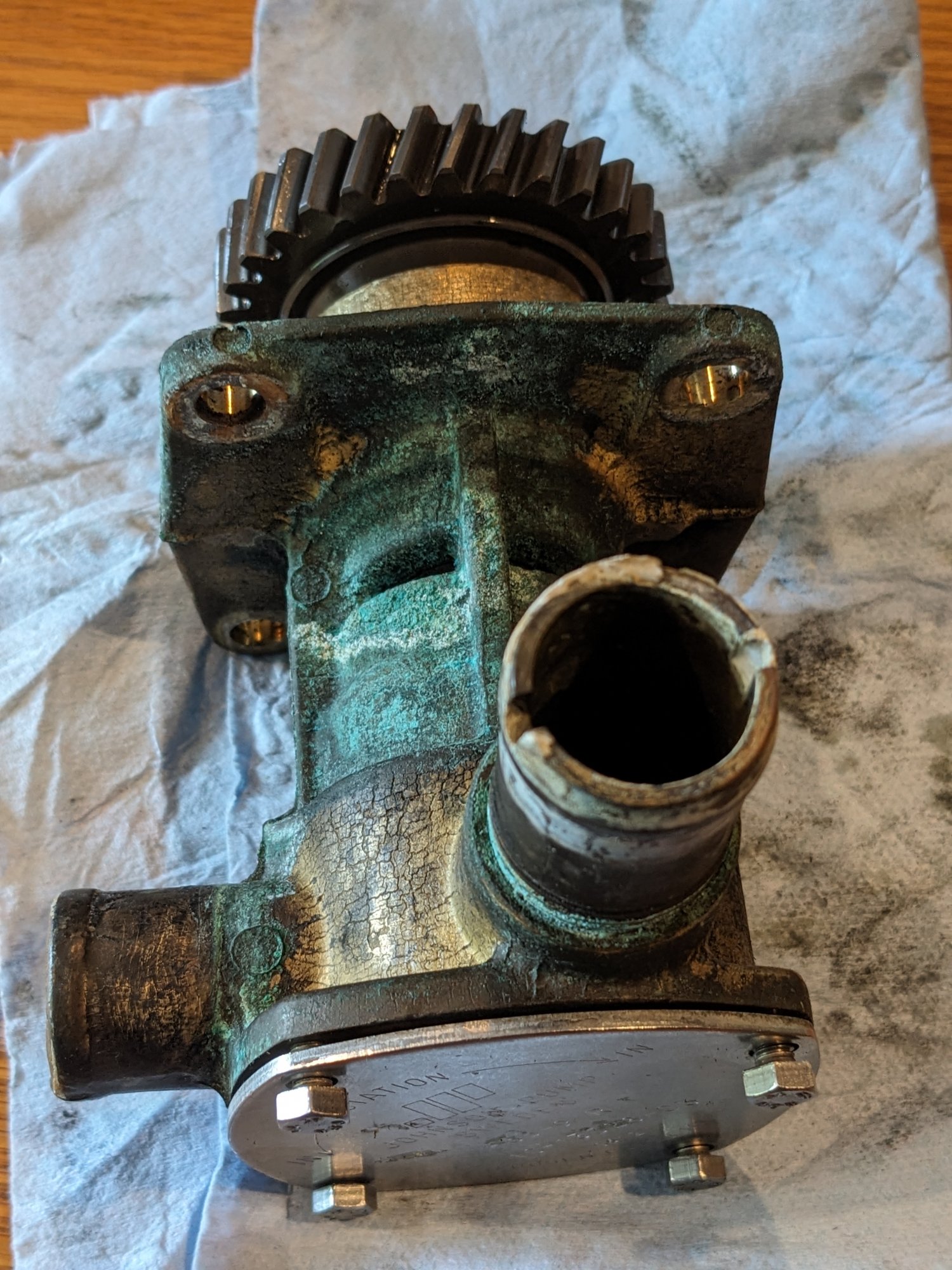

A month or so ago I was poking around the Yanmar 4JH4E engine on our 2007 H41AC and I found what looked like evidence of leakage on the underside of the raw water pump around the weep holes (see the "before" photo). The engine has about 1400 hours on it. I removed the pump from the engine and took it to my shop to disassemble it and I found that the V-ring and the mechanical shaft seal were substantially deteriorated. The pump shaft had deposits on it but it looked like it might clean up with Scotch-Brite (it did).

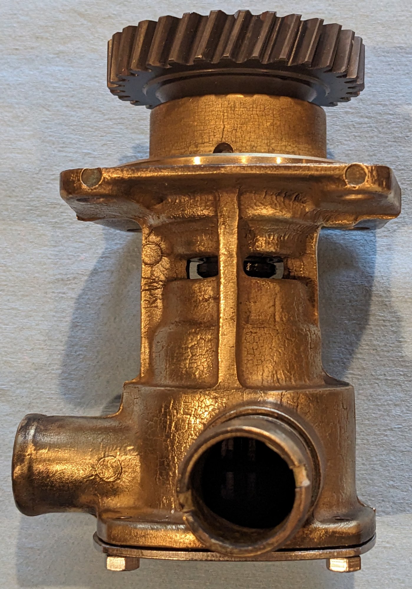

The reassembly process is fairly straightforward, the primary issue being the orientation of the V-ring seal and the components of the mechanical seal. If you observe carefully while disassembling the orientation will be clear. A photo of the finished pump is attached. By the way, the mechanical shaft seal has two parts and Yanmar has separate part numbers for each but Johnson Pump has one part number for the set.
