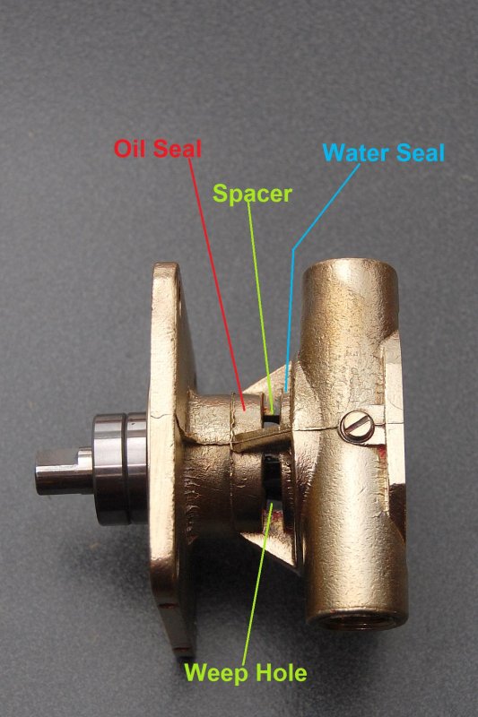

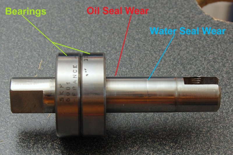

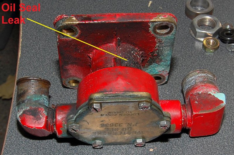

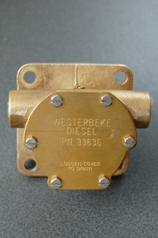

As some of you may know I have been doing some winter projects on my engine. It seems once I get going I just can't seem to stop. Last night I rebuilt my raw water pump and took photos along the way..
I posted a new "how to" article on my site on rebuilding a raw water pump for those interested in the process. I would post it here but there are three pages of photos..;)
Rebuilding A Raw Water Pump (LINK)

Squirt a little motor oil in the bearings before it is installed. The lube for the bearings there in the block is "splash" .. Best splash some before it starts up.
Feb 6, 1998
11,760
Great work, Main!
Did it, and pre-lubed the oil seal before sliding it over the shaft too. I forgot to mention it but will add it! Thanks for the reminder there is probably a lot of detail I forgot to mention..
