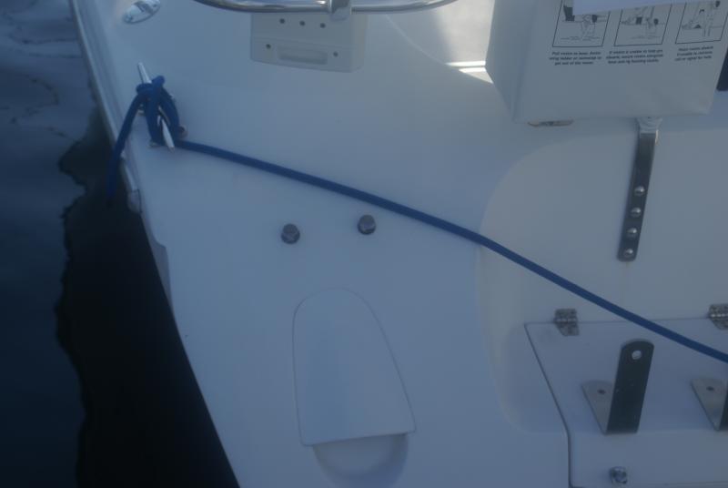

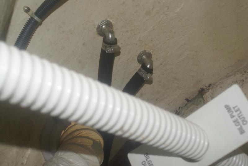

- There has been no more back flow into the head bowl since I replaced the joker valve
- I finally got some time to get some things done on the boat. Work and tending to the spouse have severely limited my ability to get things done. In addition to getting the material in the stuffing box replaced (that was a new experience!) I back flushed the holding tank lines.
-- The vent line is a very short run to the tank, not more than 18 inches and a straight line.
Picture 1 is the exterior. The silver vent on the left has two 3/8" screens in it and goes to the holding tank. The vent on the right also has two 3/8" screens and it runs to the fuel tank.
Picture 2 is the interior and a real pain in the rump to access. The line on the right is the holding tank vent, the one on the left goes to the diesel tank.
-- I opened the pump out fitting and back flushed the vent at a rate of 0.5 gallons per minute via a 3/8" OD siphon hose. The screens are clean. I ran two gallons into it. No issues. If the vent was plugged, the line should have filled with water and overflowed.
- I also back flushed the pump out line with water from a hose at the rate of a gallon per minute. Four gallons went in without an issue.
- Given the above, I'm presuming the vents and pump out lines are clear. I was able to go offshore a week ago and run the macerator/pump through the seacock. It chewed on stuff and then appeared to run OK. I suspect and overabundance of toilet paper. I think the tank was empty when I shut it down.
