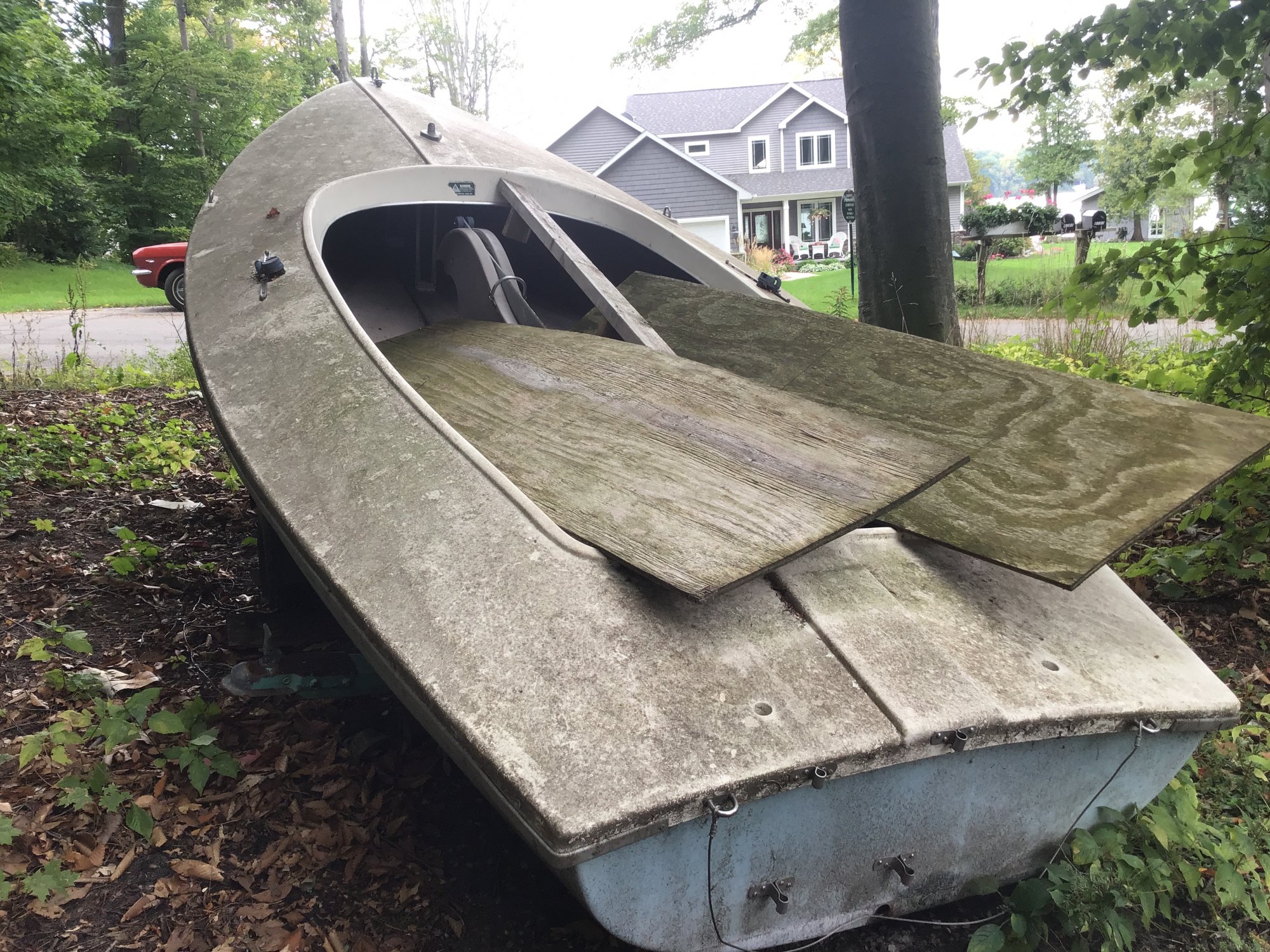

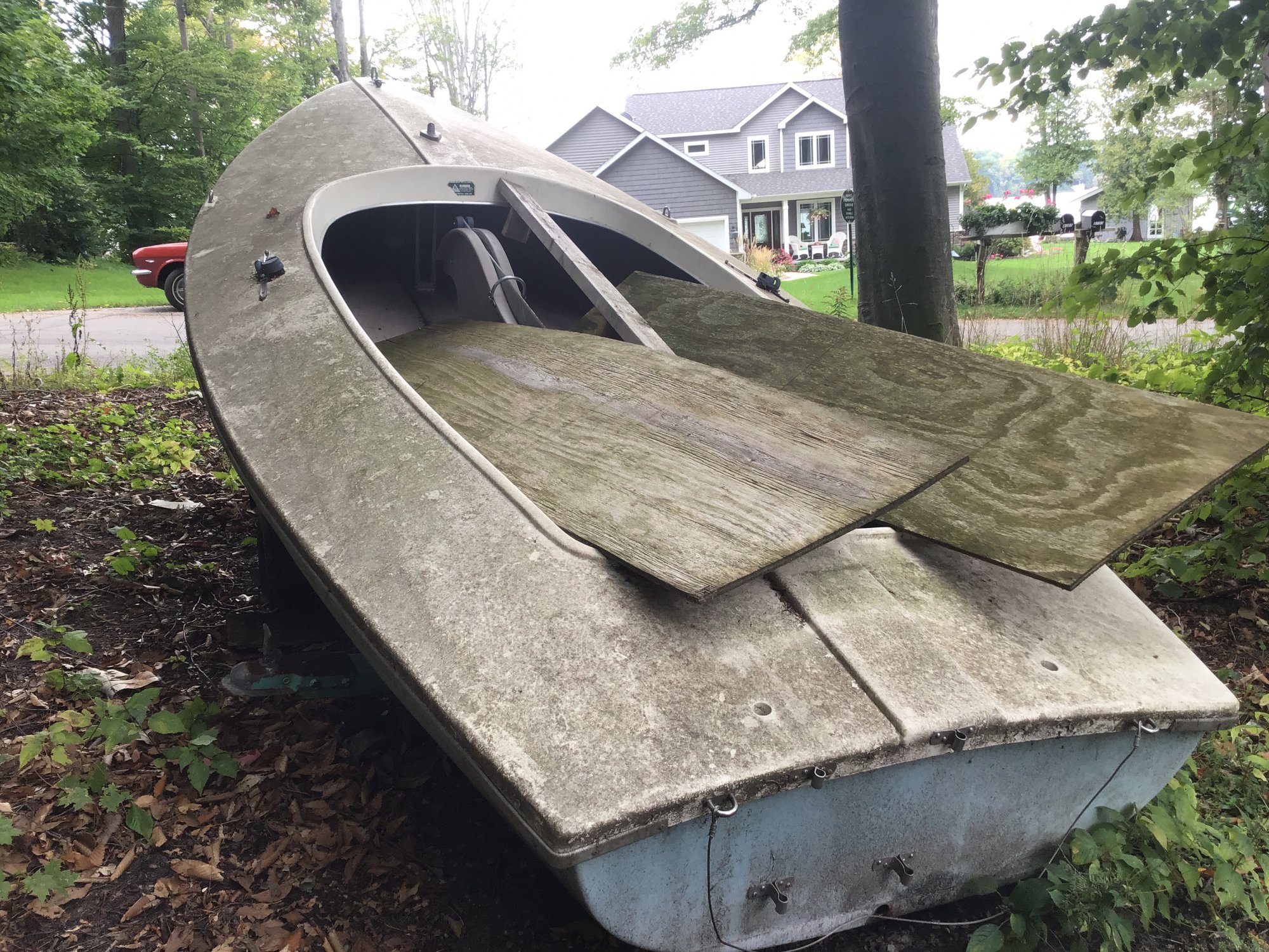

I rescued a rebel 16 mk2 and trailer for the hefty sum of $1. The boat itself was covered mostly in a trap outside and the gel coating is heavily crazed. It doesn't look like any of it is structural damage though. The peripheral equipment was garage and basement kept and aside from some minor mouse damage in pretty good shape.

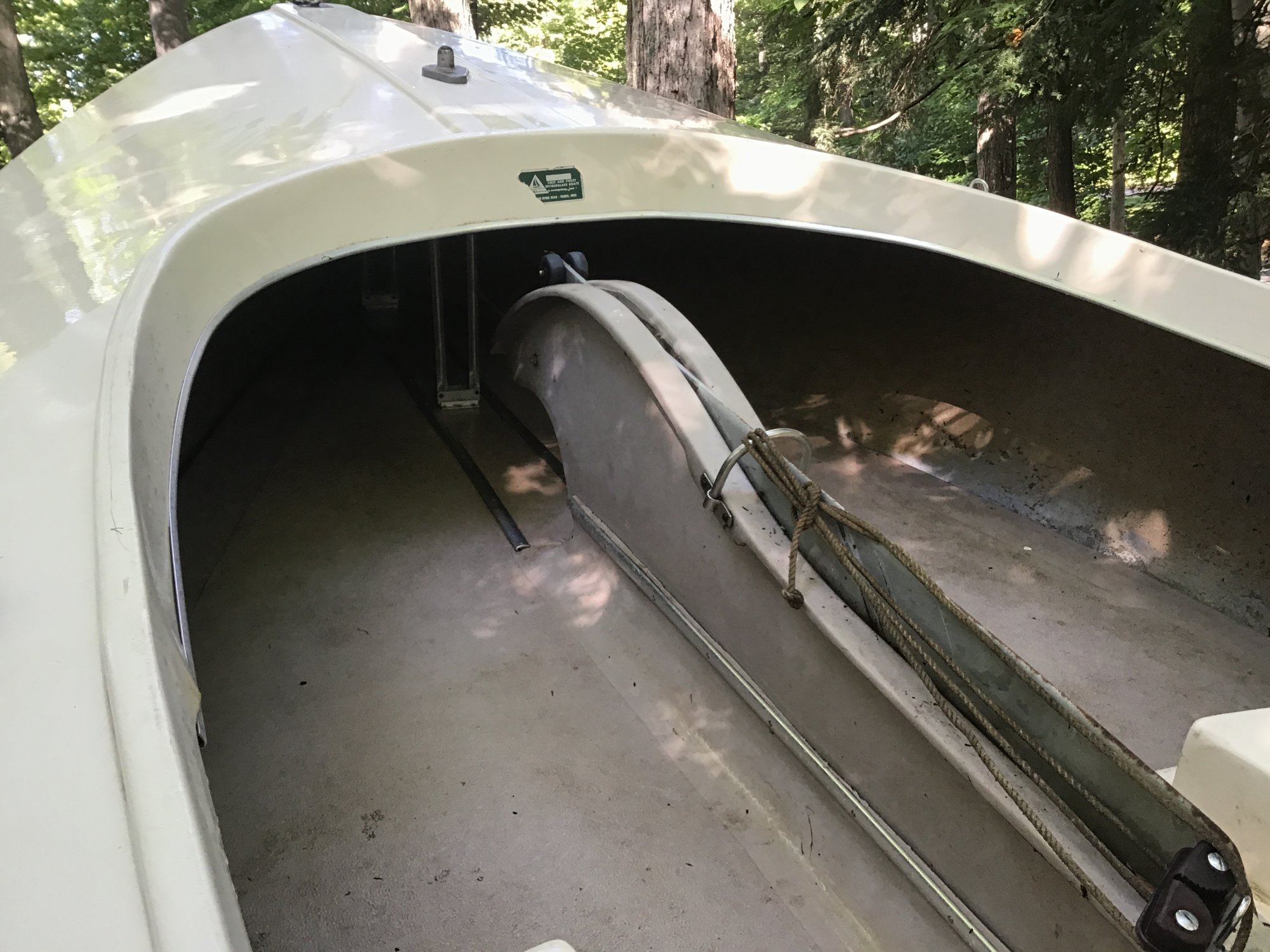

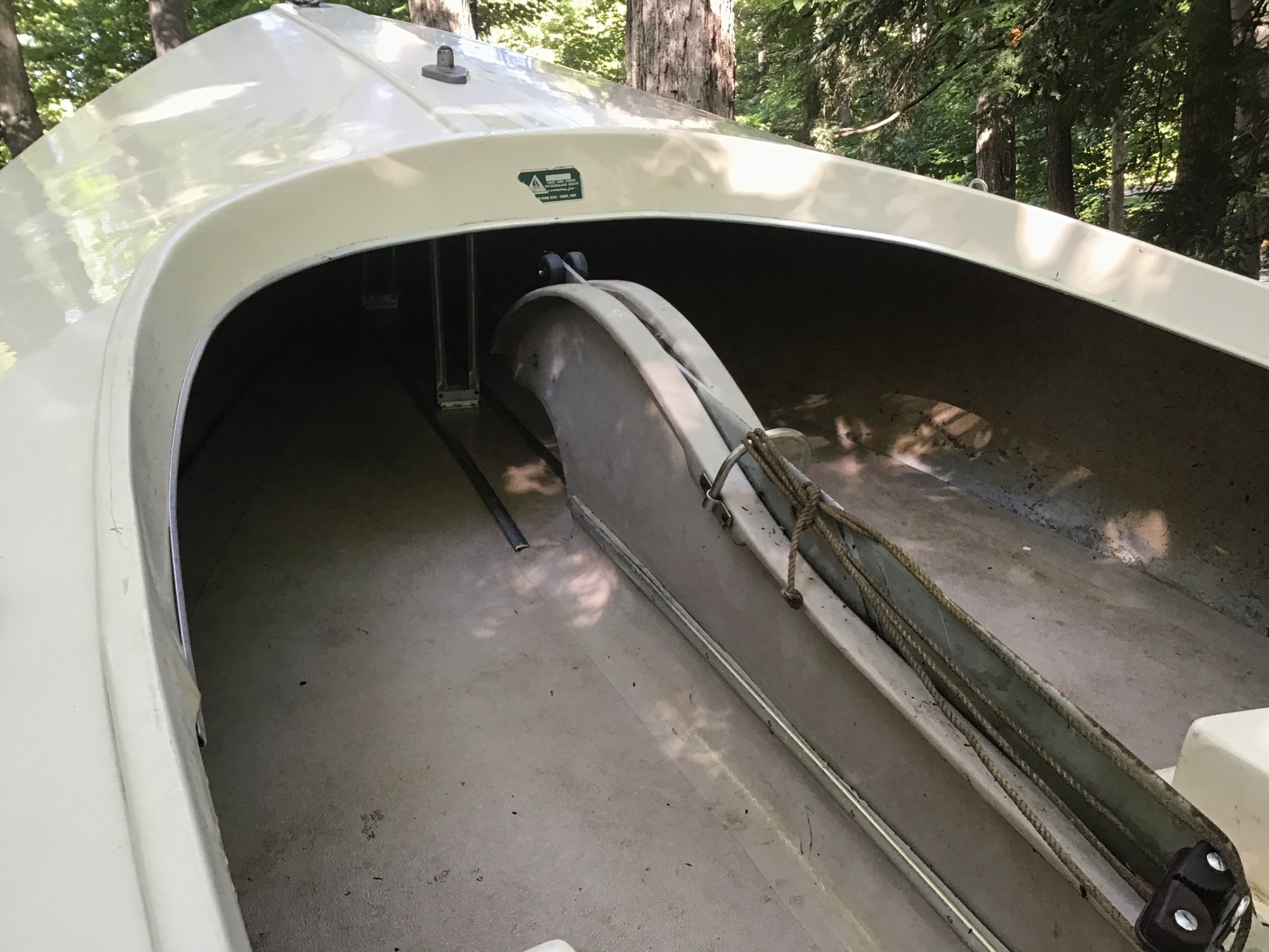

I am curious about how the centerboard works as it doesn't appear to have a pivot.

I have a free Rebel acquired last year. The hull is a bulletproof tank. Any local sail school or club will have a do-gooder willing to help.

The CB does have a pivot in the bottom of the trunk. Mine has a 6 or 8 part tackle under the foredeck. It works well. I get in the boat on a mooring and set the CB just above the bottom. Finish rigging, hop in and sail for deep water, let the board full down. Yo may need to reach over the transom to force the rudder down.

My free boat started out dirty, mold covered and packed with acorns. Soap and a brush, shoveling nuts went a long way. It took two of us about twenty minutes to fully rig it on its trailer.
