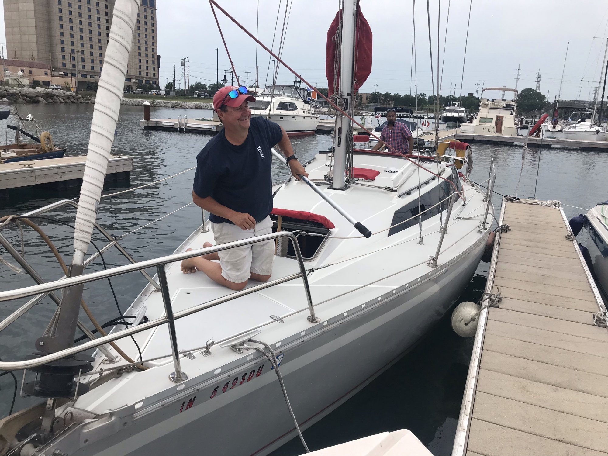

Probably need a photo to properly comment.
on my O’Day 322, the aluminum toe rail has holes in it to let the water drain, it the base of the toe rail is bolted and caulked to the deck.
you might be able to see it in this phot...

You don’t have problems of water pooling due to the toe rail being bedded with caulk?
