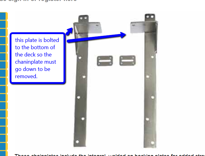

I have removed the chainplates from my 1988 Catalina 30 for inspection. What is the recommended way to reinstall and seal them? I have the Butyl tape from Main Sail and can use that if it is suitable. I am concerned that it might not be a proper way to install because it will not be under compression. The installation consists of an oversized slot through the deck with a tight fitting cover plate over it.
Any thoughts?
