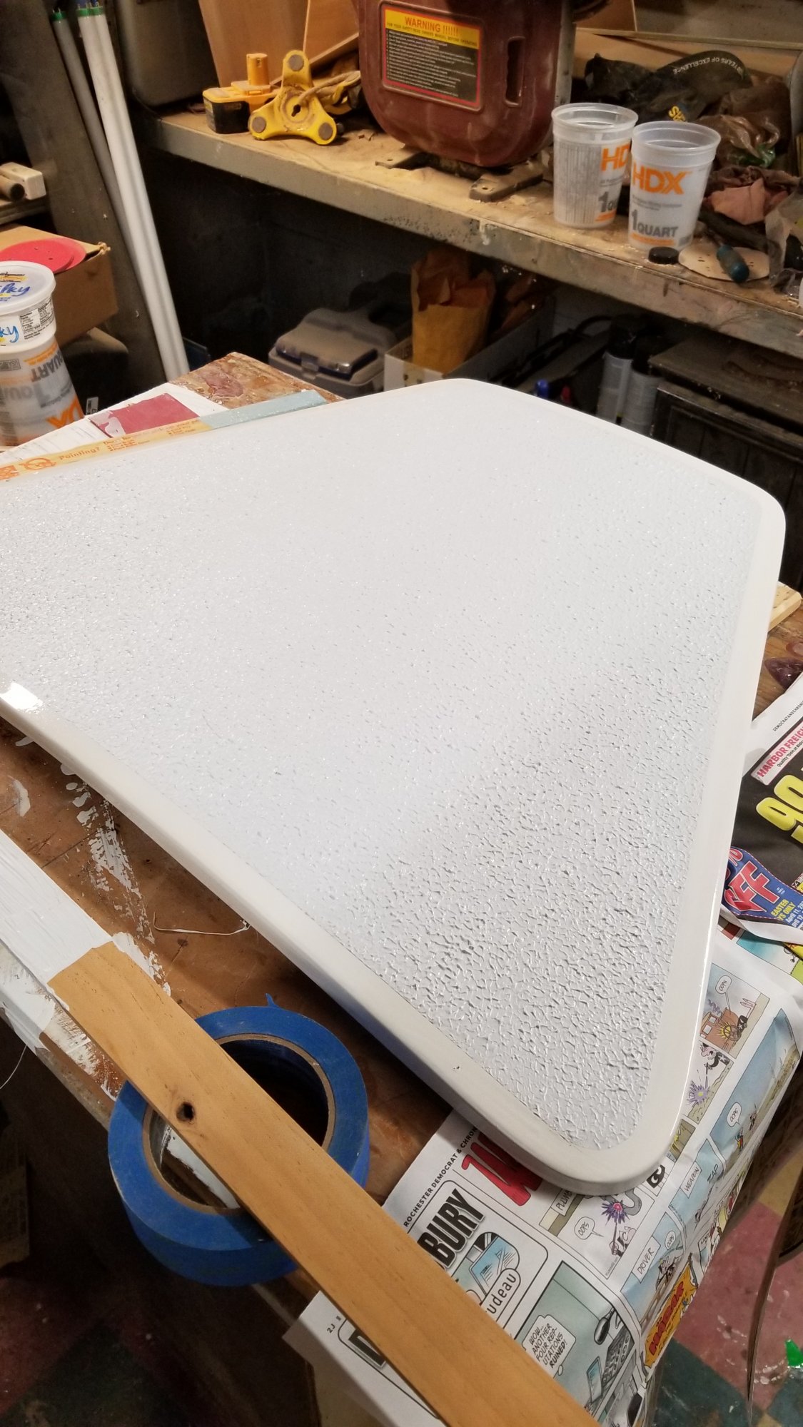

So I did a test run on the forward anchor hatch.
I only have a small Porter Cable compressor, so there is no way I could do anything larger than that.
Bought the cheap spray guns through E-Bay...doesn't matter the brand, they're no name, came with 3 different size guns
Sprayed the primer on after a meticulous sanding and wipe down. I used the EZ Pettit White Primer. No issues
Then 2 coats of Interlux Brightsides White. The first coat laid down perfect, very little sanding needed.
Next day did the 2nd coat in the morning, again no issues.
Now, that's not saying much since the only portion that will be visible is about a half an inch all around.
About 8 hours after the 2nd coat, I was able to tape off the 'good' stuff and then I used Kiwigrip for the texture.
I bought gray, but honestly it's not that gray and I am so happy with that.
It's the perfect contrast.

The prep is 98% so don't waste all that hard work on a single part paint. Interlux Perfection is a two part paint and is geared to DIY's. It holds up amazingly well compared to single part paints.

Yeah, I was nervous about which paint to choose. Was between the single or two part. Seemed to be 50/50 when I searched, but it did say the 2 part was better long term. I just wasn't sure if I could mix properly and spray correctly. I thought it required a higher level of expertise.
Already bought the paint....lol, so we'll see! It'll have to be better than it is now after 40+ years.
