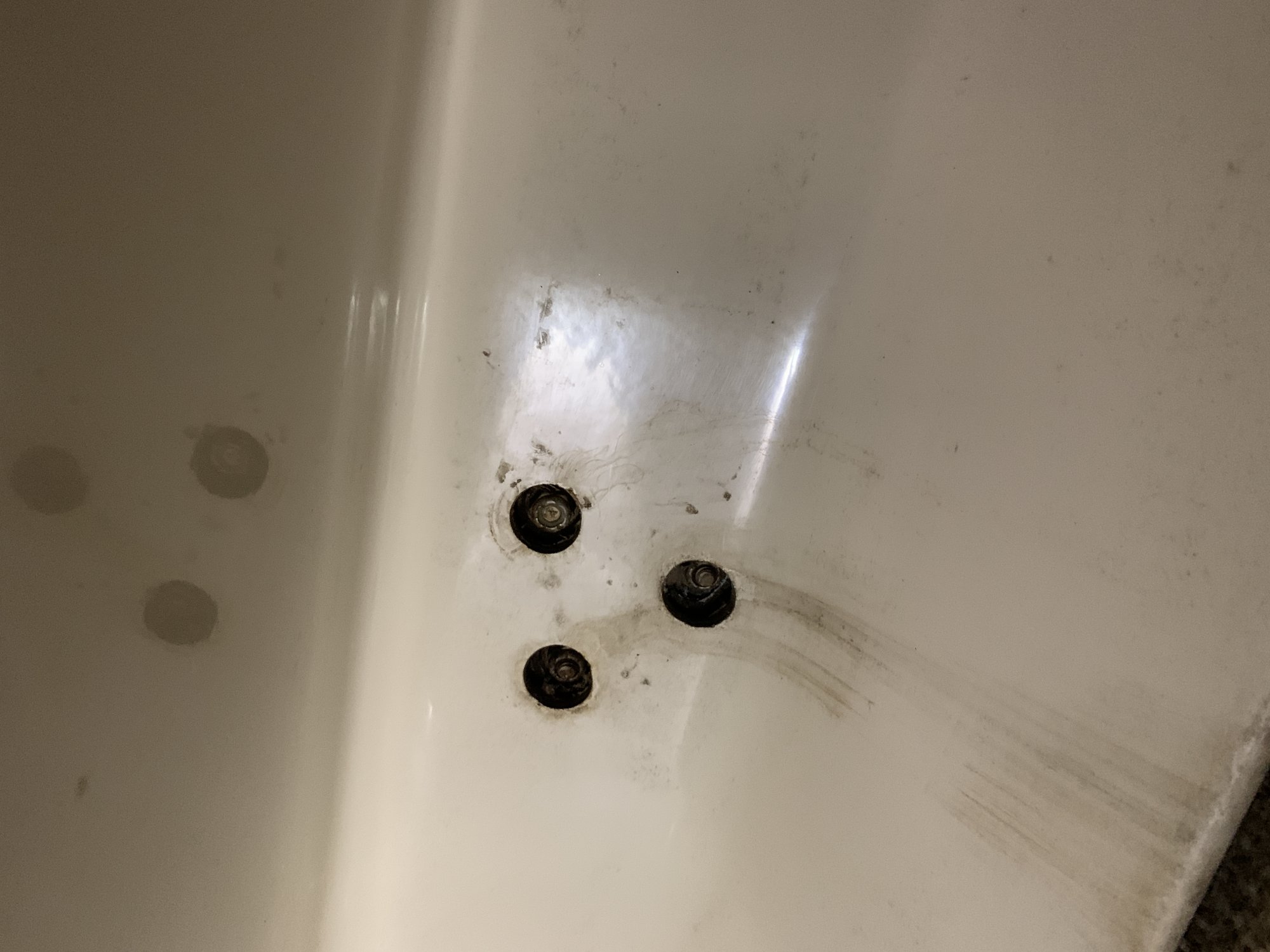

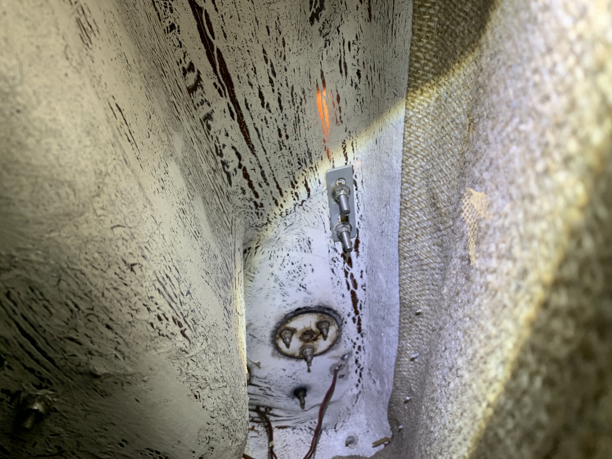

On my 25, the bow pulpit moves quite a bit, a lot more than I think it should. The bolts are tight, deck is sound but I wouldn't want to rely on holding on if I fell over. I did notice that someone put silicone on it to stop leaking. Last night there was some rain and today I could see water near the nuts underneath. So I know I got to get all the silicone off and use something better to bed it in with. Some form of buytl tape should work.
A couple questions:
(1) Can (should?) I cut the liner out around the 3 aft holes to be able to get in and put some sort of better size bolt and backing plate or is this a bad idea?
(2) For the forward holes, the plate is about 3" in diameter, is it worth it to put a bigger plate thicker and bigger on all the holes?
Thanks

I was quite surprised to find that the primary winches on my O’Day 322 had no backing plates…just washers (and not big ones). I added backing plates when I pulled the winches off to service them. One of them is accessed from the aft berth, where there is a hard liner. There is a 4” hole in the liner allowing access to the nuts under the winch, and there is a cover over the hole. You could do that to get better access.
But, I do think you are probably ok with washers and the other small backing plates that are there.
I would rebed with butyl tape, and if you think that there is any core damage/rot under any of these fittings, you need to do something about that. I had a void under a midship cleat, and I filled it with West Systems Six10 thickened epoxy in an applicator. Once it cured, I re-drilled the holes and all was well.

For the access for the bolts shown in the first photo, I enlarged those access holes so I could install the oversized washers. I found plastic plugs at the local Ace that fit the holes to dress them up when finished.
