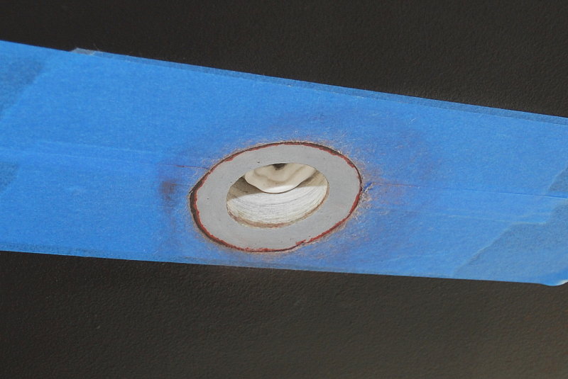

3) there was a gasket then 5200 on the throughull. (see pic). I did not expect to see a gasket there. but I guessing it was to fill in that tapered area. it would take quite a lot of sealant to try and fill otherwise.
4) the throughull itself in very good shape. no sigh of cracking or ware. just dirty.
So my plan it to get a new gaskets. and 4200. and re-bed the way it originally was. Gasket, then 4200... insert into hole. Another gasket on inside of hull and then the locking ring. As this worked well for ...years (at least 15) it should work again. Does this sound like a reasonable approach? Yes, I'll let the 4200 dry/cure at least a week (or two) before launch.
My only question is is it common to use both a gasket and sealant together??? I've always seen one or the other but not both. It looks like the sealant sealed between the gasket rough, tapered surface of the hull hole. And Not between the through-hull and the gasket.

That hole will need to be fixed as that is not a correct shape hole for a mushroom/flange headed thru-hull fitting. I suspect that hole was for a flush mounted seacock and someone hacked jobbed it for a speed log. A very poor choice and potentially boat sinking unsafe practice.
I would also avoid re-using that thru-hull fitting. With the model# of the transducer, usually shrink wrapped to the cable, a new thru-hull can be purchased easily. They range form a low of about $30.00 to upwars of $70.00 +/- depending upon the transducer model. OK maybe not so easily for a DIY, because the distributor is generally wholesale/trade only, but any competent marine vendor should know exactly where to get one and can order one for you. If you have trouble with this PM me. The shape of the flange on the thru-hull is what makes the seal. It is concave and traps sealant thus creating the seal. Your screw driver has marred that surface now making the thru-hull pretty unsuitable for re-use..
Your hole should look like this when done correctly. All the bottom paint needs to be clear of the bonding area of the thru-hull fitting. If you are not competent with glass work, eg: taper repairs, please bring in someone who is.
This concave shape is what traps the sealant and creates the seal. It needs to be clean, mar free and the hole needs to be 90 degrees to the hull, be properly sized for the thru-hull, and no-bevel deeper than about 1/16"...
8,050
Beneteau 323 Annapolis MD
You really should not have a gasket (what's it made of?), but you have to deal with what was handed to you. Most gasket material will shrink or drot of old age, and maybe that is the cause of your trickle. On the inside you should have a washer to fit the thruhull, and preferable a larger backing plate.
