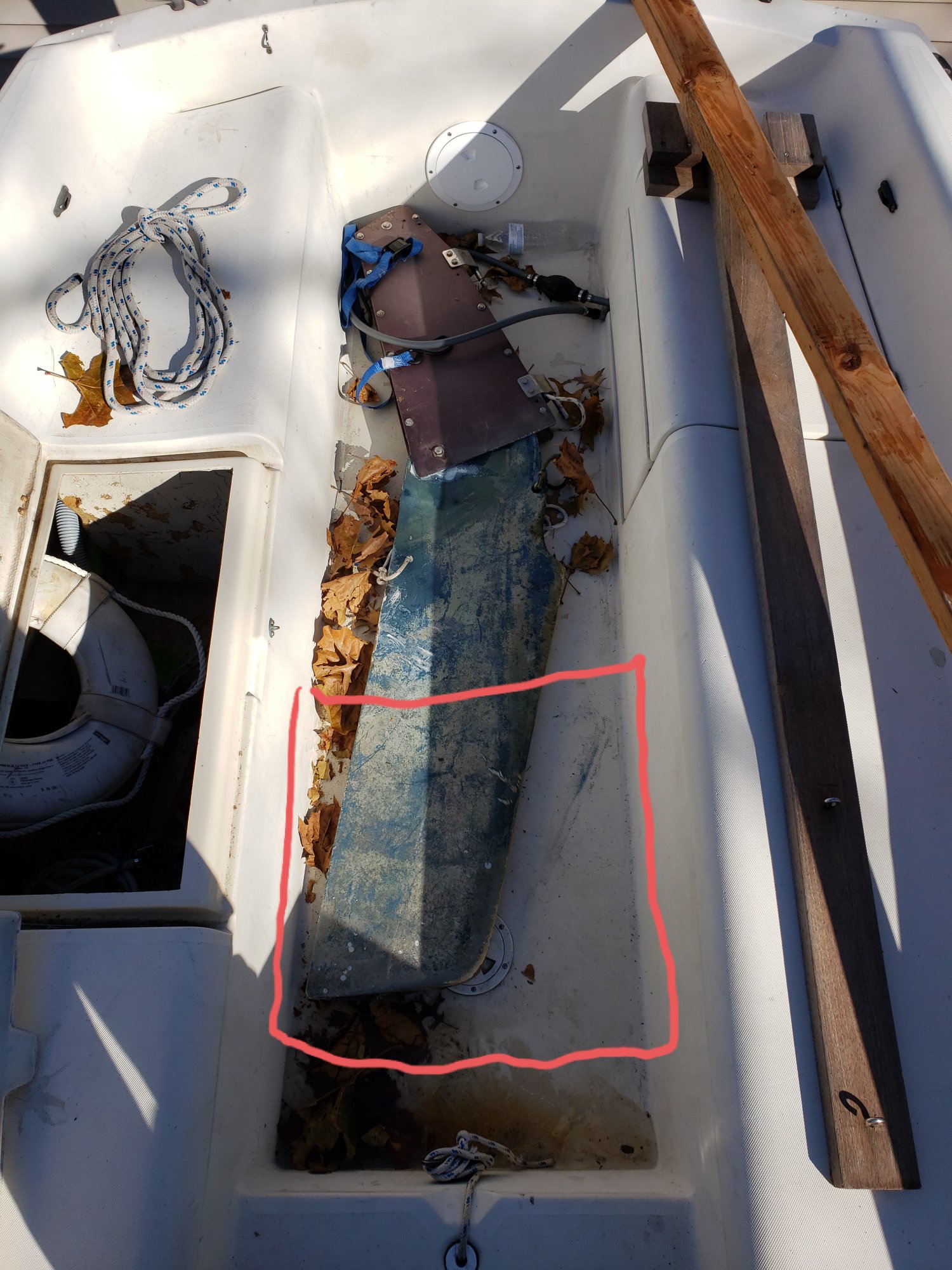

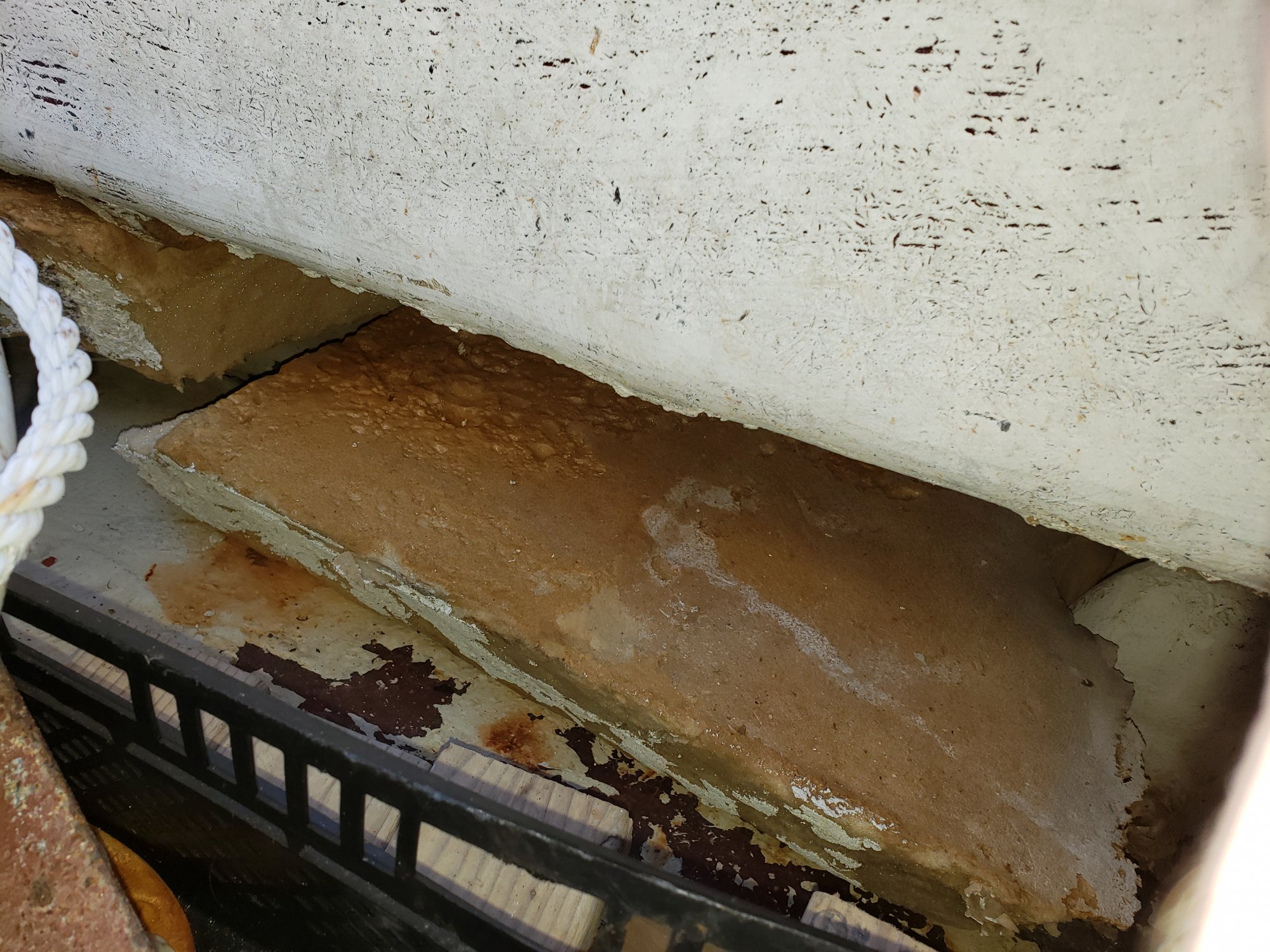

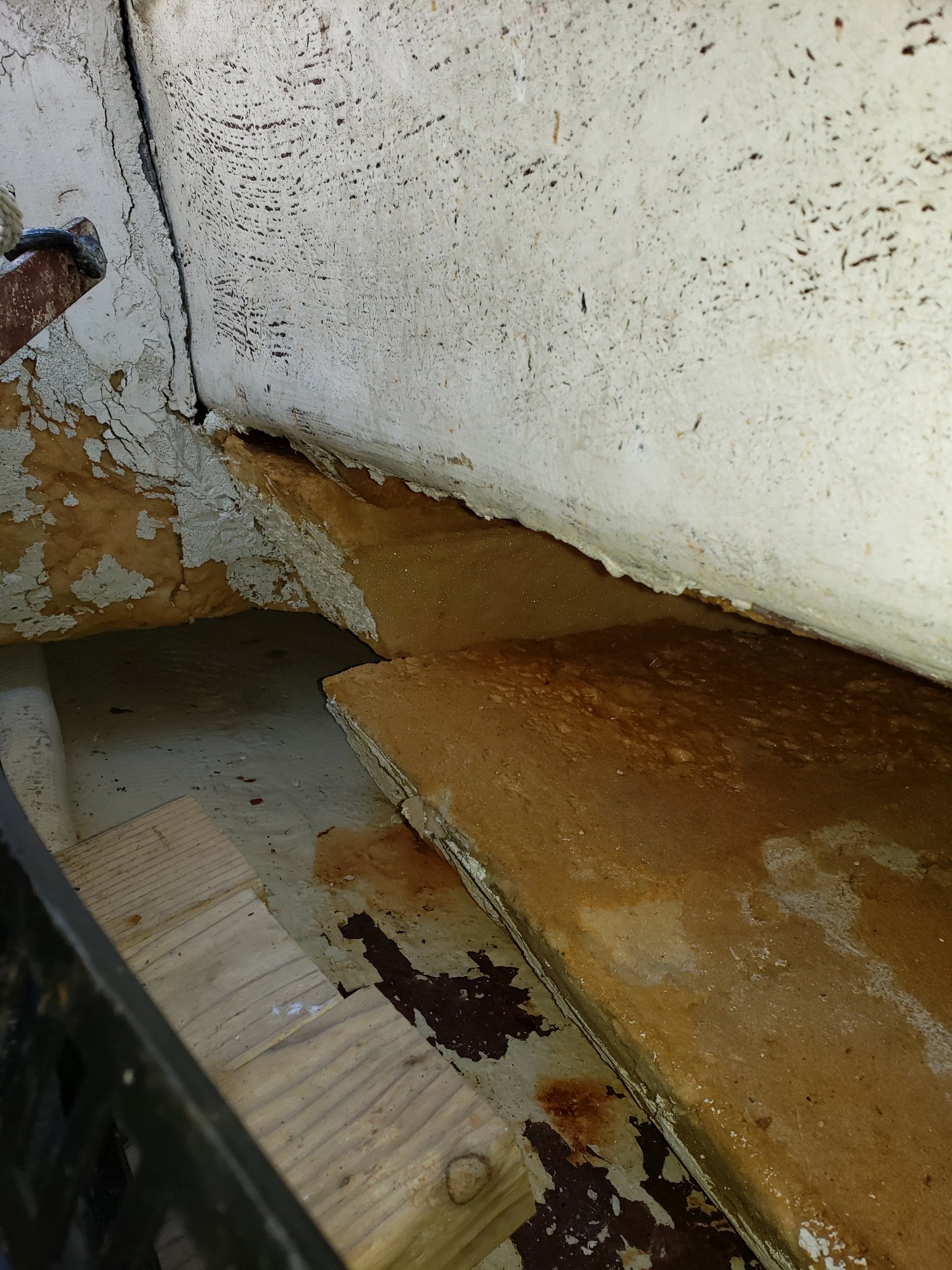

John, Hunter, thanks. I just assumed it was some standard type of foam, but thinking about it, it makes sense it could be varied. I just took the opportunity to go outside and take the tarp off the boat that I've already got a replacement for and pull a few pieces of trim off that I am going to refinish and take a couple of photos of the foam area I'm talking about. Thanks for the inspiration to stop procrastinating!
Here are the photos. The one from above indicates the area in the cockpit where the foam was attached.

Not sure about the purpose of the foam, other than possible some floatation. It looks like it is aged and has been covered with paint. Not sure if it is still working as initially intended. If I was going to reattach it to the underside of the cockpit, I would choose a water resistant adhesive.
That center cockpit access port, it may be the source of water that worked it's way between the foam and the underside of the cockpit releasing it and causing your concern.
What happens if you remove the foam? Should you replace the foam with new material? Which ever way I chose, I would reseal the opening in the cockpit.
To get a solid surface to reattach the foam, I am guessing you will need to clean and like sand the underside of the cockpit. It looks like a space that would attack mold and gunk between the foam and the fiberglass. Bad news... looks like not a lot of space within which to work.

John, you're right on about the access port leaking. There is no gasket there and I'm sure the sealant is non-existent. I already have a replacement in hand which will go in this spring. I can't remove the foam as there isn't enough clearance. I just want to keep it out of the bilge water. I'm thinking gorilla glue might be the best thing if I can wedge a board under it to lever it against the plywood hard enough.
