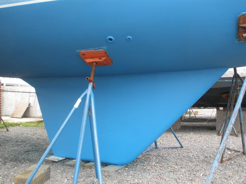

I found what appeared to be a real bad hunter smile. See Pictures they tell the rest of the two thousand words I could write. How bad is this.. not that I already haven't that out... but what should I do put fiberglass over it? Inside Everything looks OK where the keel bolts are attached in the cabin. Any thoughts or ideas would be appreciated. Thanks.. Jon
I would first ask the actual dimension between the fiberglas keel stub and the top of the cast iron keel itself. From my experience with '80's vintage Hunters, I'd estiimate the keel stub extends down about 4"-5" from the hull and the joint to the top of the cast iron keel should have been about 1/4" It's likely the original joint was filled with 5200, and the previous owner might have 'faired in' the keel joint with something like Marinetex or other epoxy filler. The actual internal joint is hard to see, but if it is no more than 3/8' and everything else is tight, it should not be a big deal to repair. The vertical surface of the keel and underside of hull seems to have been scraped or sand blasted to bare gel coat and the gel coat completely removed from a good portion of the top of the cast iron keel. Does the aft end of the keel show any similar separation? If not, 90% of the keel looks like it may still be tightly bolted and bonded to the hull aft of this joint with 5200 and fairing compound.
I'd start by using 60-80 grit sand paper and possibly a Dremel tool to clean out the two surfaces, the fiberglass portion of the underside of the keel stub and the top of the cast iron keel. Then measure the joint. if the actual clearance is 3/8"or less, I'd fill it with 5200. You may want to start by fairing in or replacing the gel coat to the original profile. I'd rebuild the missing gel coat with MarineTex, Then re-fill the joint with successive caulking gun applications of 5200. I've typically been successfull in replacing a 1/4" joint in one pass. However, I'd let it set up and re-apply 5200 untill you can 'trowel' a flush joint of the 5200 at the re-built surface of the gel coat. As another option you could use fiberglas cloth and West System epoxy to 'bond' the cast iron keel to the fiberglass keel stub, but the joint was originally intended to be a soft joint to provide minor movement.

OK, the cast iron on the keel goes up to meet the hull at the top.. Note the "flange" looking semicircles aft along the keel/hull joint. Those are cast-in ears that stick out of the cast iron and bolt into recesses in the hull.. That front gouge is a cut through the cast iron of the keel.. cast iron above and below the cut.. Structurally, I don't think there is a big problem as long as there are no cracks leading aft at the forward end of the gouge in the iron, as I noted in my previous post. There is a lot of meat left to take the loads and the center of effort is aft of the gouge.. If one were to hit a rock hard while going forward, it may be possible to initiate a crack in the gouge .. If one were concerned, a strap could be fabricated and bolted to the cast iron into drilled and tapped holes above and below the gouge on the leading edge. That would mechanically connect the leading edge so that the forward mount bolts could better take the load of smacking a rock at speed without initiating a crack. I wouldn't even begin to consider scrapping the boat. Yes that is some ugly damage, but it looks worse than it actually is ..

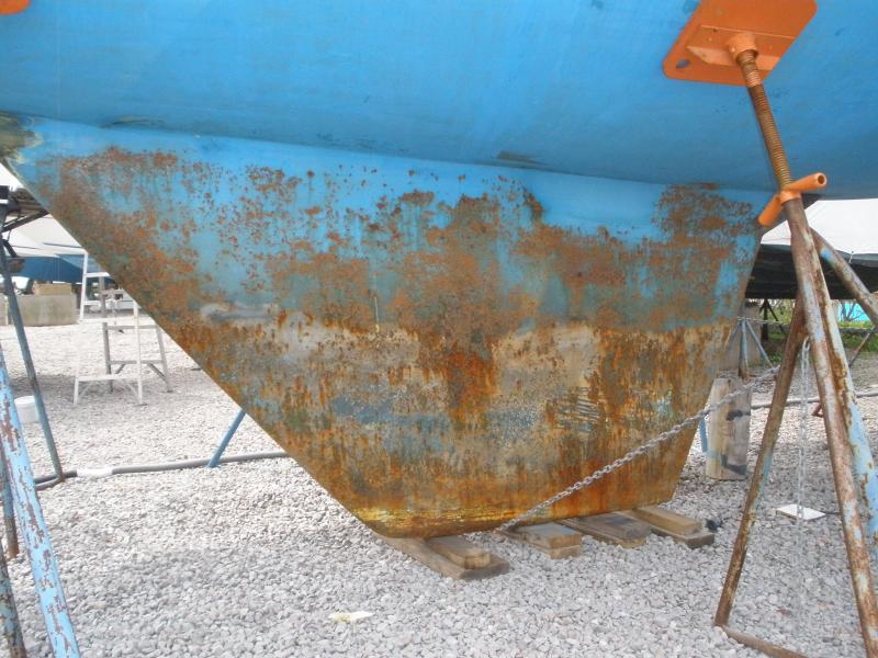

I thought I would post what the keel looked like before the reveal and after.
Nick, yes the boat is in Safe Harbor, go past the office then almost all the way down. make a left and it's the first boat by the gate that opens to the back road. Her bow is pointing to the bathroom & Laundry room.
Going aft, it appears to be OK, no other cracks. I'll have a better idea when we really clean it out. Whatever was between the keel and the fiberglass is now mush. It almost looks like wood gone bad.

Getting rid of the boat because of that??? C'mon, that's ridiculous.
From what can be seen on pictures damage really is not that bad, above the cut it is fiberglass from the hull and below it is the cast iron keel. This part has absolutly no structural role to it, you could cut away the keel in front of the flanges and it would be just as strong.
Inspect for related damages (removing all paint, loose gelcoat, keel flanges, bolts & plate, etc), but chances are that the groove was made by friction and not a choc load, so hopefully the rest will be unafected. The thin groove behind the large one is normal and not due to damage. Just rebuild the fiberglass of the hull (it might just be thick resin/compound in that corner, and no actual fiberglass) and fill the empty space with epoxy, leaving a gap to be filled by 5200. It appear to be very common on those H34 to develop crack in this exact spot if the gap between keel & hull is filled with rigid material.

don't worry about it too much, mine was vey similar 14 years ago when I bought mine. there's allot of movement of the keel at each end and most epoxy jobs cant flex enough to keep up and eventually crack open and fall out of the groove around the keel. the quick cheap and easy method is filling up the area with a moldable marine epoxy stick after cleaning all the rust up. than cover the area up with west system 6x10 which can handle the flexing better than plain epoxy. just paint and go. the best fix is to bead blast the whole keel down to bare metal and do over the whole seam around the keel with west 6x10. then coat keel with por15 and paint. the keel will look brand new after this and be stiffer. the only thing better is to include the hull and barrier coat the whole bottom and keel together as one piece. that's been too expensive for me up to now, but maybe one day. once you seal the keel up it last several seasons with just minor touchup. welcome to the club...

The fibreglass part is the sump for the shower inside the boat.
The gap is the same on every 34. Its just filled with body filler normally but with corrosion of the keel the body filler can come loose. Its not structural and not suppossed to add any strength as the keel is held on by big bolts through 4 flange plates further back.
Mine had a line across but the filler was well bonded to the fibreglass.
I would suggest cleaning the rust off as much as possible with an angle grinder then paint the keel with zinc rich paint. grind off again so you leave the zinc in the crevices but the rest of the keel is clean. Coat with 2 coats of west epoxy to both the keel and the grp. Then fill the gap with 5200 sealant to provide a flexible seal.
Worked on mine 8 years ago and no problems since.

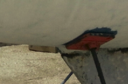

There were a number of comments regarding the size of the opening so I wanted to upload this picture showing the opening and a tape measure....
I wonder if the Keel bolts are fully tightened....
Nov 6, 2006
9,894
PGIJon, your original post picture looks like the gouge is about 4-6 inches below that 1/4" gap that really is the gap under the shower area. The gap in the original post looks like it is an inch or more across?? is that the same gap that we are discussing?
