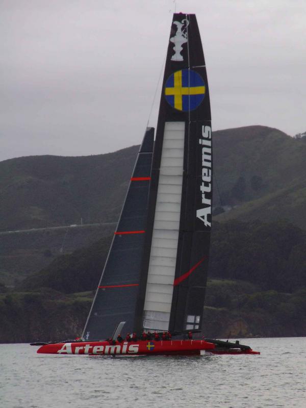

Couldn't help but notice the very pronounced draft stripes on the two head sails.
Per the pictures.
I wonder if the highly visible color and size is so sail trim can be observed by the support team from afar and then the info radioed to the skipper? And/or is useful for the post practice video review?

Could also be 'air battens' as well, dunno as its just a guess.
Im thinking of changing from aux. battens on my sport boat's jib (enhanced 'leech roach') to air battens for better shape control .... just as soon as the class rules allow it. Jib air battens are starting to become quite evident on some 'open development' classes.
The different 'thicknesses' seem to indicate that it would be easier for the 'bowman' to simply look up and compare ... the 'widest top batten/stripe', the somewhat wider mid-batten/stripe, etc. would probably 'seem' optically/visually to be the same width when seen from directly below hence a more precise visual comparison of all three simultaneously.

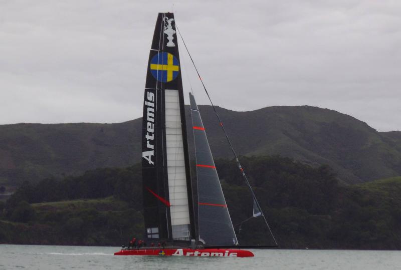

I just looked at some of the other AC72 pictures I took yesterday and found the one below -- the genoa definitely is being furled (or unfurled).
Interestingly on the other pictures of when the boat is sailing with the smaller jib, I can't see any evidence of the furled genoa. Appears that the genoa/furler/stay is detached from the bow-sprit and stowed against the mast?

I'm pretty sure that a AC72s have on-board video cameras at deck level looking upwards and recording the sail shape anytime they are under way.. they review that with wind and boat data to optimize shape & speed.
Its been some time since I had any connection with AC, etc. boats ... but it has been strictly illegal for a boat to be 'coached' by any means than other than ON THE BOAT. Such discussions have always been in regard to 'only fair means to sail a boat' .... otherwise the one who can buy the most sophisticated computer, etc. will always win and thats not sailing but 'gizmo' usage in the eyes of the 'purists'.
Not really a genoa.... rather an off wind sail, such as an asymetrical spinnaker, code zero, etc.. They are all carried on wire luff, detachable furlers. These are multihull boats, remember, with much smaller number of crew than the old monohulls.
