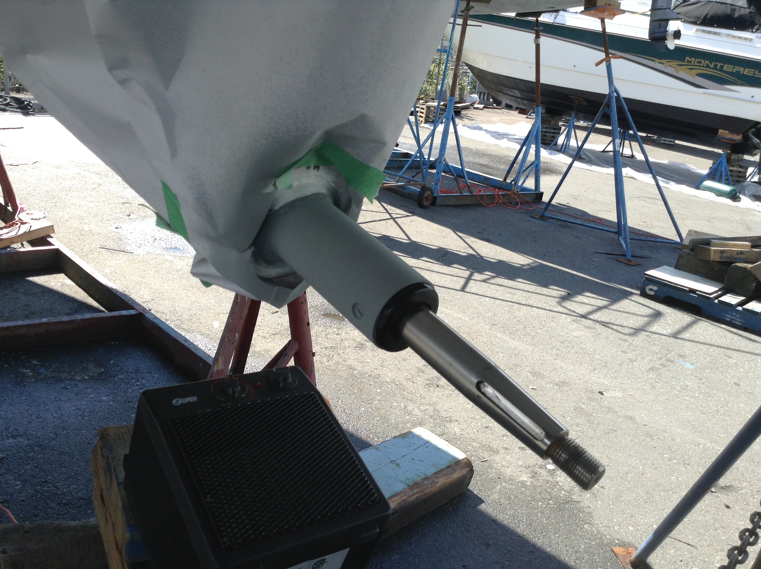

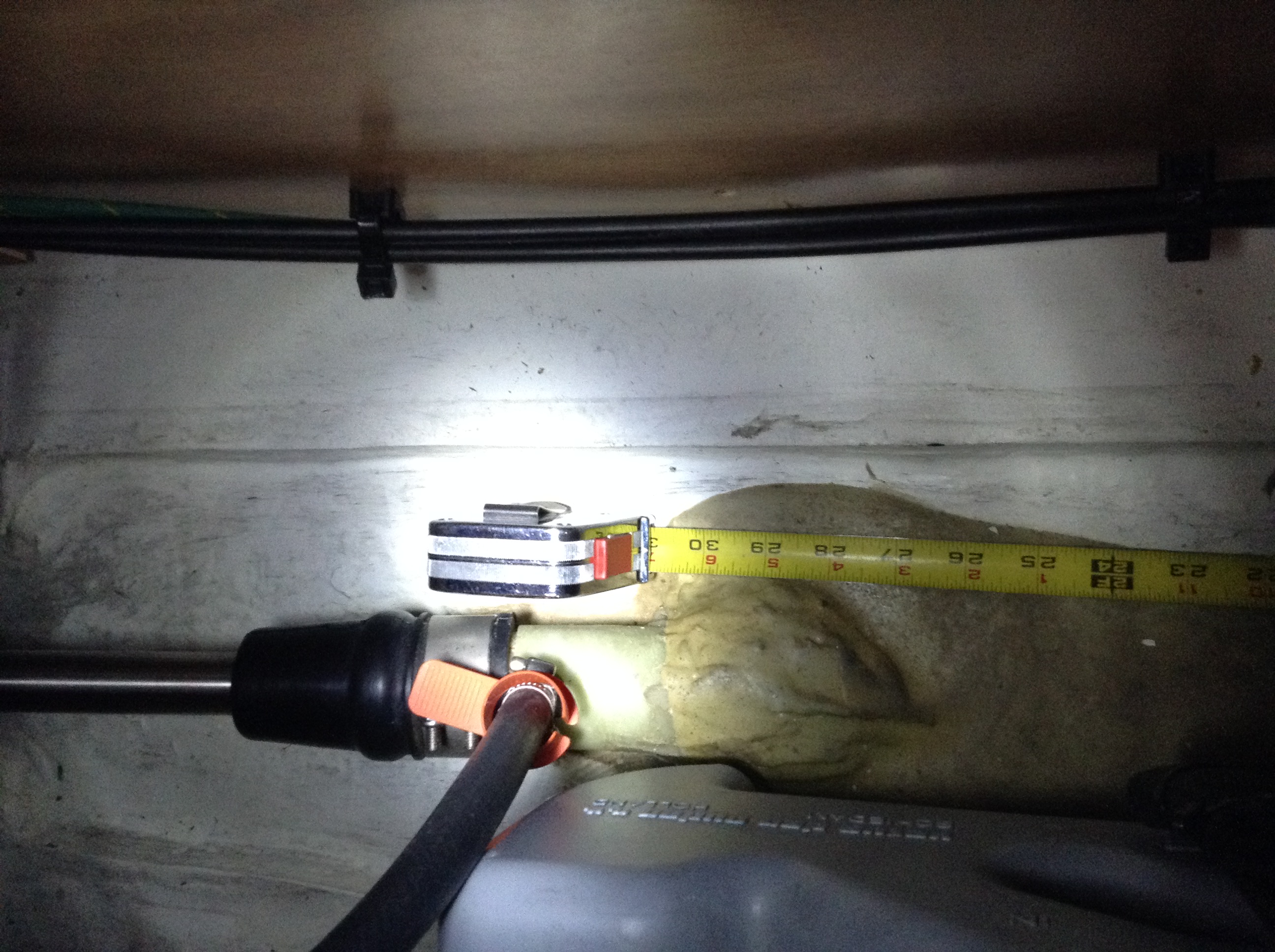

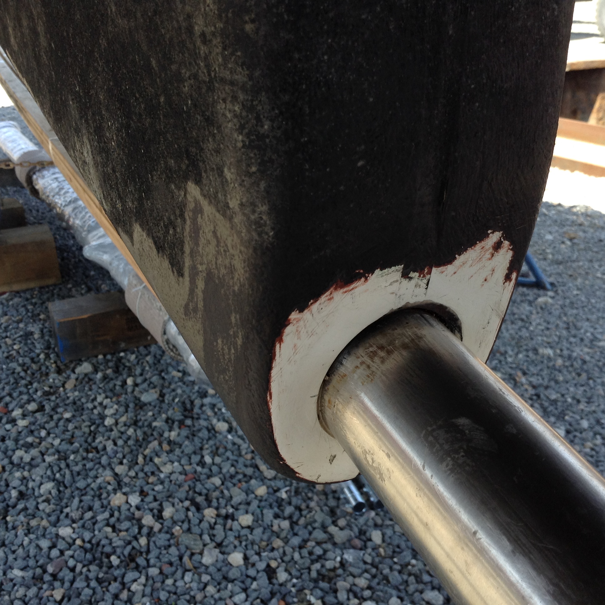

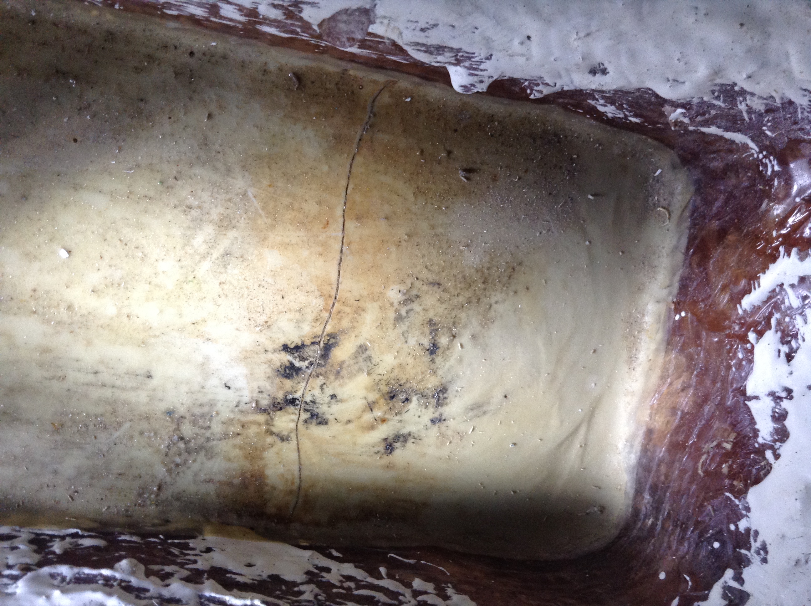

4 litres/day is a lot of water, but it is possible that this water ingress is through a broken flexible seal around SST stern tube. I think that this tube inside the skeg is only few inches long and is connected to fiberglass stern tube inside the boat where Volvo drip-less shaft seal is attached.
During construction, they pour polyester resin into cavity of the skeg and large volume of resin contracts during curing process creating small cracks. This is not a serious issue, but when seal orotund SST stern tube is leaking, water migrates through the cracks in the resin, collects under Volvo seal then flows forward toward the engine.
When I purchased my B-31 in 2015 I noticed crack and small amount of water in resin filling the skeg. After cleaning SST tube/skeg and applying polysulfide seal I don't see any water inside.
I would not use epoxi resin to seal SST tube to the skeg. Stern tube is vibrating with rotating shaft and flexible transition is probably better and easily to repair if things go wrong. Some older Beneteaus had outside stern tubes made of fiberglass glassed to the skeg. They changed design for a reason.
Attached pics shows my boat: SST stern tube without seal, stern tube with seal and in the process of painting, crack in the skeg resin, fiberglass stern tube with Volva seal. Measuring tape shows distance of crack to Volvo seal.
That is exactly what happened to mine. However I disagree with your repair ,mine is a fiberglass tube. They were changed to S/S after complaints from Moorings. Renters towing dinghy's had ropes wrap around props snapping the tube ,thus the change to S/S. The tube holds your cutlass and alignment of the shaft and the torque of your prop. Using polysulfide ,thou stopping the water is allowing the tube to vibrate and flex and thru constant flexing and will in time lead to failure.
Beneteau made it solid in the first place with polyester resin. I,m actually going to give it a good outside rad with mat and epoxy resin making it stronger.

Mechone,
I have seen Beneteau with fiberglass stern tube attached and sealed to the skeg with hard resin. Obviously this works and you should follow this concept.
However, the tube extends from the skeg at least 6" and if demaged by a floating log or a crab trap rope, it could be more difficult/expensive to repair than SST tube fitted in a the skeg and sealed with flexible compound. I expect that this were reasons for design change. Some other than Beneteau sailboats equipped with SST external stern tube are also sealed with flex caulk. Good luck with your project.

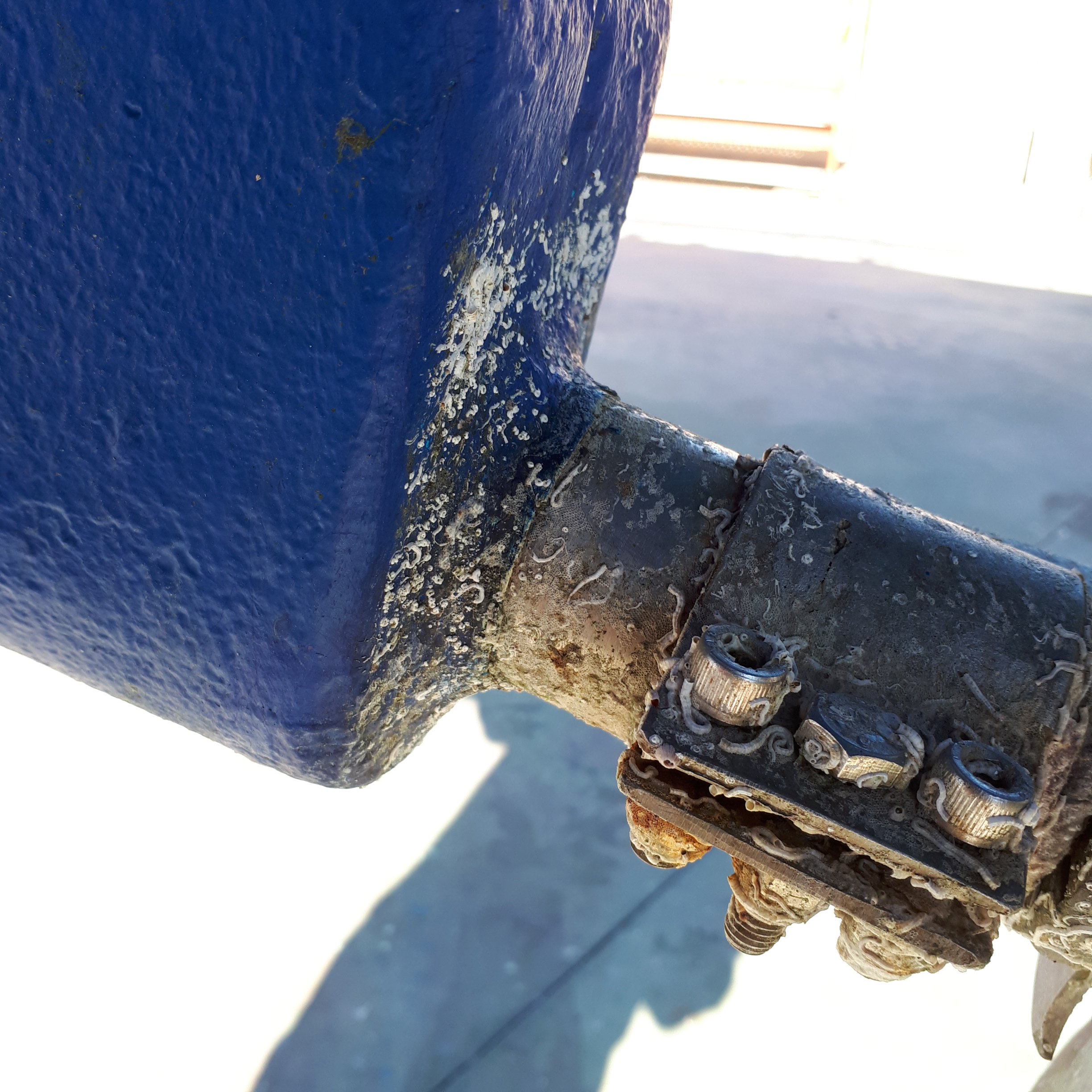

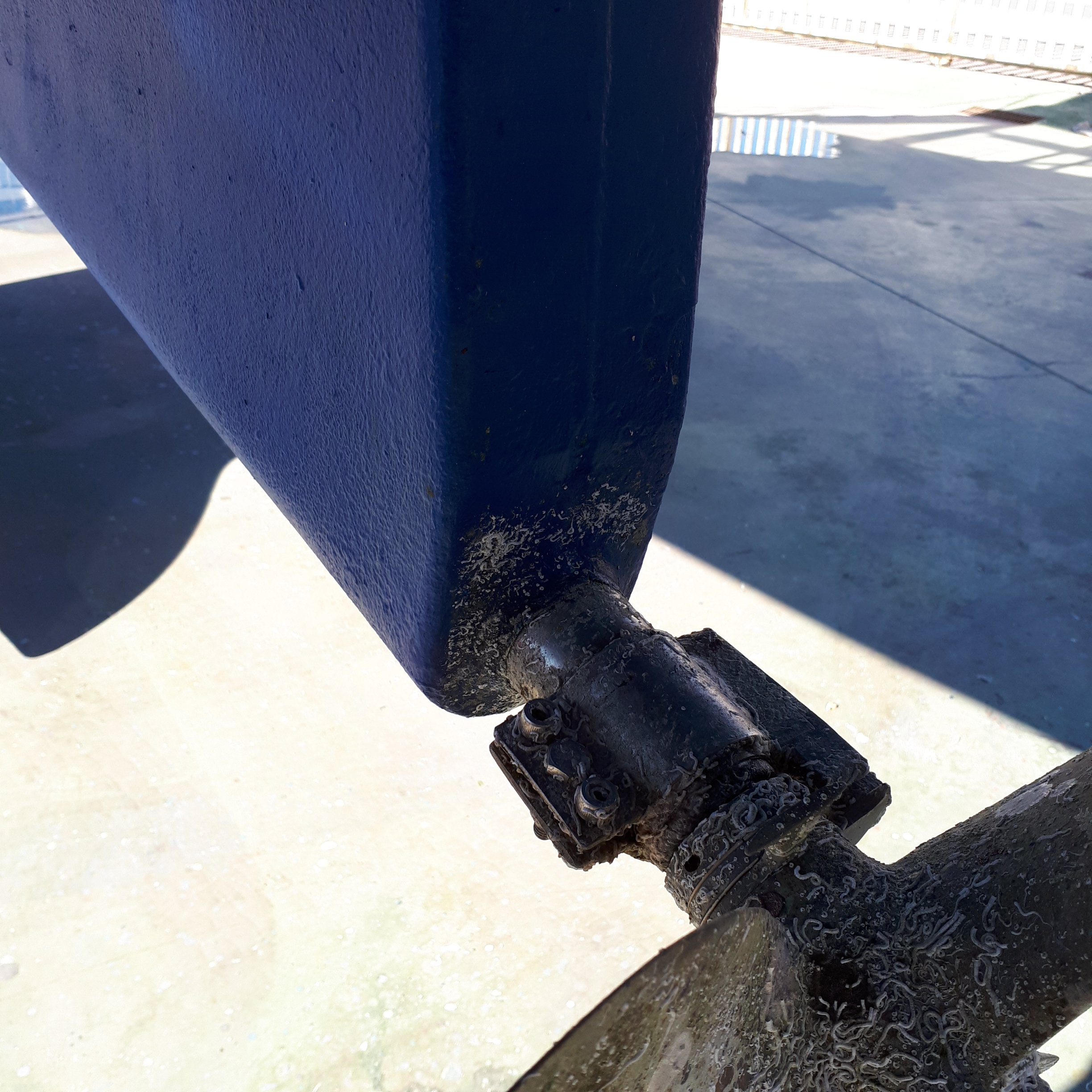

Hi guys thanks for your help up to now. The good news is I've found the leak! It is around the shaft as mentioned above. FYI, I found leak by getting different coloured food dyes, and had a diver friend squirt this with a syringe around the suspect areas. Detected this in internal leak area behind shaft. Boat now on hardstand, and water now dripping from skeg where shaft enters. My problem is that its in Spain, a marina with little local expertise, so need advice please as to exactly what to do. 20171202_140729.jpg 20171202_140729.jpg 20171202_140722.jpg
Gunni
Mar 16, 2010
5,937
That shaft brace device indicates that some kind of repair has been effected on the propeller shaft. It was not original. Have it removed and the shaft tube cleaned back to the strut body. The strut body is solid composite and not easily damaged but that shaft tube could be cracked or separated from the strut body. The repair would require the services of a skilled composites technician. Be a good time to have the shaft removed and checked for true. Work with Beneteau FR to assess the situation.
