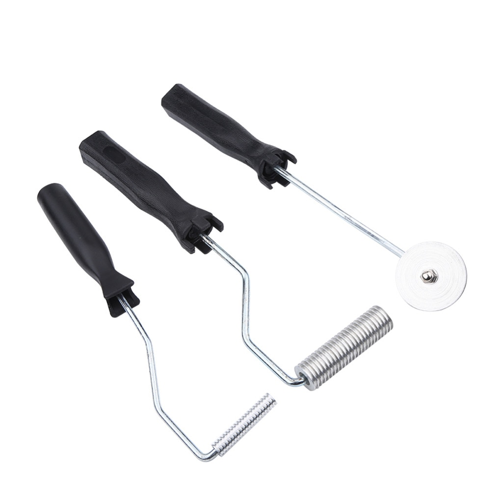

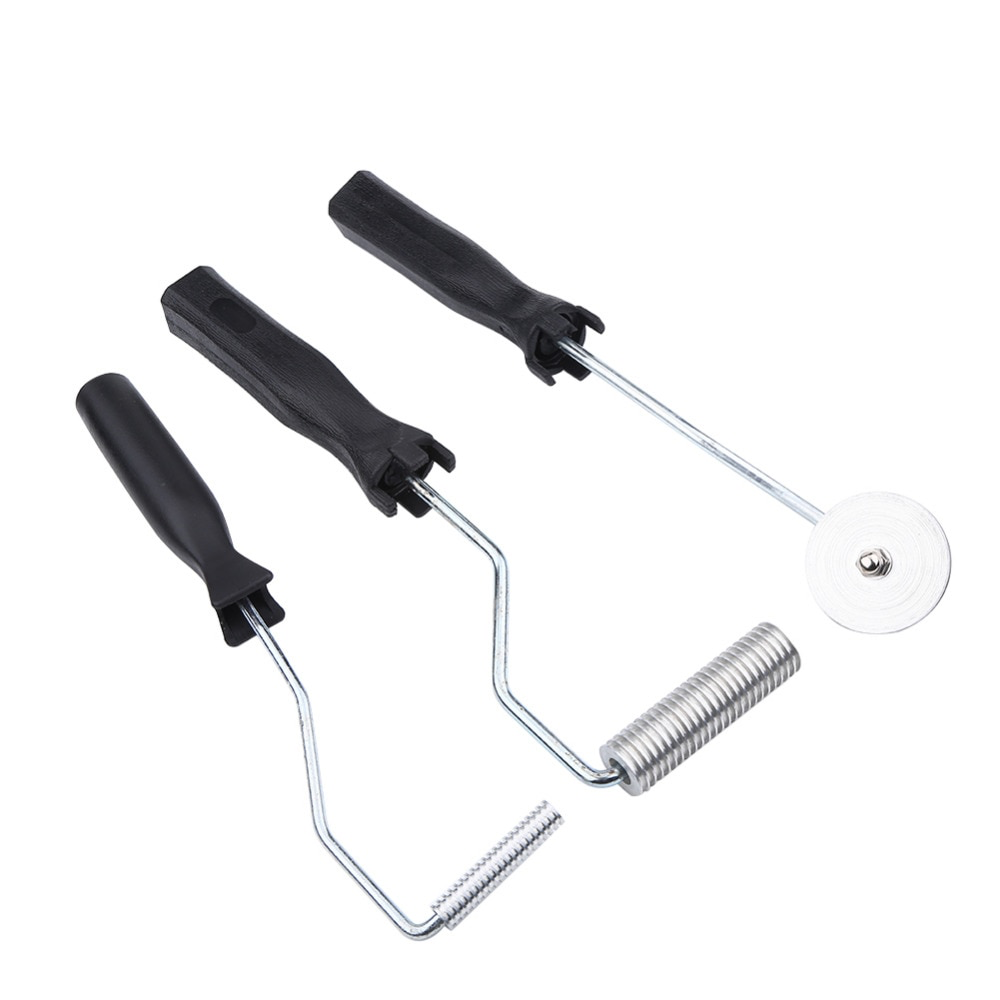

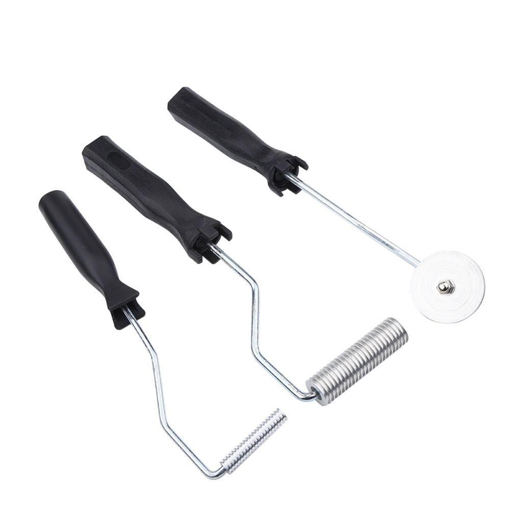

You need to pour the resin onto the material. Then dab the cloth with a chip brush to push the resin into the weave. Next roll the cloth with a small metal roller to squeeze the resin through the cloth and roll out any air bubbles. This process will saturate the cloth and force resin around the fibers.

In the past I've mixed up some resin, submerged the 1708 and then placed it onto the boat. I think your suggestion with the roller will definitely help. I've that the rollers get messy very quickly when used on bare fiberglass. I've also found that it likes to pull up the cloth/mat. What's the secret to proper use? Spray it with a release agent? Put a piece of thin plastic over the fiberglass while rolling out?
24,760
Roll from the center to the ends. Not back and forth.
Do not over roll.
No on the release agent will contaminate your layers.
No on the plastic will just be a mess on a mess
Just get in there before the resin starts to kick. Do the roll and let it sit to kick.
Clean up the roller immediately before the resin kicks.

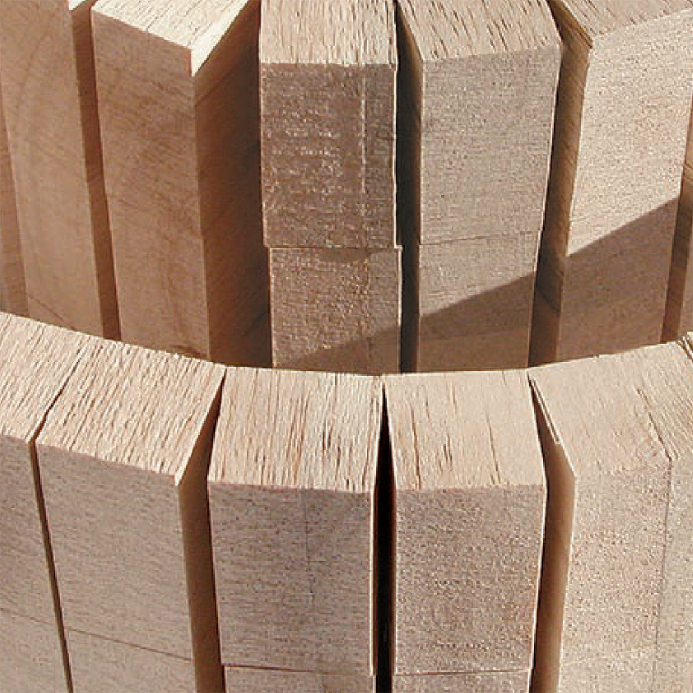

Balsa for cores:Jamestown Distributors
  • End grain.
  • Kerfed and attached to flexible backing.
Notice that the balsa is in finite squares. There are flat spots. You MUST use thickened adhesive to fill the gaps when installing. Otherwise it will not be well bonded, and it may fall on you.
Thickener is a vital part of these jobs, as is learning how much is enough. Do not over thicken; thick ketsup is about right to start.

Ahhh I did not realize that the balsa is attached to a flexible backing. That should make it much easier to install. I'm guessing the end grain absorbs the epoxy and results in a stronger bond?

Yes. The but the real reason for end grain is high compressive strength (balsa is hell weak the other way) and high shear strength (balsa and most woods are weak the other way). The purpose of the core is NOT to carry the flexation load, but to keep the two skins in precise location relative to each other, and transfer vertical compression and horizontal sheer loads. It is actually STRONGER than plywood when used this way. Many users don't get this part of the engineering, and think plywood is a good core. it is a terrible core.
The only real weakness of end grain balsa as a core is rot. You must keep it dry.

This is the image of the balsa from Jamestown's website. It looks like there's little to no kerf/space between the blocks so the flexible backing would have to face down. In a perfect world the balsa would conform to the curve of the deck and stay like that while I coat it in resin and fill in the spaces between the blocks. In reality, those blocks are going to lose the deck shape in the process. When the blocks are pushed together (straightened out) some filler between them will ooze out. With less filler between them, there will be a void when spread apart to match the deck shape. What's the best way to avoid this issue? Work in small sections? Do a row or two of blocks at a time?

That's why you use resin that isn't too thick. Fluid resin WILL fill the spaces between the blocks of balsa and soak a bit into the wood. This is good because it closes off potential paths for any water that might leak in later. When you remove the rotted core you will likely find the skeletal remains of the resin that filled in between the blocks when the original deck was laid, sticking out from the underside of the deck. You will have to grind/sand these down so the new balsa can conform to the underside smoothly.
