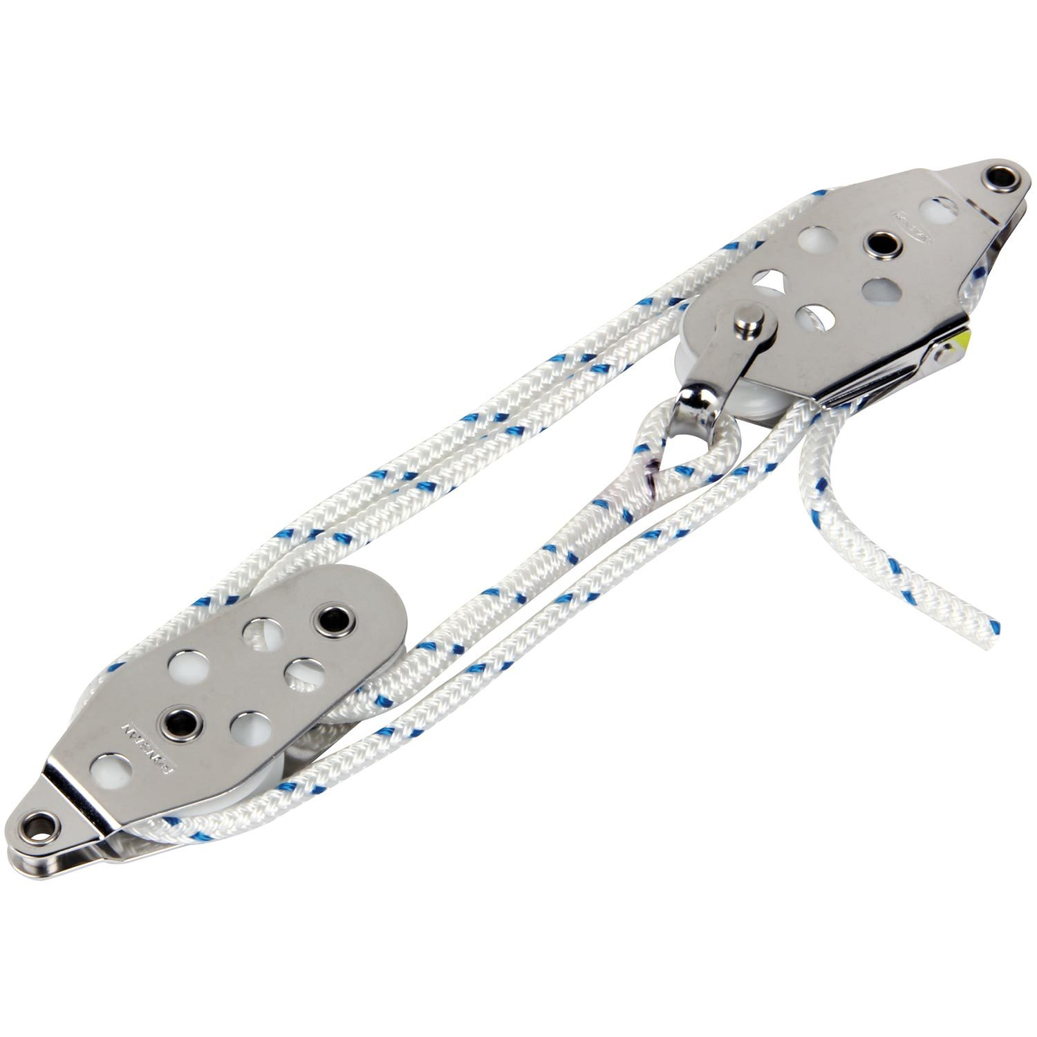

This is the one I have on my H26. Very important when sailing down wind to have some tension on the vang. I loosen mine when working to windward.

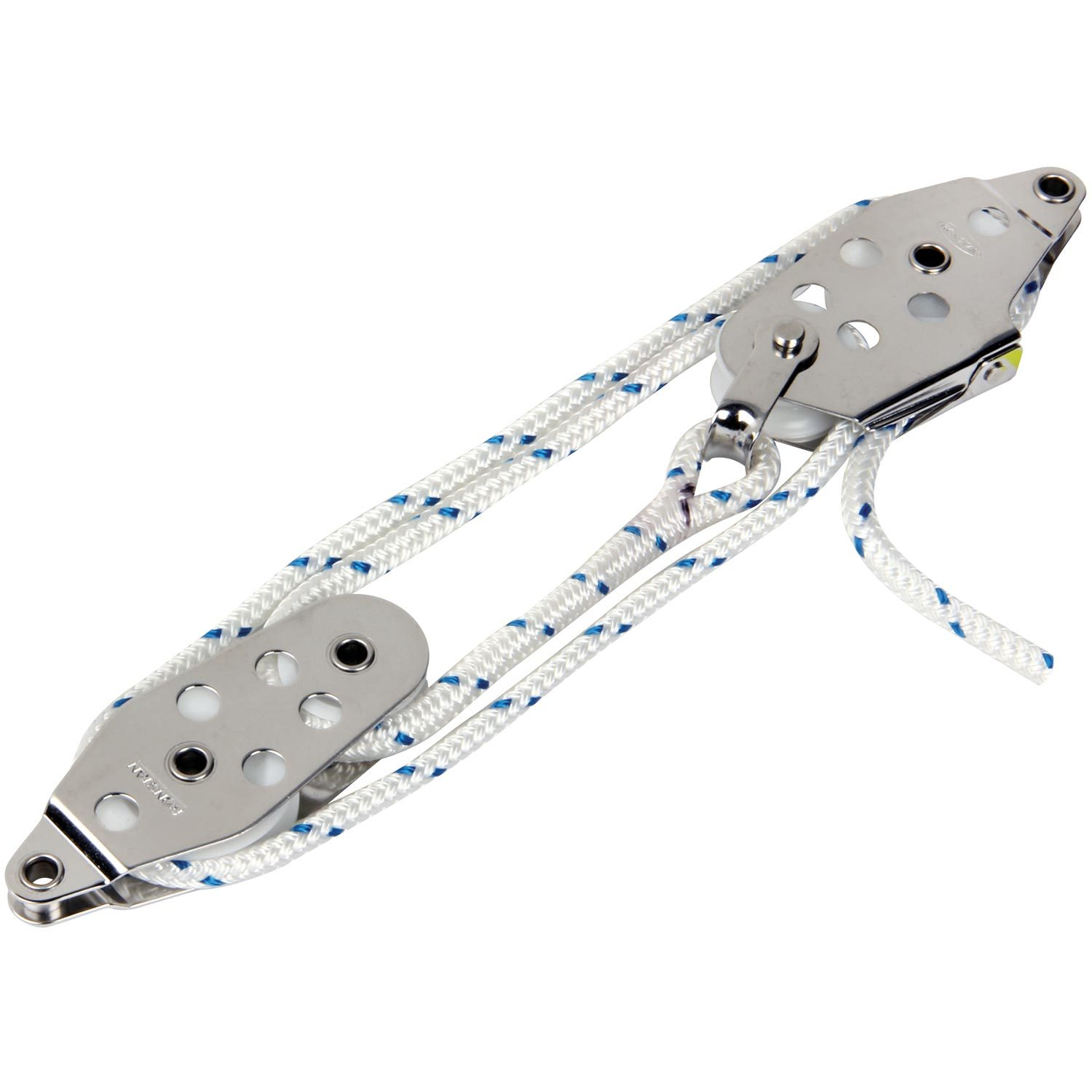

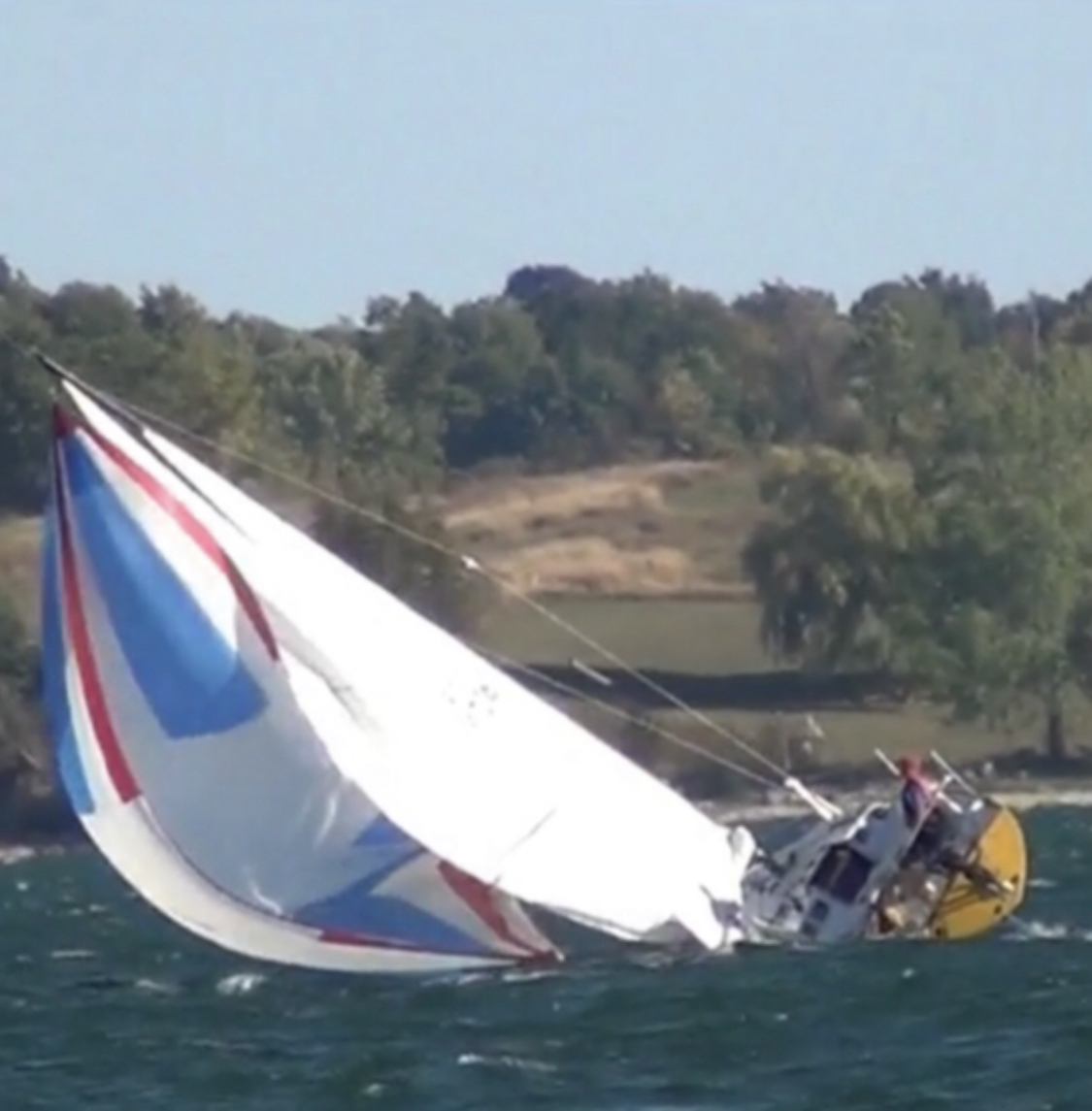

On a downwind leg the fastest way to get a boat back on its feet during a broach is to blow the vang. This causes the boom to immediately rise and depower allowing the boat to come upright.
When going upwind or on a beam reach dumping the traveller will also depower the main and allow the boat to come back up.
Releasing the main on a reach will do the same, depower the main, however there is a lot mainsheet that needs to run free and be taken back in. Downwind releasing the main doesn't do much as the sail is already out.
