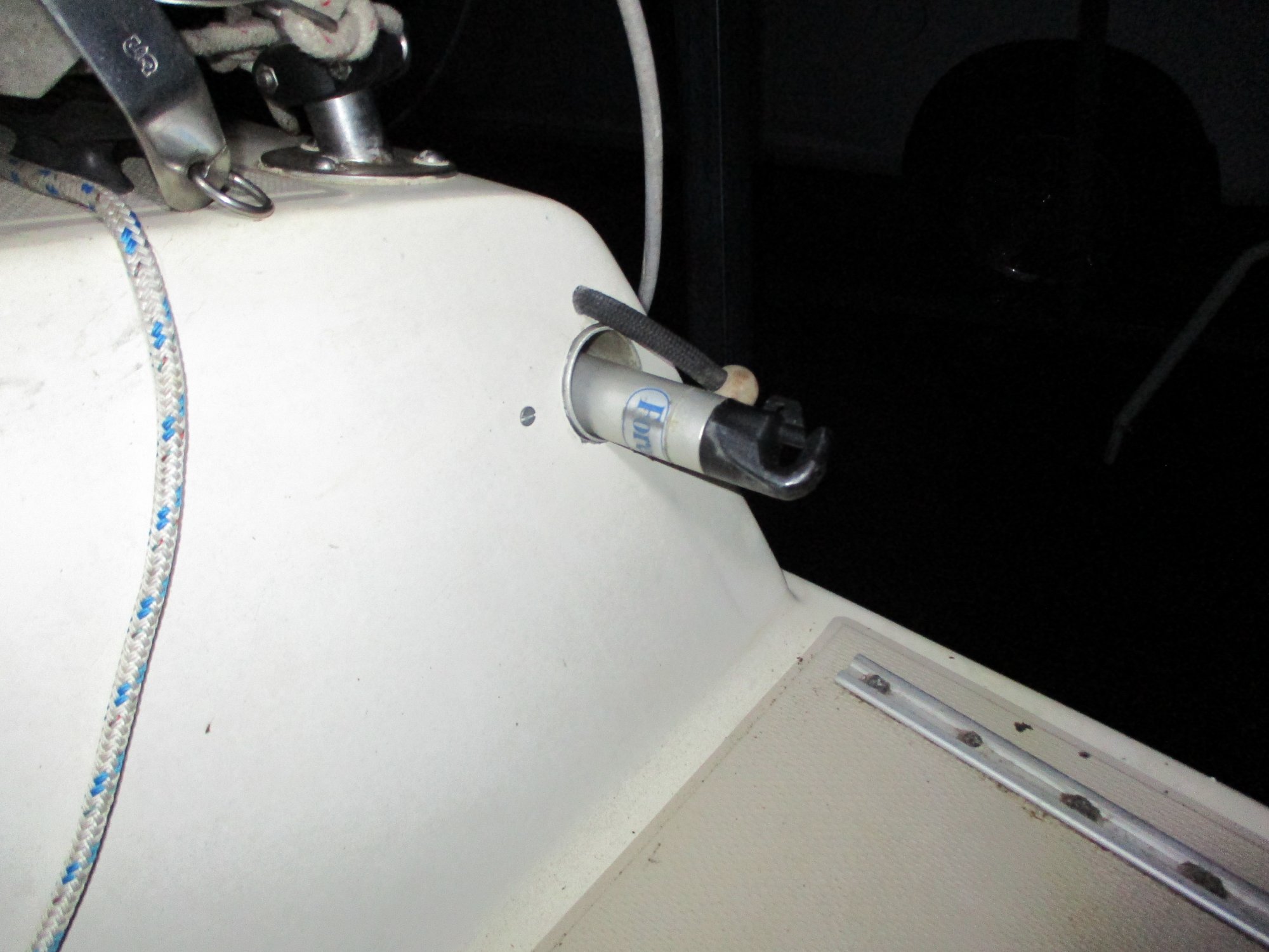

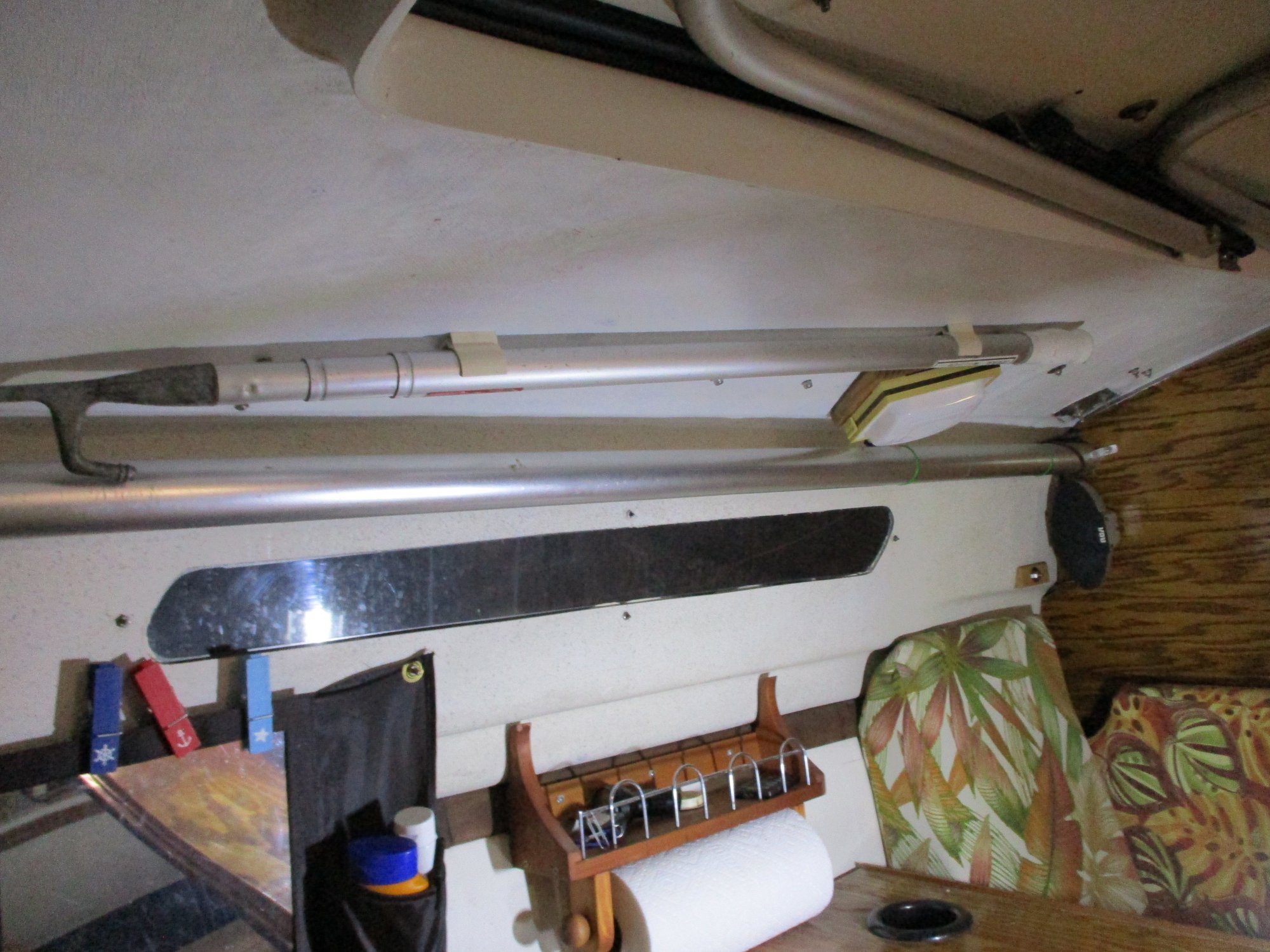

On my previous boat I installed a 2.5" aluminum tube in the cabin to stow my whisker pole. quick to access and out of the way when not in use. held in place by clipping to the black bungie cord with ball end.

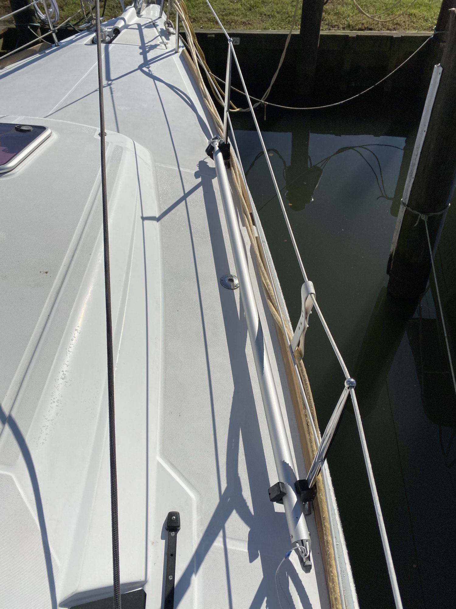

For storing my boat hook, I 4d printed a pair of keepers that holds it very nicely on the starboard sitee. The SS commercial ones I had tried always bent and did not hold well. The new one pops in an out with a very satisfying "Snap".
