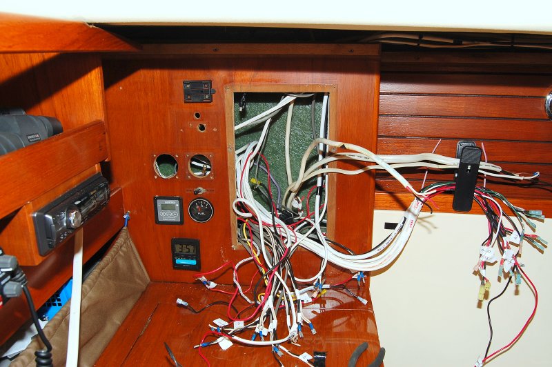

Progress is measured slowly this winter..
Before (limited access to wiring):

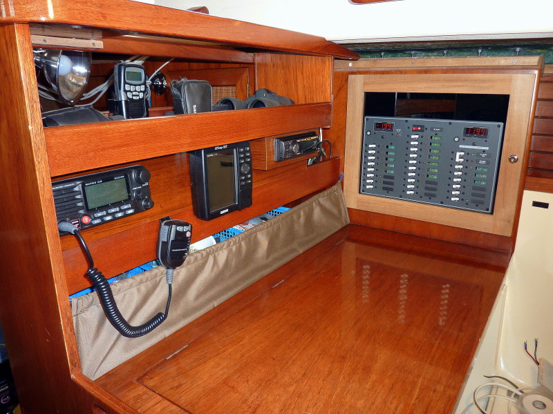

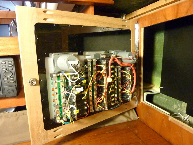

During - Fitting the new swing open panel, VHF/AIS & Stereo:
Access!!:

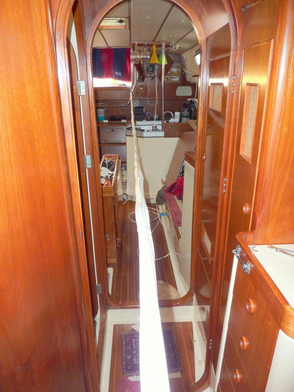

Making wire bundles, this one for the stbd side:
Still chasing & snaking wire. The connections and neatly laying everything out will take the most time. I also still need to re-build the battery compartment and LOTS of other stuff. When done only three short sections of wire for three overhead lights will be left, everything else electrical will be replaced...

Looks good Maine. Now I feel undone, I have been most reluctant to go down to the "free willy" because of 50 degree weather and a cool breeze. You mean to tell me you are doing this work with the boat outside on the hard? Gotta love your ambition Say, why did you replace that totally awesome panel? It looks like it was totally cusom and done very well. Wanna sell it? Patrick

Nice job Maine....why did you use Lexan to mount the panel instead of just wood? Can you see through the section at the top looking at a bunch of wire harnesses? The idea for a hinged panel is a great one, you should patent it. I've never seen one like it before.
When you get all done with this boat are you going to sell it? Make sure you offer it to those on this forum first.
Without a project you would likely go nuts, so sell this one and start another. It must be in pretty new condition once the wire job is done?
I used polycarbonate to match the look of the galley as it used sliding black acrylic doors. The polycarbonate I used is gloss black and is non-transparent though it looks like it is. That area above the panel will have a digital volt meter, battery monitor, propane monitor and a fuel gauge so there won't be much real estate left any way..
