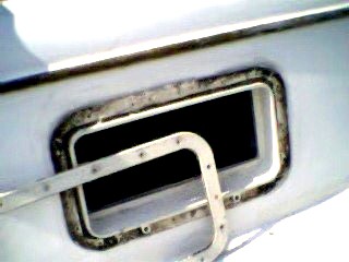

Hello Debra, ye still be about I see. When I replaced my portlights I used LifeCaulk but my portlights are bronze. Were the perimeters of the holes solid? It is hard to caulk properly if the area around the spigots is not firm. Here is a chart that I always resort to:
