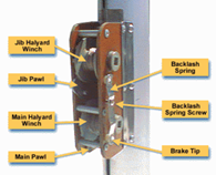

Is your intension to hoist the mainsail from the cockpit and how do plan to avoid getting the mainsail stuck in the mast track? Have you consdered bypassing the mast winch, shown in the photo below, and installing a turing block to route the main halyard aft to winch in the cockpit then to a clutch or cleat? I sure you have this rigging instruction: Flying Scot Sailboats and this YouTube video Flying Scot Sailboat Rigging Video Part 3 - YouTube.

Sorry for not replying sooner....yes, that was my intention: to rig a turning block so I could lead the halyard aft to a winch/cleat. Good point on the mainsail getting hung up in the mast track. I do have all of the rigging instructions. Was hoping someone has done this and can tell me what I should be on the lookout for or if it was even worth doing.
