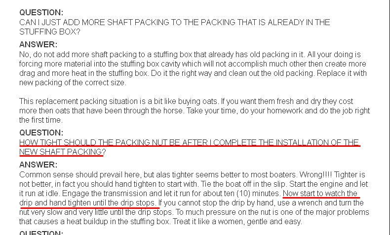

Not that unusual if you know what you're after. You must have a shaft with a mirror polish under the packing.
I caught on to this a few years after I purchased my boat new in 1998. After doing some research on packing I came across this :
This is an ad from Western Pacific, the people that manufactured your teflon impregnated flax. I repacked the gland according to their instructions which really were nothing new but I was now satisfied it was done correctly. I followed their break in procedure and this is what I got :
I still do not allow my gland to leak and have a dry bilge. The gland face shows some moisture while under way but evaporates faster than it leaks.
I always get a chuckle out of the nay sayers who always retort, "But they always said it has to leak". Yes, before teflon impregnated flax came on the scene it did. Luddites and their moldy wet bilges :yikes:. They can have it.
I would suggest you follow their break in procedure even if it means repacking the gland. I have no idea what happens to the packing if it is overly tightened from the get go. And when loosening or tightening when you're in the ZONE, I would recommend only turning 1/2 of a flat on the nut at any time.
