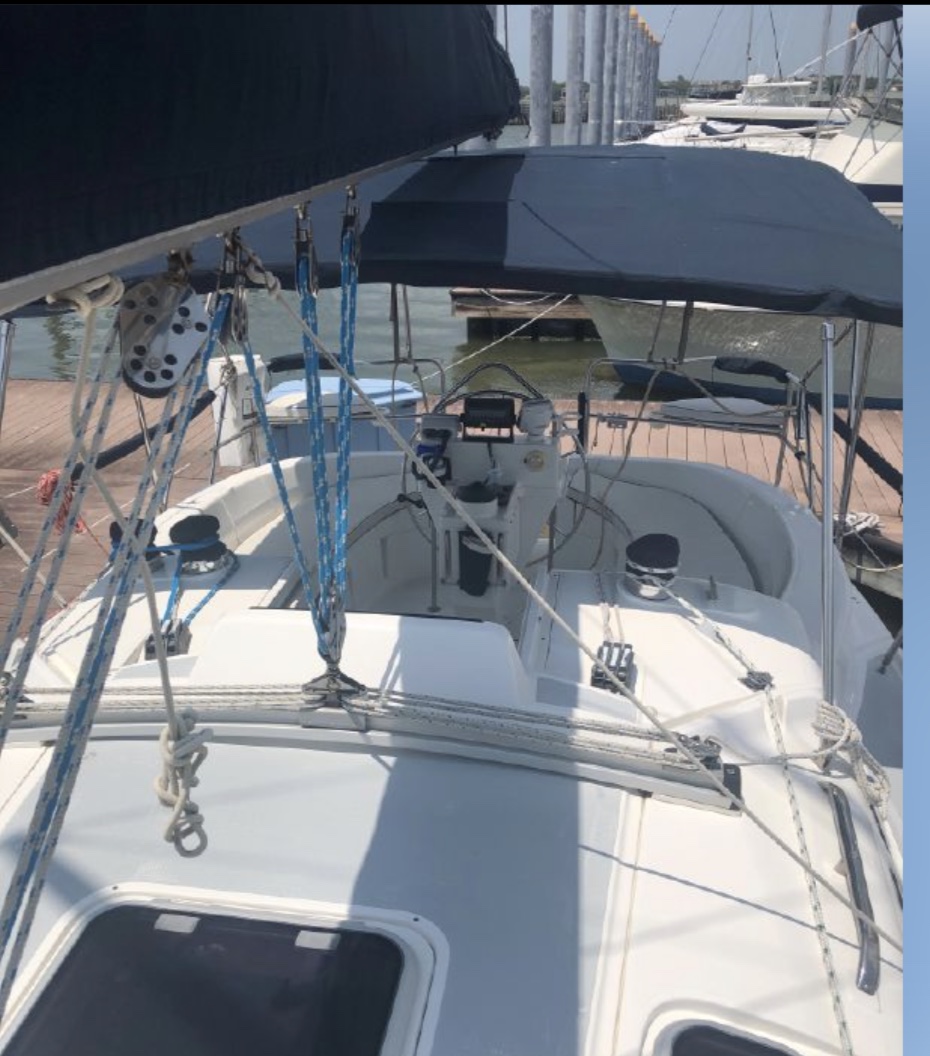

Here is a picture of a 1995 Hunter 336.
The rigging shows 3 blocks attached to the boom, with the mainsheet running down to the deck and back to the cockpit. Control for the mainsail in this image would be the traveler. You will find the adjustment is different than the way you have sailed your rig. If you have a dodger then you have some more modifications to make.
