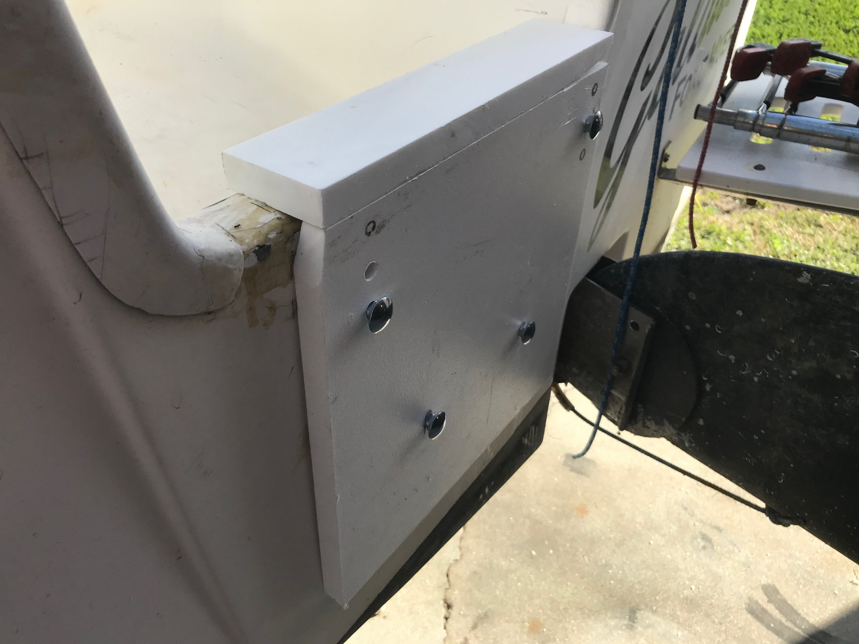

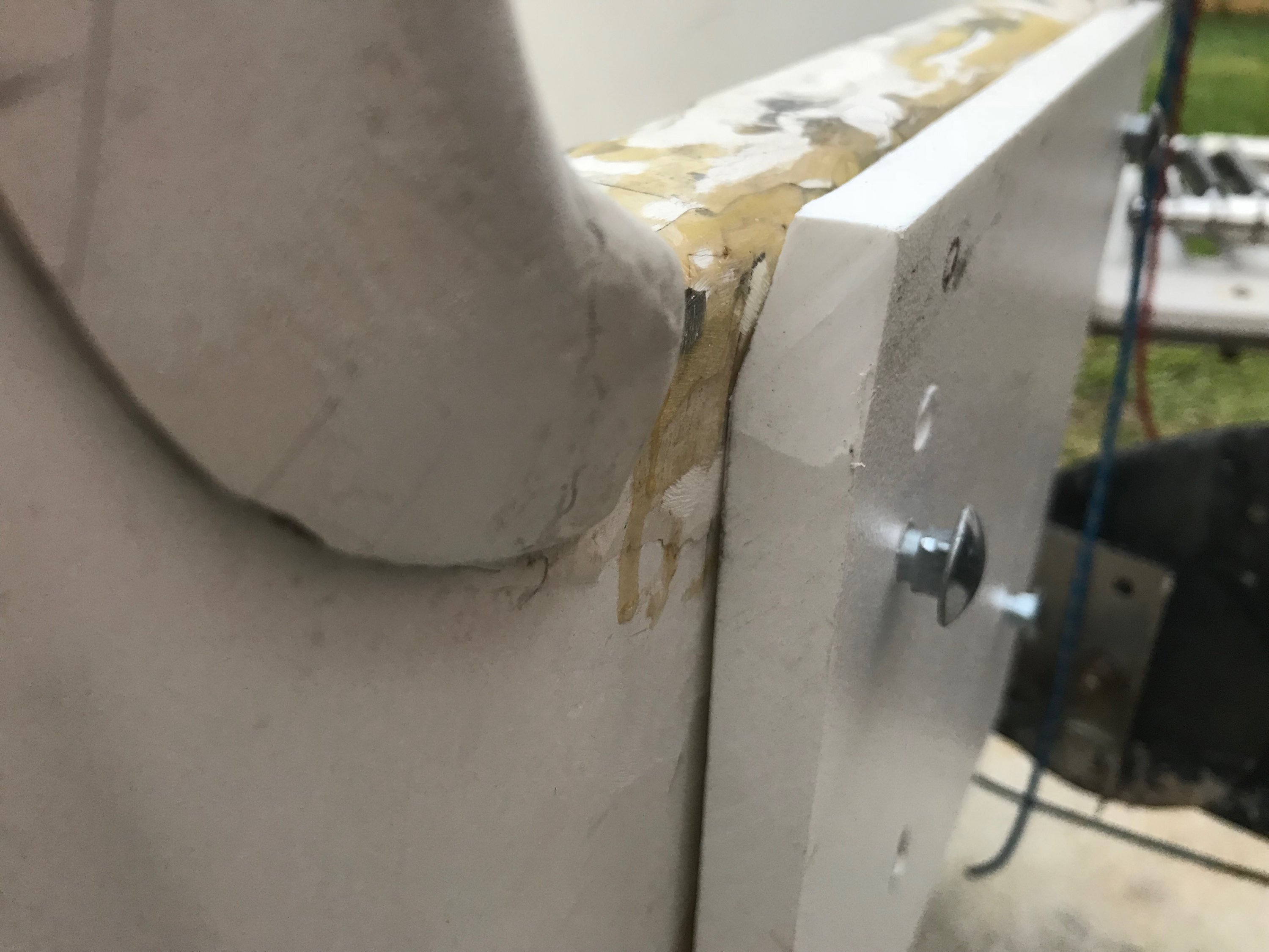

I have recently replaced the original '90 9.9 Merc 2-stroke on my 26S with a 9.9 Honda extra long shaft (25") electric start 4-stroke. I quickly realized this was not going to be a quick unclamp the old and clamp on the new situation. Mounted directly to the transom the Honda would not steer anything close to lock-to-lock and more critically, it would not tilt up to the top position thus keeping the lower unit from being able to come up clear of the water. I would like to thank Dan D for a thread he started 10 years back and Bob 04 H260 for supplying the answer to this situation. Dan D tried a spring-loaded motor mount, which I was considering. This proved unworkable because the engine ended up way too far aft to be practical. I benefited from Dan D's attempt and did not waste time and money on a mount. Bob 04 H260 solved the problem by putting a piece of 1/2" Starboard on the aft side of the transom to move the motor back a bit. (note that the top edge, forward side of the Starboard needs to be beveled a bit to accommodate the thicker edge of the transom) I modified this approach a bit by also putting a piece of 1/2 starboard on the top edge of the transom to move the motor up a bit as well. With this relatively small amount of position adjustment, I got lock-to-lock steering. Well, once everything was bolted up the tang under the tiller caught just a bit. A slight groove in the fiberglass or a bit cut off the corner of the tang would solve the problem. I chose to cut a corner off the tang. Also, Bob's solution of modifying the up stops of the tiller by cutting them back a bit, thus enabling the tiller to fold back almost to the engine cover instead of straight up as it does stock, combined with the modified mounting position, enabled the motor to tilt up all the way. I'm most grateful to have been provided this information to solve the problem. Forums rock! What I have to offer in addition is that moving the motor up as I did put the stock clamps very close to the top edge of the transom. I didn't like the long term potential for damage to the edge of the transom, so I opted to utilize the bolt holes in the engine mount for more support. The top two are 3/8" x 4" stainless hex bolts that go through to a 1/4" stainless backing plate. (using bottom hole of three on the port side of mount, middle hole of three on starboard) I had to cut out sections of the backing plate for the clamps as they do not open up far enough to accommodate the additional 1/4" of the backing plate. For the bottom two bolts I used 3/8" x 5" stainless carriage bolts. The squared section just under the head of the carriage bolt engages the sides of the bolt slot in the mount thus trapping the bolt from turning. I used a Starboard backing plate on the forward side of the transom for these. (Thus longer bolts. 4 1/4 or 4 1/2 would have worked but 5" were available to me.) The lower bolts are probably overkill as far as supporting the motor, but being carriage bolts with the nuts below the motor well and accessible only through the lazarette, which is normally full of stuff and locked, they make for a formidable anti-theft system. One would have to cut the lock on the laz and unload it to get to the nuts, or grind off the carriage bolt heads making a lot of noise and sparks in the process. I'm thinking that the prospect of attracting that kind attention would send a would be thief in search of a different target. Anyway, the Honda has many advantages over the old 2-stroke and there may be others here who would like to re-engine. The information here is really valuable so I'm doing a 10-year "bump" to make sure it is readily find-able. I plan to put up a photo album of all of this on FaceBook and will post a link here if that is possible. Thanks again Dan and Bob!

An additional note: If you drill through your transom to use the engine mount's bolt holes, be sure to follow the procedure outlined in the Gougeon Bros. book and the free How-To brochures from West System epoxy: Drill the holes and fit everything up. Then drill the holes out oversize. Tape up one end (Tyvek tape works great for this) and fill the hole with epoxy. In this case, since the transom is vertical, use thickened epoxy so it doesn't drain out. Then after curing, re-drill the holes to size. This way you will end up with an epoxy bushing in the hole sealing it to prevent any water intrusion from getting into the core wood of the transom and rotting it. Btw, you should also do this for any hole you put through a cored deck.

Also, Sumner made up a mount to move his motor back and up (quite a bit up - 4" I think) that you might want to take a look at. But not all of us have Sum's aluminum welding capability. (It's awesome though!)

Almost forgot: If you drill holes through the transom, watch out for the motor well drain hose. The lower port hole will be very close to it.

+1 on making epoxy bushings to protect the Transom core. I used the same theft deterrent to protect my motor. I did see staining from water through the bolt holes when I was in the laz looking for water leaks. I can only guess that the water comes in when a wakes strikes the transom since the bolts are way above the water line.
I have not yet come up with a way to stop this leak.
My first thought is to chamfer the transom bolt holes then seal the bolts in the holes with Mainsail’s butyl tape.
