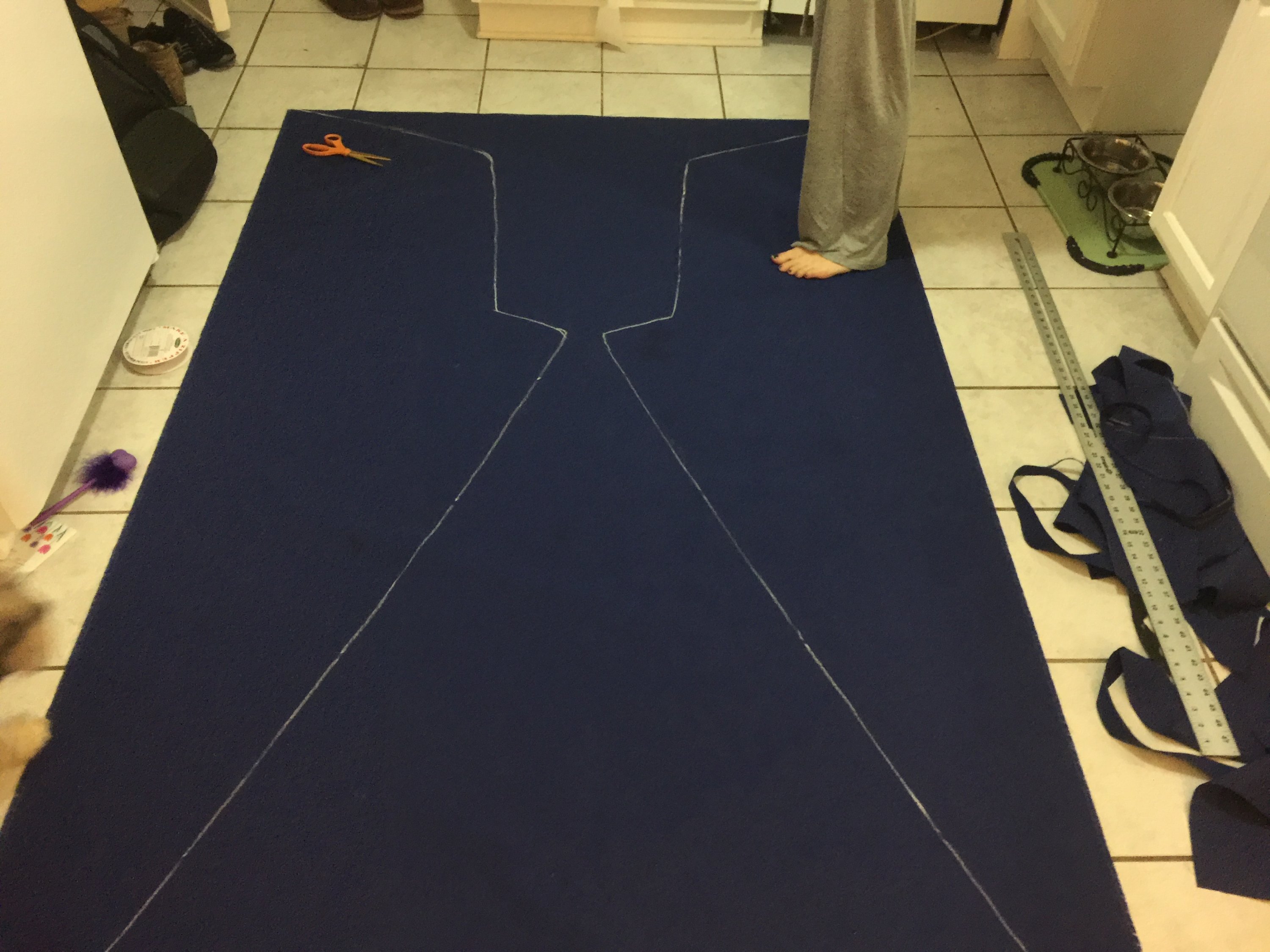

Hey guys!

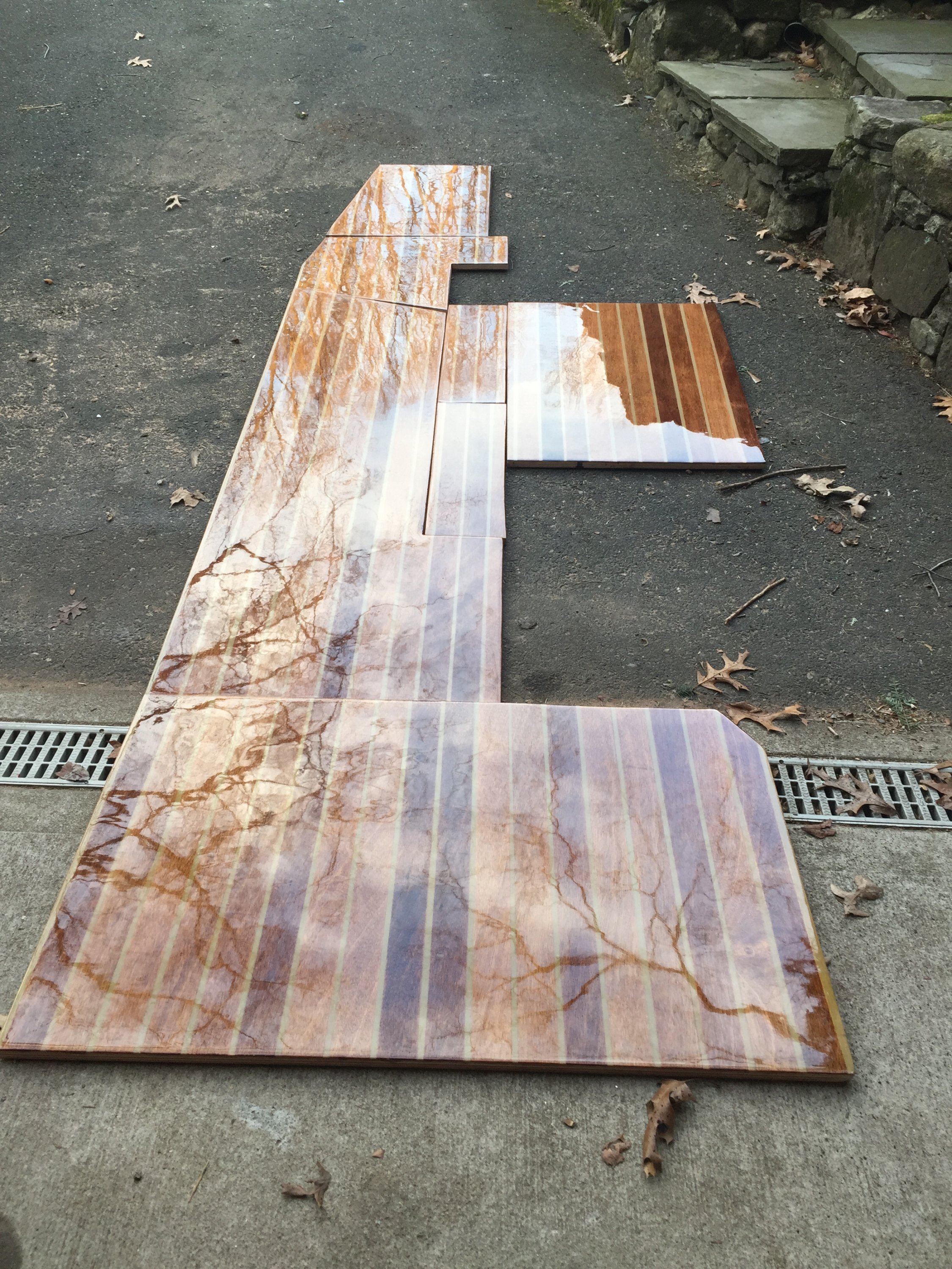

So last week I posted a picture of the floor I did. here is a a pic for those of you who missed it.

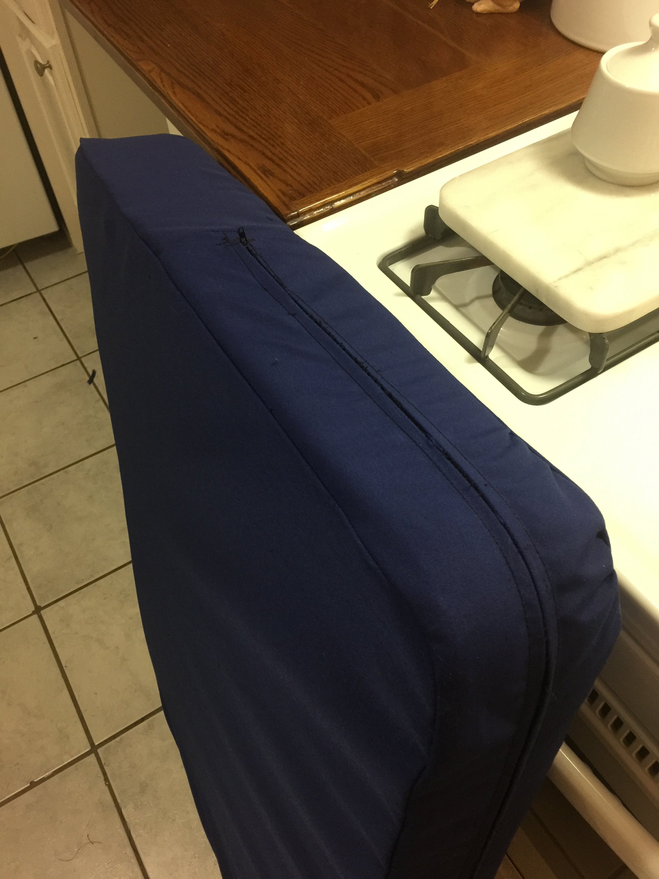

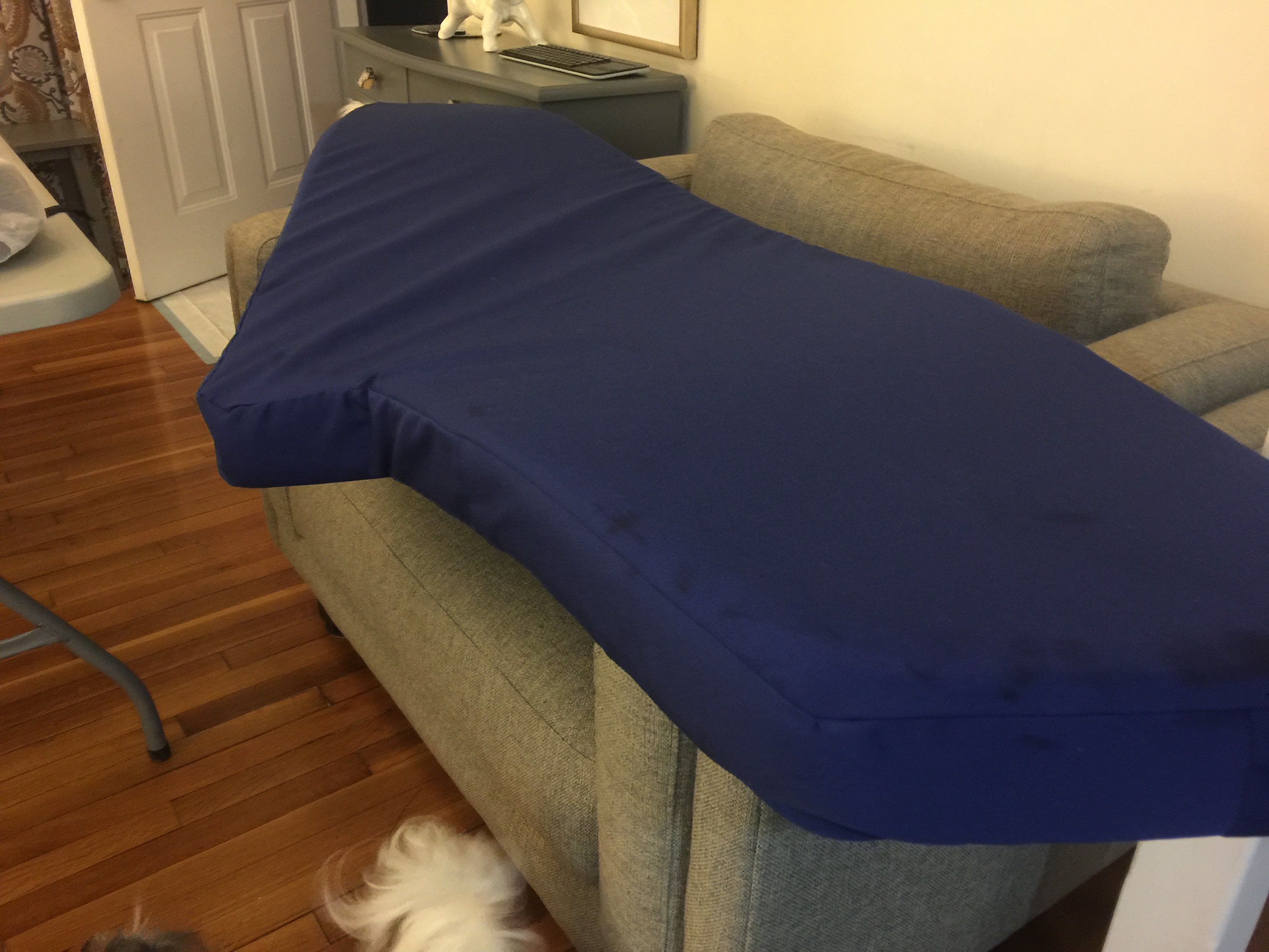

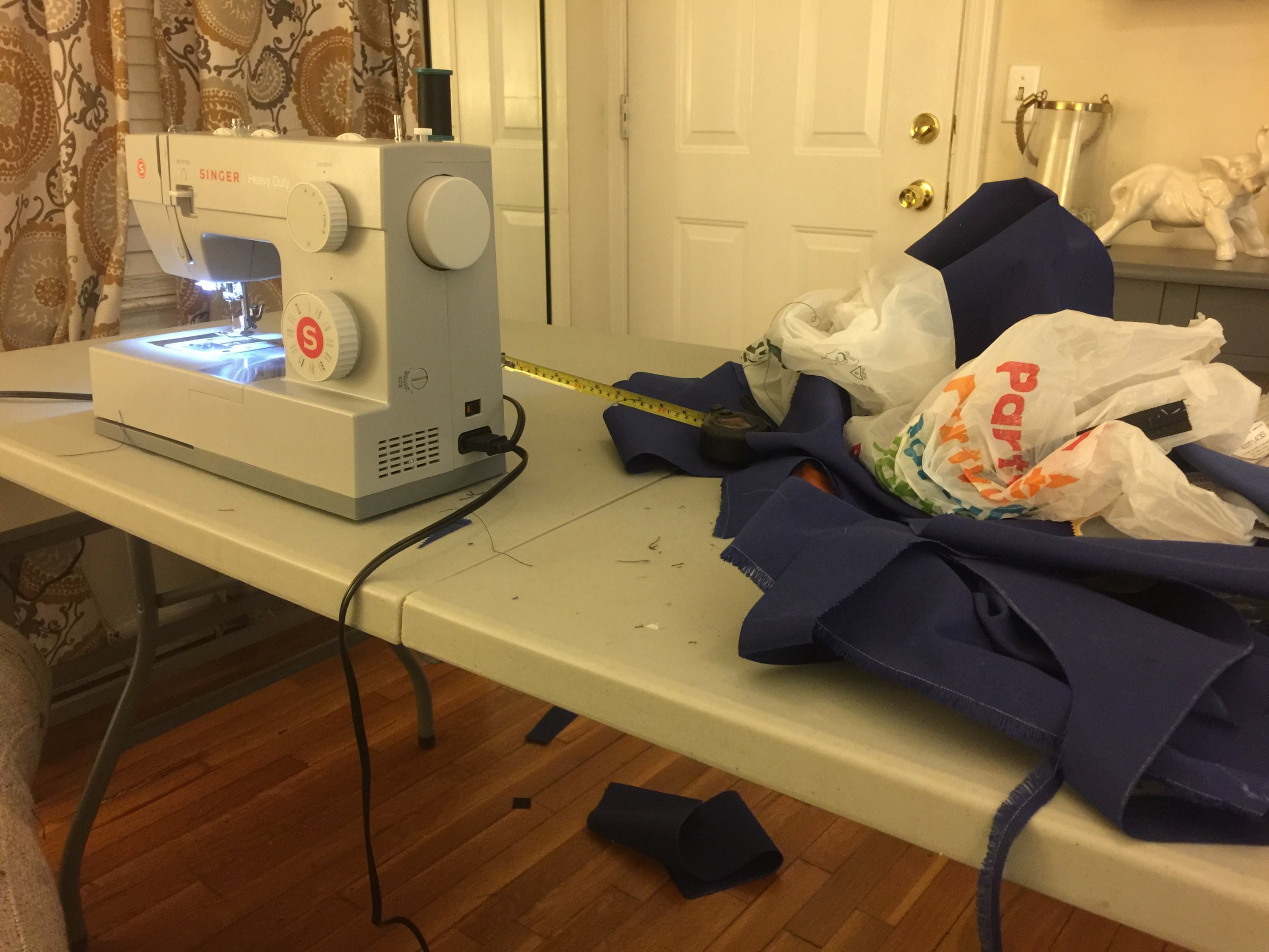

This week I am tackling a new project. All of the cushions were original and very worn out. I am re making all of them by myself. I am using a very economical singer sewing machine and fabric exterior fabric that I ordered from fabric.com. The total cost to re do all of my cushions for the C&C 32 will be about $300. So far they are coming out professional. I am also reusing my old foam. After soaking it in blesh water and then drying for two weeks, the foam smells and feels like new. I will post more pictures when all is done.

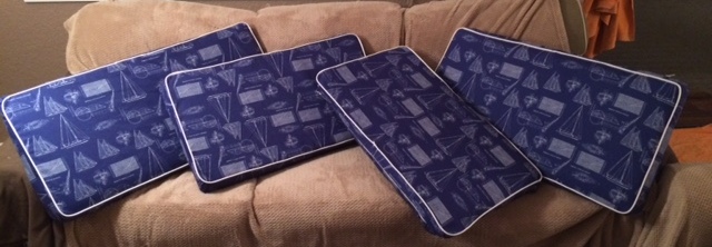

I'm in the process of reupholstering all my cushions too. Found a nice outdoor upholstery fabric at the fabric store for cheap. I did find that my wife's cheap sewing machine wasn't up to the task, so I found a nice Pfaff walking foot machine on Craigslist for cheap and it's plowing through the job beautifully. As a side benefit of being able to do heavy work, I've made a BBQ cover, an outboard cover, and I'll be taking on a sail cover soon.

Three questions, what is blesh water, what did you use on those great looking floorboards and how did you learn about sewing skills?

Nice job, and the piping looks great. I have given some thought about doing mine. What is a walking foot machine?
Mar 11, 2016
6
C&C C&C 32 Stamford, CT
No need for expensive machine or walking foot. I got a machine for $130 and $250 worth of fabric and I am making about 20 cushions that go all around my 32' boat. Its time consuming. I can make one cushion in about 3-4 hours.

2.For the floorboards I use high grade marine plywood and then stained the different shades on it. After doing some sample coating I noticed that the light, thin stripes blend in when coated with polyurethane so I actually taped them off and used spray paint to highlight them. After the staining and light highlighted stripes were done I used two part epoxy from home depot, mixed and poured a thick coat on the wood. Let it dry for 24 hours, sanded with 220 and then used marine poly with UV protection to top it off. I did 3 coats of that. Then I let it dry for a week before installing. Pictures coming soon.

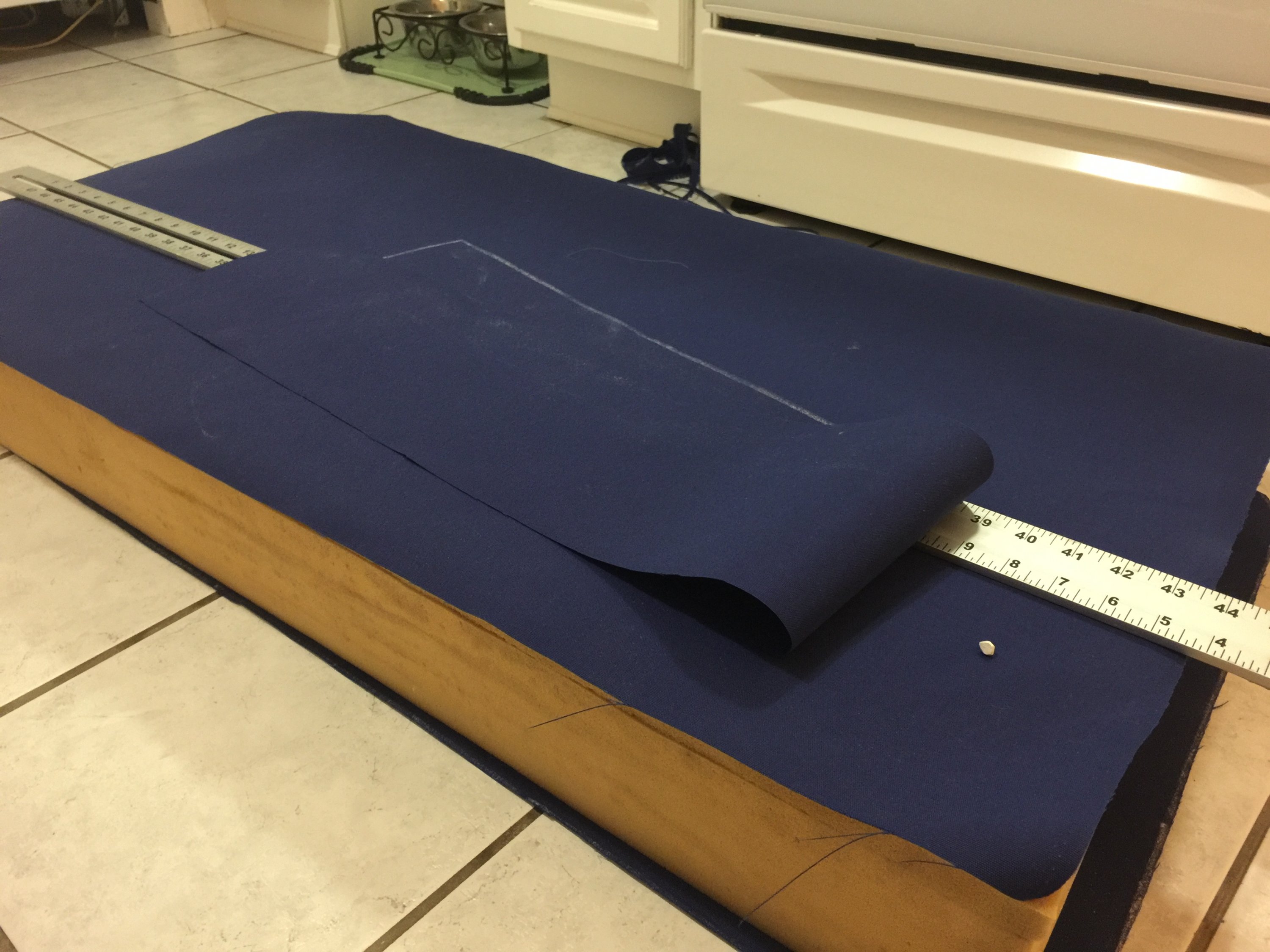

3. Youtube and $130 sewing machine (Singer HD4411). Learning curve is not steep. First cushion looks like shit. Second one is a little rough around the edges and zipper. Third looks awesome. All other ones look professional. Then of course you can go back and redo cushions one and two. The key to making nice fitting cushions is to trace the foam perfect with half inch overhang, then saw exactly with half inch seam allowance. Sewing is the easy part. Also seam ripper is your friend.

Two cases where a walking foot machine makes a big difference:
1. Thick stacks of fabric, like multiple layers of canvas, sail Dacron, leather etc. Without the walking foot, things get bunched up at the top as the machine pulls it along from the bottom
2. Sewing dissimilar fabrics together. In the case of my cushions, I'm using a sunbrella type fabric for the tops and sides, and a waterproof nylon on the bottom. The nylon is much slipperier and has different stretch characteristics than the other fabric. The two fabrics feed unevenly without the walking foot.
Yes, these can be done without a walking foot machine if more care is taken and you aren't super concerned with the appearance of the stitching. But I found a great Pfaff walking foot machine on Craigslist for $120, works great!
