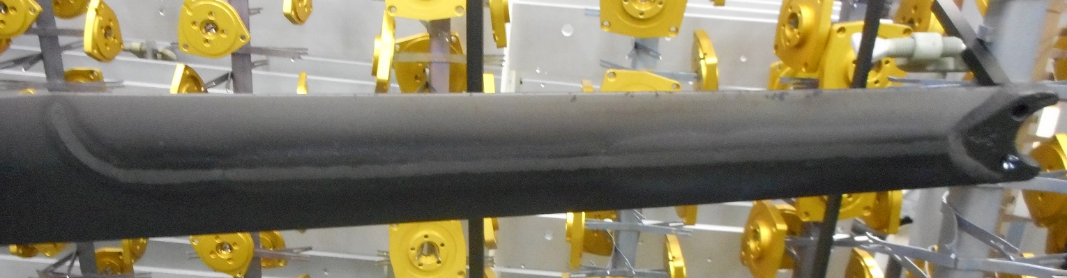

UPDATE: The anodizing guys have said that brazing rods will be fine but will most likely come out a different colour ranging for grey to black. They recommend that anodizing will be most successful with 5356 rods such as by lincoln electric - which need argon gas for best results. The advice also is that brazing the aluminium will however change the molecular arrangement of the aluminum locally and so unfortuanly there will most likely be a dis-colouration 'spot' of bloom in the anodizing no matter how perfect a repair job of filling the hole is made. The best and no doubt easiest option is to fill the holes with rivets once all anodizing is done (as suggested here). Thanks for the observations!

Thought Id show a photo sent to me from the Anodizers to show the kind of discolouration from a welding repair due to heat and different welding material (taken from another project). Good to have expectations managed.that re-anodizing will not restore it back to 'as new' condition.
