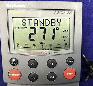

Can you send me a picture of the AP Control panel? This the display with Stdby , Auto. and course control.
They made a change in how you get to the Dealer mode, depending on which Panel you have.
The version number for the Controller should display too. That would be helpful.

The control panel was working fine before we rebuilt the motor. Here is a picture of the control panel not the one on the boat but the same.
It is the Button Locations and Layout that determines the method to get to the DEALER set up.
