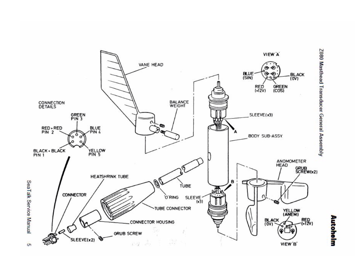

Hi Friends,
Im about to climb my mast to remove and clean my wind vane, please see attached photo. The question I hope you guys can help with is... Having undone the large " Tube Connector " that I assume is a large/long threaded plastic nut, does the whole arm just un plug from the main mast fitting? Thanks in advance.

I have a new unit in the box here and according to the instructions and looking at it, yes it should easily disconnect to remove it from the base mounted to your masthead. Of course there is no telling what a po may done to it till you get there.
Good luck, should not be a problem.
The answer is yes. I just had mine off a month ago--cleaned, lubed, and reinstalled it. Also replaced the cup and vane. Be careful not to bend the pins.:yikes:

[QUOTE="Kings Gambit, post: Be careful not to bend the pins.:yikes:[/QUOTE]
Kings Gambit is correct. To clarify that point, do not twist the wind vane main arm as you are removing it. Pull it straight out after loosening the tube connector.

Yes, it just pulls out of the socket after loosening the large knurled collar. I just rebuilt three of these transducers- my original, my spare, and also a friends transducer with new bearings and o-ring seals. They now spin like new! I will post a picture essay on how to do this within a day or so.
