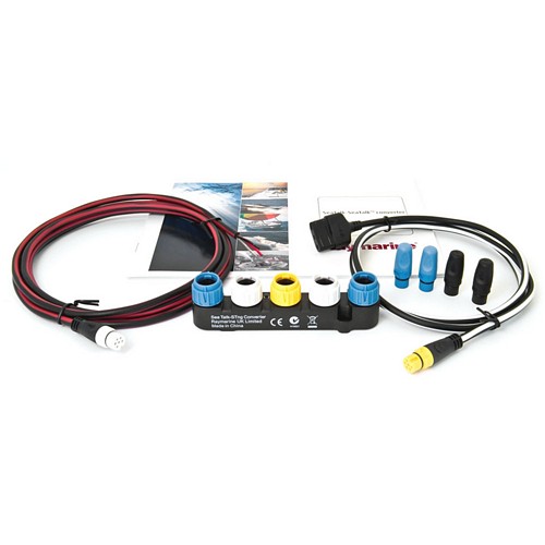

The ST60 gear is decent kit. While it is old-school Seatalk-1 networking, that can easily be fixed with a very cost effective (99 bucks) Raymarine Seatalk-1 to Seatalk-ng converter kit. This bi-bidirectionally translates seatalk-1 and seatalk-ng sentences between the two networks, allowing you to share the instrument data with other devices. Seatalk-ng is basically NMEA2000, so you can create a mixed manufacture setup using someone elses plotter and AP if you want.
The only real downside it the single-purpose, inflexable nature of the displays. Once you get used to (say) the B&T Triton2 graphical displays, its hard to go back.

By the way, I have one of those converter kits for sale, along with a ton of STNG connectors and cables.

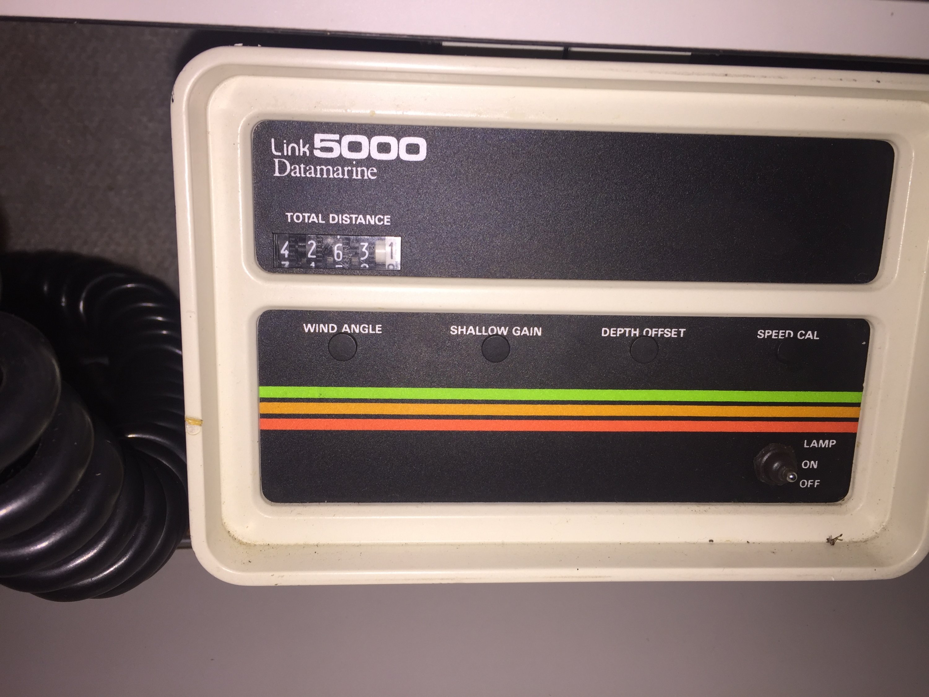

Jviss, can I use my link 5000 with the ST 60 plus package along with my auto helm ST3000
jviss
Feb 5, 2004
7,090
Tartan 3800 20 Westport, MA
Here's your answer;
The ST3000 control unit is SeaTalk compatible. It can receive and transmit information to other instruments and autopilot control units via the SeaTalk bus.
