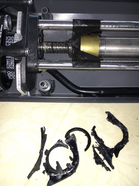

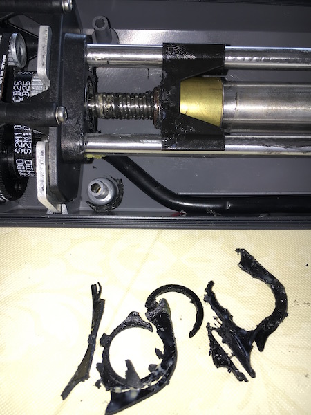

Yesterday was my 2nd sail of the season and the first of a week long vacation of long day sails. Of course, the auto tiller pilot chose to fail during this sail. It wasn't holding course well, would get a lot of chatter when the rod retracted and it seemed to have a lot of end play.
I opened it up with the hope that I could fix it but it looks like the end bearing for the screw had a retainer holding it in place. The retainer is in pieces and the excessive end play, about 1/4" or more, is the bearing moving in it's holder allowing the drive belt pulley to get out of alignment. Probably the cause for the chattering.
