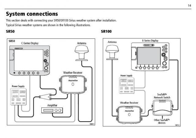

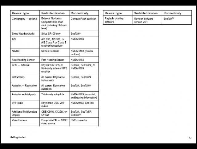

Because of conflicting information I'm not sure which one is correct for proper interface with the C90w.

I have the C-80 and have SR50,I am pretty sure the E units use the SR100.

So the C90w doc is incorrect, that is what I thought as well. I will confirm with Raymarine before I order.

C-90 wide came out after the C-80 so maybe they changed some thing with the new C-90 Wide.
