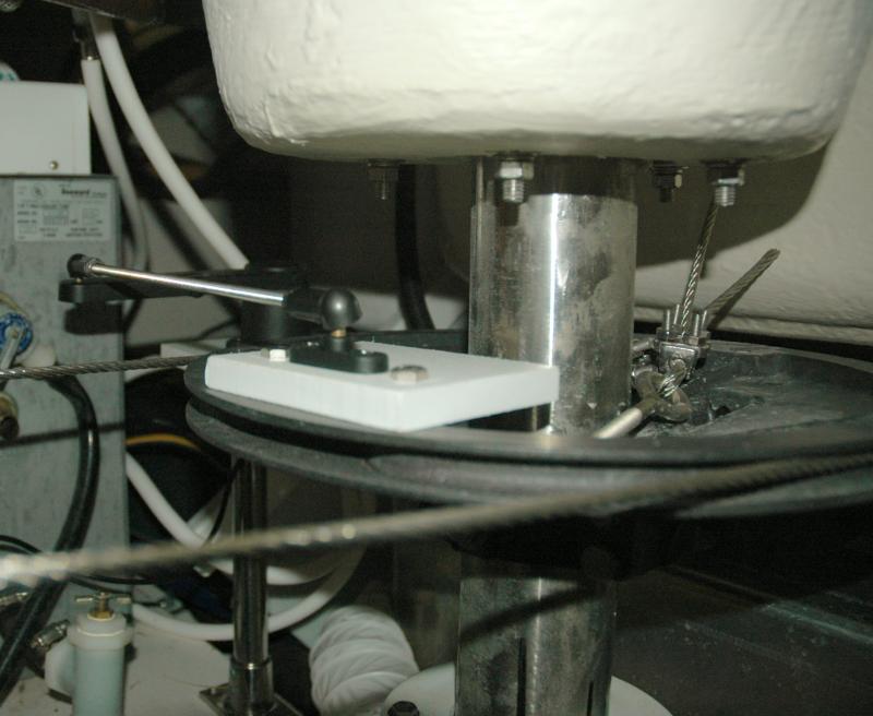

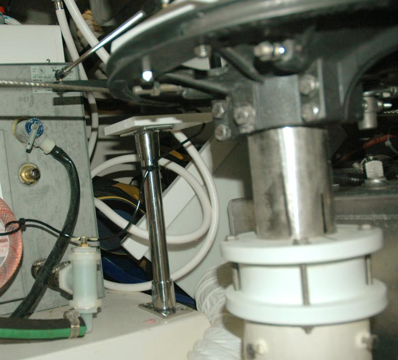

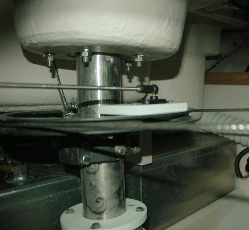

Check out this picture. PaulJ on the 310 forum designed this for his boat, shared the plans with me and it worked out great. Took me about an hour to make it and about 20 minutes to install.

Oh yeah, I forgot about the RPS.
That 310 design is pretty fancy. Mine is a lot simpler as I screwed the RPS upside down onto the bottom of the cockpit sole and then attached the ball joint to the Quadrant using some Bronze screws and starboard.

I also installed an RPS on a Catalina 310 and it went very, very easy. Many ways to skin the cat. Even with an X5 I would still want an RPS..
